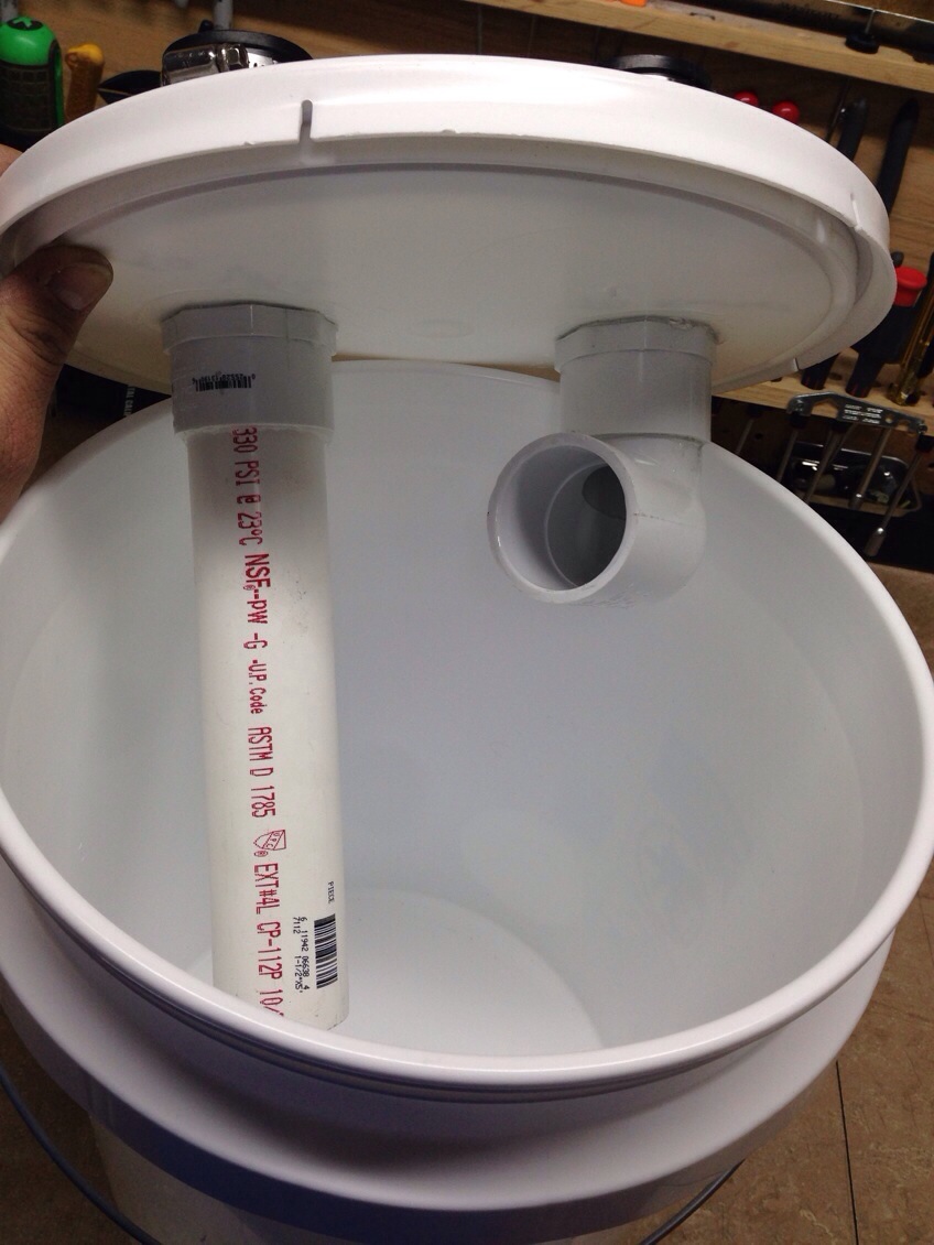

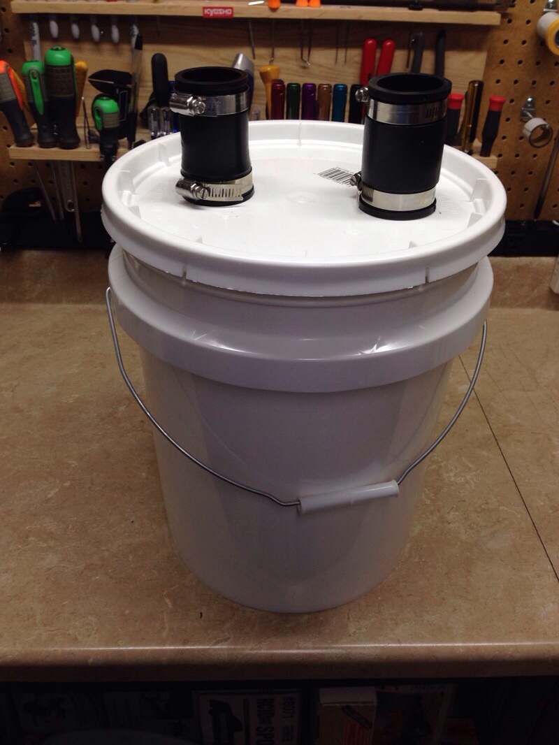

Minor update here too, wish Reggie had chimed in earlier cause this water filtration setup was a simple to build except for my vacuum hose being a non standard size. Other than that, I just need to wait for the glue to dry, add a couple inches of water and hook er up
The dust comes in at a high velocity and hits the water, trapping it. Should make my filter last a whole lot longer!

Looks like the beginnings of one mighty large bong.

Phin wrote:Looks like the beginnings of one mighty large bong.
:lol:
The tutorial actually mentions that
NOTE: Don't fill the water above the pipe, this is not a "dust bong". If the water is filled above the downpipe, the resulting vacuum may collapse the bucket. You simply want the water to act as trap, by catching the high speed dust as it tries to escape from the bottom of the bucket.

Did you get your dust-trap to work as expected?

Even better than expected- it froze a couple weeks ago so cleanup was super easy! Lol!
It seems to do a good job, no pressure loss and the filter on the vac stays cleaner.
