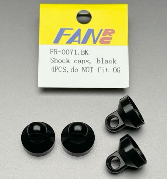

Anyone know if FanRC shock caps will fit the smaller diameter AE RC10 shock bodies (pre-12mm shocks)?

R6cowboy wrote: Mon Nov 11, 2024 8:10 pm Anyone know if FanRC shock caps will fit the smaller diameter AE RC10 shock bodies (pre-12mm shocks)?
It's my understanding that the Fan caps are not compatible with AE bodies.

yep thats correct, he went with a different threading.
Screenshot 2024-11-11 at 19-42-25 Fan RC Shock Caps - Does Not fit OG Shocks – Go Fast Hobbies.png

Thanks, I wanted to make sure it wasn't a marketing thing to keep AE off his ass.

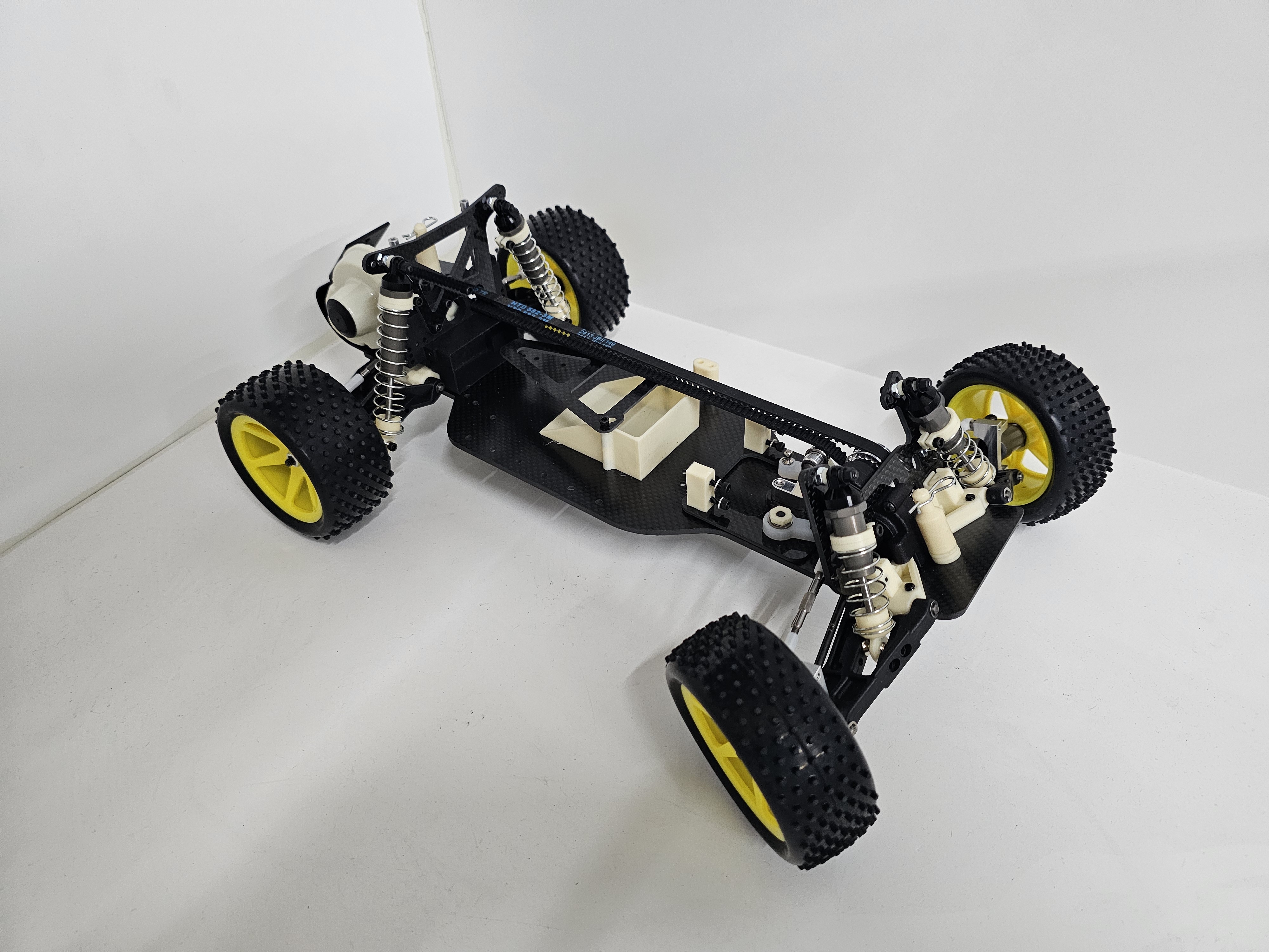

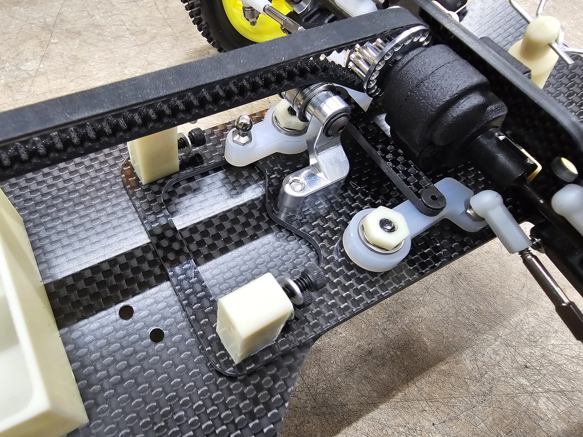

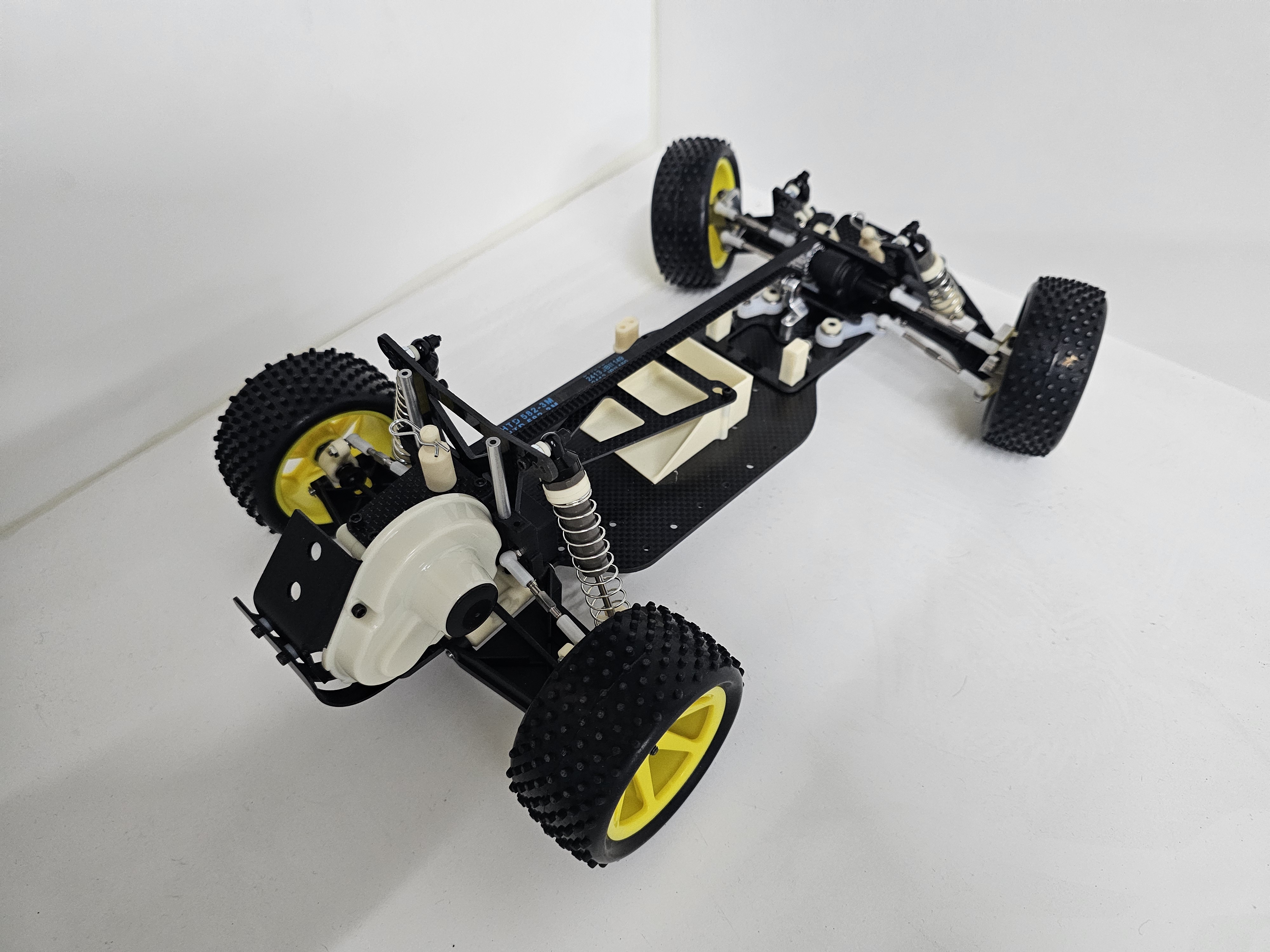

I just converted one myself, here is the way I recommend:
remove the fan gearbox, put the diff in the front (its the correct width)
source a modern rere stealth (the diff is narrower by just a tad, so you need the box and the diff) (you can use an old stealth also, but not the rere worlds or fanrc since his is a copy of that one)
you can reuse the rest of the fan gearbox (bearings, top shaft etc)
you will want the new drill template and spacer for the fanrc chassis https://factoryworks.com/shop/ols/products/frcadapter

Oh man that conversion looks sweet! That might be where my FR-01 is heading at some point. For now though for me it needs to be as much like the original as possible. It's filing a void. However, I did ask Santa for the new team car. So maybe with that and if the graphite chassis is re released I'll be ready to convert it. I literally check AE"s website just about every day hoping to see some new vintage stuff. Then I saw this new team car and at first was disappointed it wasn't the graphite but then thought about it and realized it's the perfect next car. And I got to thinking AE has got to offer parts for these things right? They know we want to race them. Or at least know people are willing to get them dirty. I would imagine they have to at some point sell the stealth tranny again. Hell you can already buy most of the parts individually. And if it's not a full kit there will be part numbers you could look up and order right? Am I crazy for thinking this? Or I guess nieve is the right word. Am I just hoping this will be true so I can restore my original rc10? Anyway, I will have to burn this in my memory so that I know where to look back and find those details when it comes time to go 4wd. Do you run yours? If it goes half as good as it looks it'll rip.
