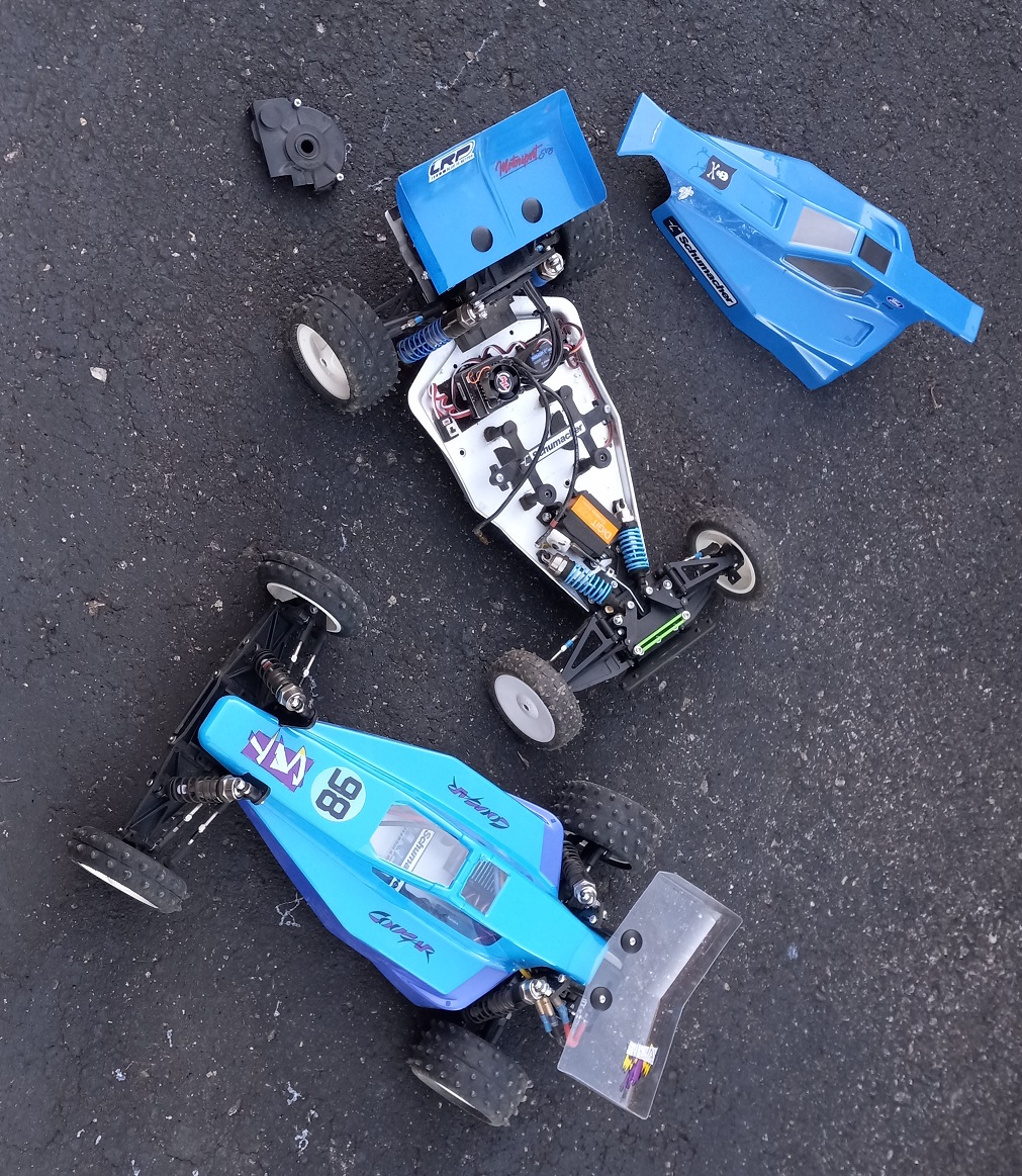

I had a long weekend, so I was able to do lots of RC stuff. First up was the Benny Hill motor swapping extravaganza. My Cougar had a 7.5 LRP and my Top Cat had a Trinity Outlaw 10.5. Both were undriveable unless EPA was set low, very low. So I pulled the 7.5 for my new LD3, swapped the 10.5 into the Cougar, and bought a HW 13.5 for the Top Cat. Now all are appropriately powered.
Next, I spent a fair bit of time checking things over, tightening screws, making adjustments, etc. All my cars are runners, so I get behind on maintenance. I finally got around to trimming the bottom of the rear hubs on my Cougars and Top Cats.

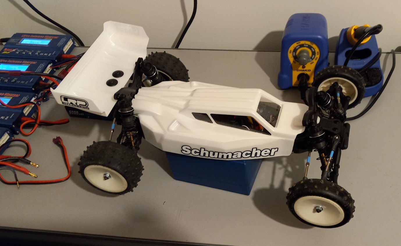

I finished building my new LD3. I painted it with my usual artistic flair.
I drove it for a minute or so. This thing has MEGA steering. No wonder those EOS "1/10 offroad" races look like 12th scale pan cars zooming around. Not my cup of tea, so I immediately went back to driving vintage stuff.

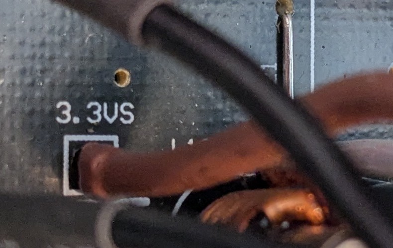

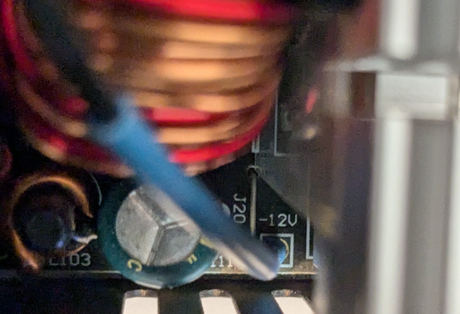

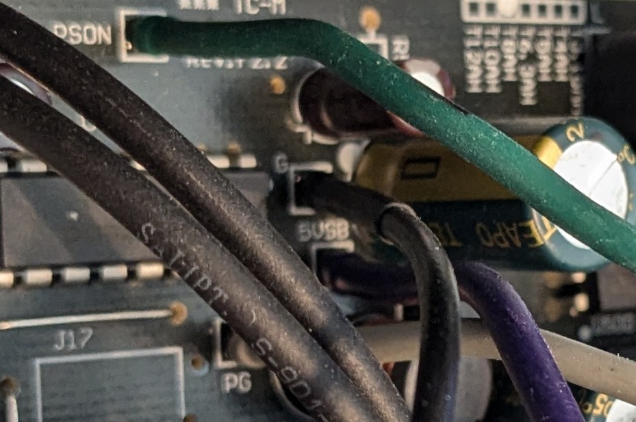

Right now I have PSON green and PG gray conneted to a bulb
and I have 3.3VS brown, 5VSB purple, and -12V blue connected together but I don't remember why
It does the voltage fluctuating that I mentioned here:
https://www.rc10talk.com/viewtopic.php?p=538388#p538388

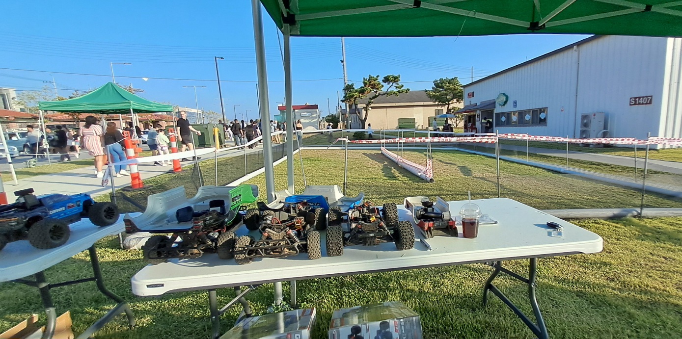

Staffed a little RC fun time 2 minutes a ticket grass oval "racing" booth for, well, 5 hours now. Still have 2-3 more hours left. Arrma Granites, Sentons, Vorteks, and some of their GROM scale stuff. All running on 50% of max.

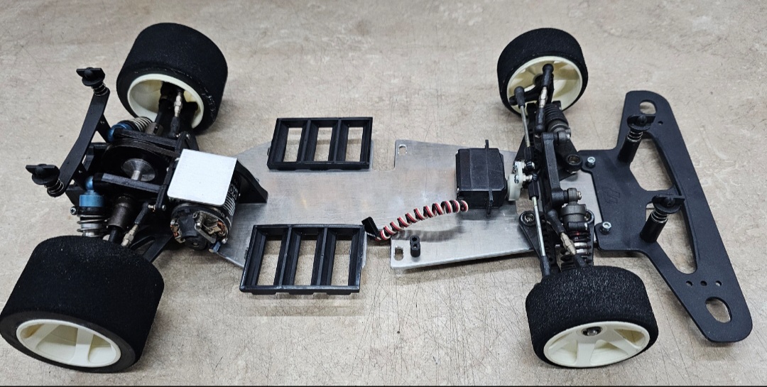

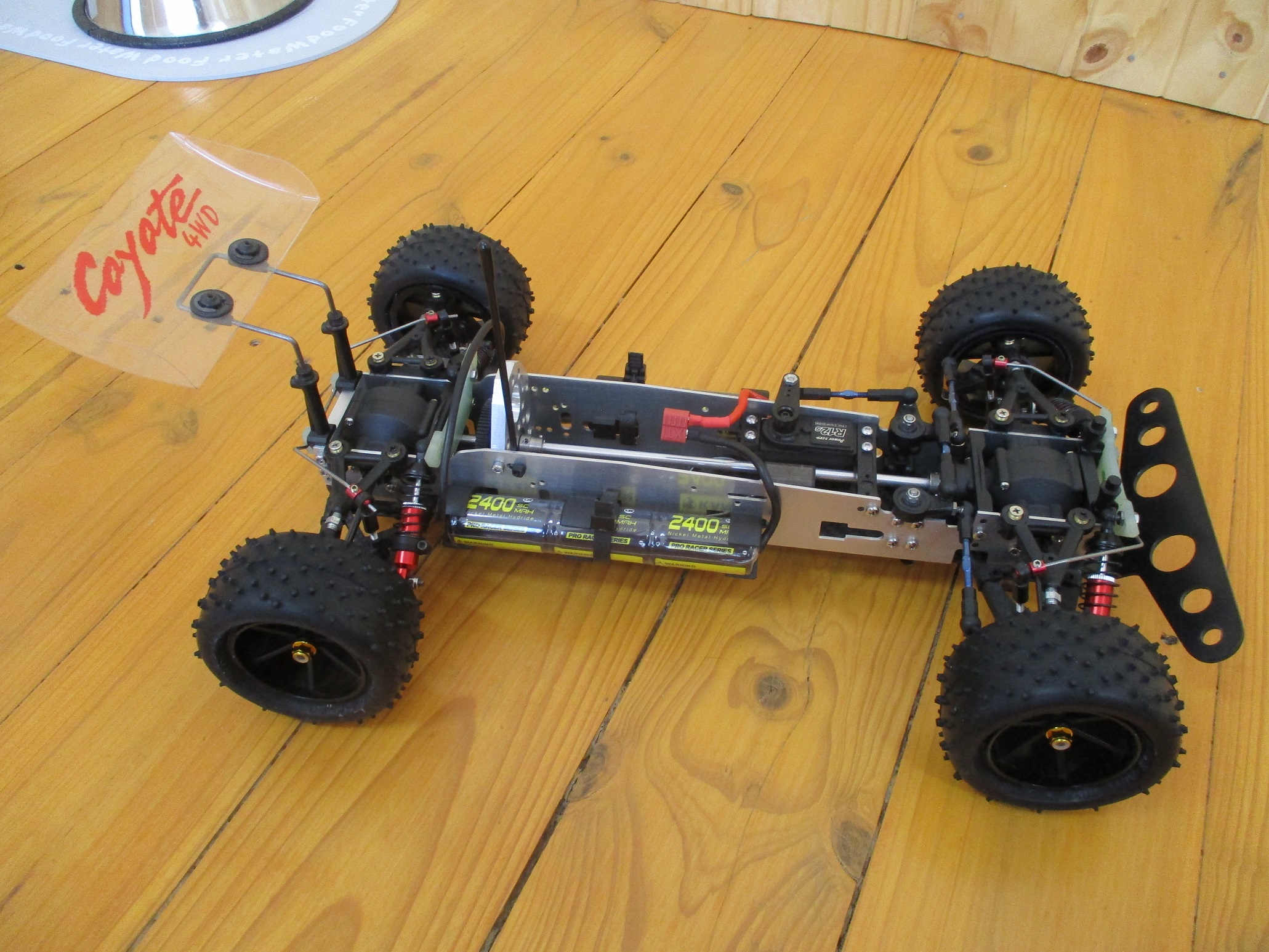

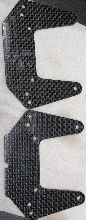

I have been battle hardening my Cougars.

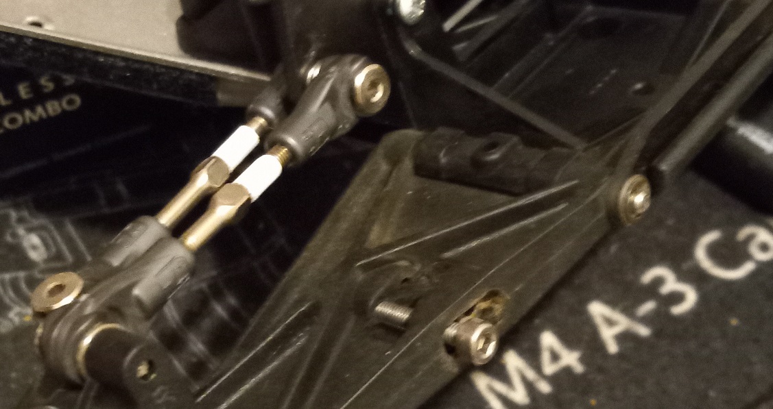

The captive ball cups cost me a bit of steering lock, so I will have to find a different solution for the inboard end of the steering links.
I bought the Schumacher carbon front towers before learning that Jeff made a better one. The newer build has Jeff's tower, but for the older one, I decided to just double them up. The groove on the front plate is not wide enough for 2, so I had to remove the bottom edge of 1.
