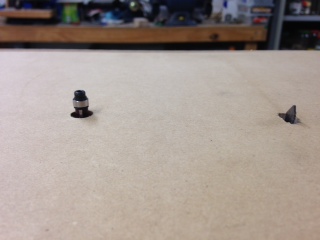

ok well over the weekend i made a cutting box for the same purpose as the pin router.. here are a few pics
i decided to go with a Tungsten Carbide trim router bit.. it is 6mm diameter so it should do reasonable internal radius cuts.. bearing is pretty close to the cutter so shouldn't need too thick a double sided tape..
secondly i have also mounted a jigsaw underneath so as i can do quick rough cuts easily.. figured i will give it a go and see how it works..

i figured that between my scroll saw and this table i should be able to do most things at this stage.. the one thing i will try is to see if a router bit will stand up to aluminium plate.. i figure if i make a arm then i might be able to copy it multiple times.. time will tell..

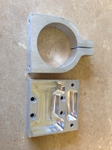

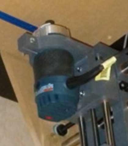

....and thus begins the next version, with a stiffer Bosch Colt clamp from a CNC mill. I'm getting really tired of using the stock base. It flexes a lot

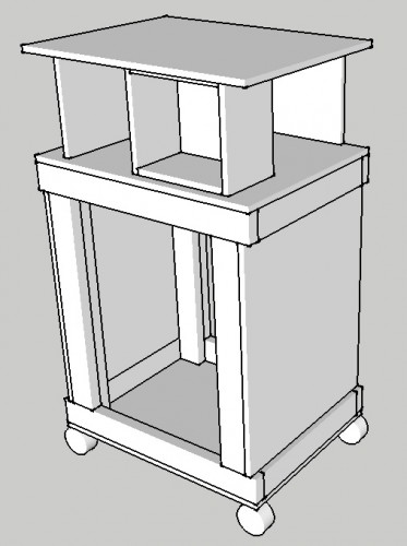

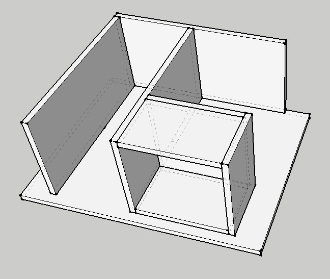

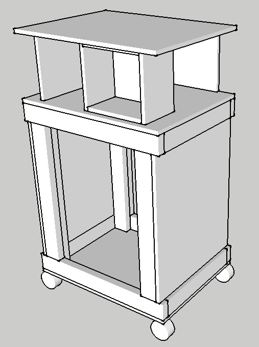

drew up a cut sheet and decided to mock it up in Sketchup first- it fits!
my goal was to reinforce the router mount area and also allow a couple storage spots for G10. With this I can fit 24x12 sheets in each storage area. Thats a lot of G10! The router box area is more forward that the old router, and the arm will be longer too. The stand looks small but will fit both my shop vac and my water filter bucket, making this a self contained unit.

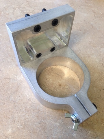

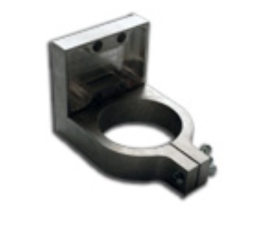

Mount arrived today, it's a work of art! They run $50 and ship fast! This should make for a very sturdy setup!

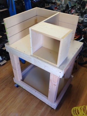

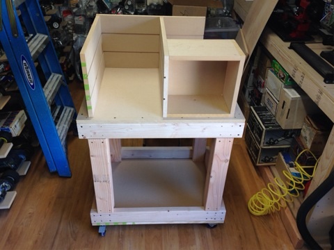

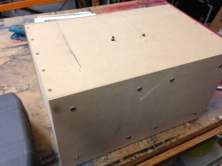

Finally getting somewhere, got the base all screwed and glued, won't put the top on until I get the router mount finalized. I decided to get fancy and buy a dado set for the shelves
Hopefully I can get the router mounted tomorrow and get the top glued on. I would like to lay down a laminate over the top, to make the material glide more smoothly and also keep from gouging the MDF
I'm glad I went with the same styling as the benches. It looks overbuilt but it was a super simple construction!
