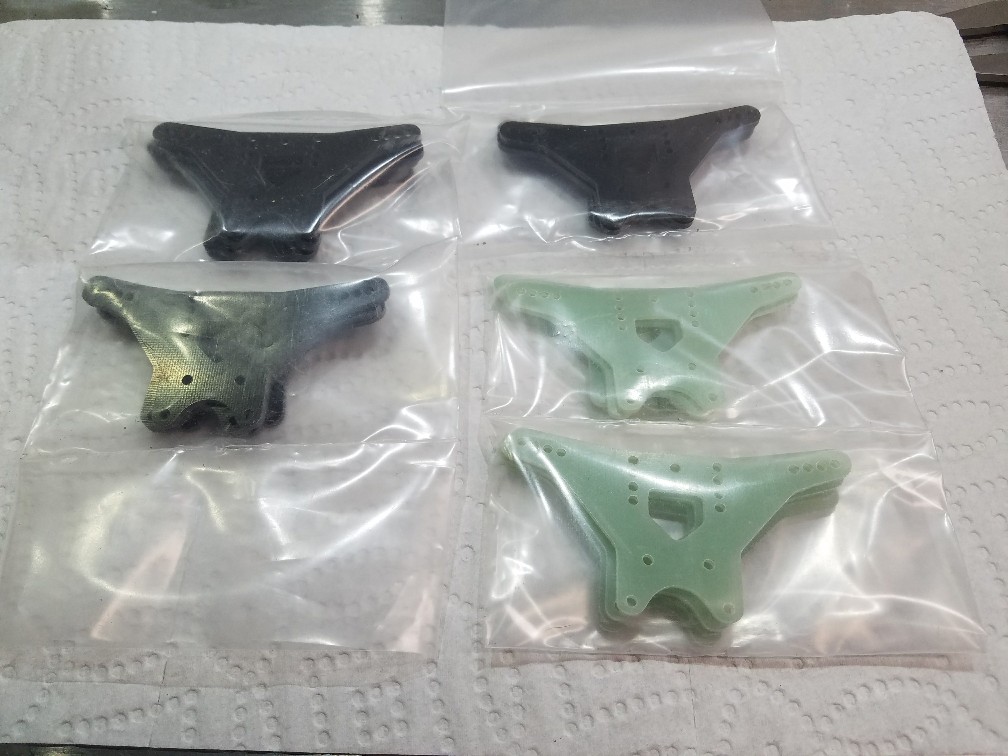

Production has begun! Towers by Jeff aka GoMachV aka Factory Works aka Vintage Team A&L :mrgreen:

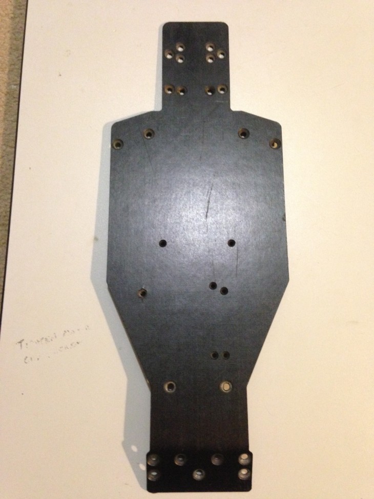

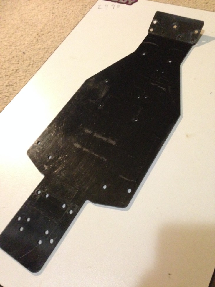

Does it have to be an AE chassis? I have an Andy's or Hot Trick (don't remember which) graphite chassis that I want to build into a mid-motor asphalt/parking lot runner. I have new simracing gear to acquire and a gold pan chassis to build into a backyard basher first though, so I wouldn't miss it for a while. I'd be happy to donate it for a bit if it will help with the development of your parts.

That's actually a houge chassis for trailing arms. I think it is sourced from composite craft though.
Thanks, very cool of you! 8)
I just may take you up on that. Let me get the "regular" version of the kit into production and available and then I'll start looking at a graphite variant.
