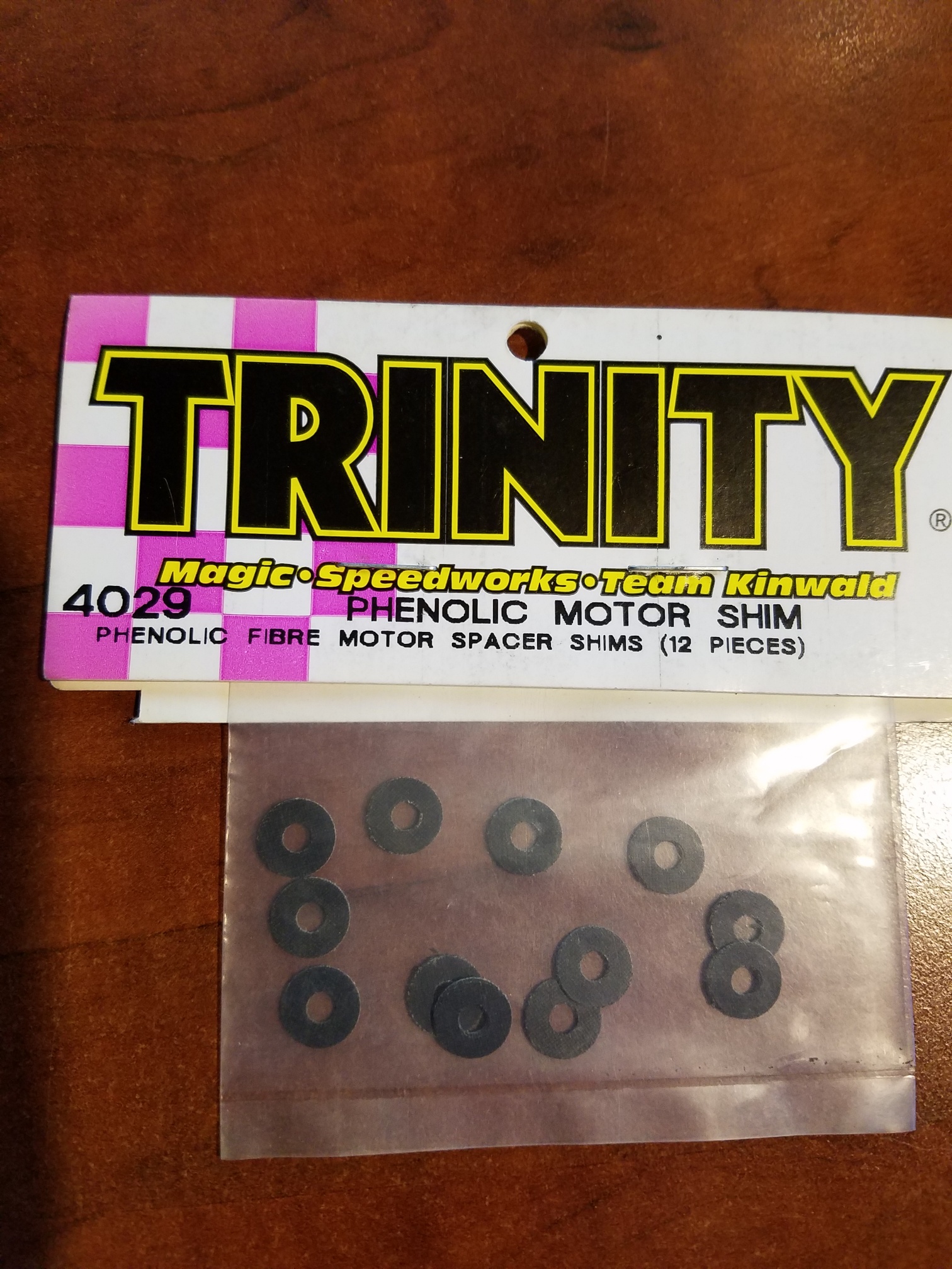

Phenolic motor shims is what I was originally thinking about. Are these a thing-of-the-past nowadays? According to the world wide web, they seem to be almost non-existent. The dude I bought brushes & springs from on ebay surprised me with these "on the house" with my order (pictured below). Also found another package of these exact shims on amazon I picked up for $10.juicedcoupe wrote: ↑Wed Mar 31, 2021 6:45 pm I buy M3 stainless washers at Lowes. They seem to work fine.
On a bushing motor, I try to put brass or teflon against the bushing itself.

In my opinion, a shim is a shim. It doesn't really matter what the material is. The diameter and thickness are what matter; if it's too big or small, it'll press against the moving part of the bearing or otherwise cause friction. I guess phenolic material wouldn't be prone to rusting, but neither would aluminum, nylon or stainless steel...and none would really matter if the car isn't going to be driven wet, or sitting on a shelf.

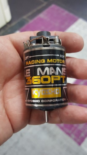

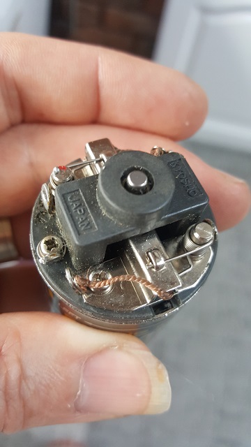

I recently picked this up, a 360PT in a case of motors I purchased. Sticker is an MCI repro i would say, but the condition is very very tidy indeed and it doesn't look to have had much use although I haven't stripped it or anything. Virtually zero brush wear. I don't know much about the LM range really as they weren't really my thing back in the day - reading here it sounds like it belongs on eBay though!
I only ever had a 240S back in the day, and that was a whim purchase from when I was on a family holiday and stumbled across a small model shop on the island of Jersey (UK Channel Islands) when I was about 13 years old. I have no idea what happened to it, it remains one of the few motors i cannot located from back then. All that has shown up is the polystyrene packaging from inside the box it came in. I know i never raced it in anger though.

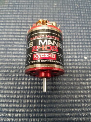

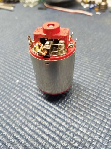

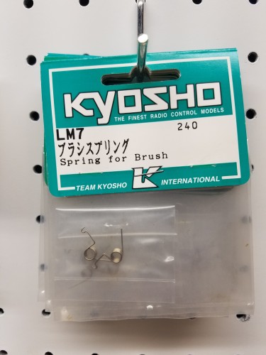

Rebuilt Kyosho Le Mans 240S with new bearings, Kyosho LM7 240 springs, Trinity Speed SPEC Brush ID Shunt Dual Face brushes, and a brand new Trinity/Epic 19T single wind armature. Decal is a MCI racing repro.
"Broke in" the brushes at about 2 volts for 20 minutes, then let it cool down. Tested at 7.2 volts with 0* deg timing the motor spun 32,700 rpm, @ 3.25A. At 7.2 volts with 6* deg timing it spun 35,400 rpm, @ 3.5A.
Needless to say this thing surprised the crap at out of me. Never would've guessed it would turn that kind of rpm, 30k rpm would've been surprising. These springs are not stiff, nothing like Trinity purple 13oz springs.
