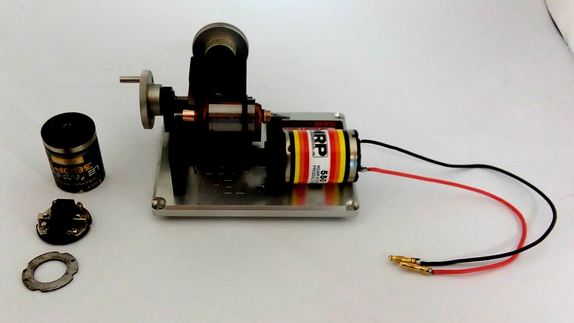

Had to modify the lathe to cut 550 size arms

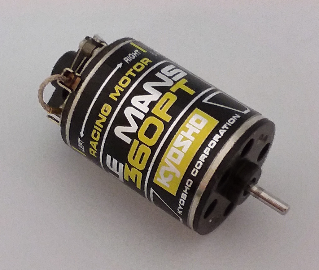

Re: Le Mans motor restorations
Dude from Ultrahive mailed me letter, he said his site was messed uo and didnt know what i ordered...he has fixed it since then and is sending me both 360st and 240st decals for same price! Excellent service. Also said he can print any small decal i might need so keep that in mind if u need something special.
- coxbros1
- Posts: 2495
- Location: Energy, Illinois
- Has thanked: 2758 times
- Been thanked: 2407 times
Got this in the mail today
That is after a rebuild minus new decal comin from MCI.
It turned 16,100 rpm, 2 amps as delivered @ 0 degrees timing, @ 6 degrees 18,500rpm
After rebuild (cut comm, new bearings, align brush hoods, new brushes) 17000rpm, 0 degrees timing 1.5amps, @ 6 degrees 20,000 rpm
Very smooth....one of my favorites for sure

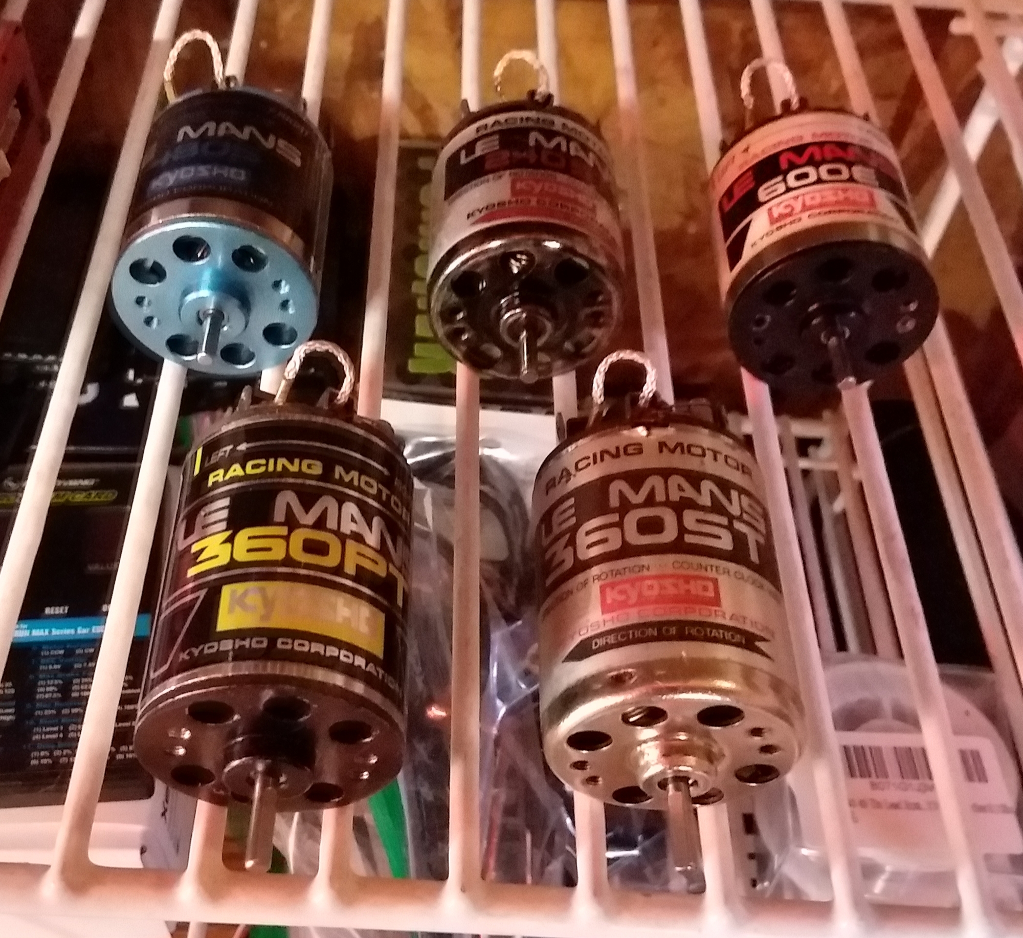

Collection so far
Collection so far
