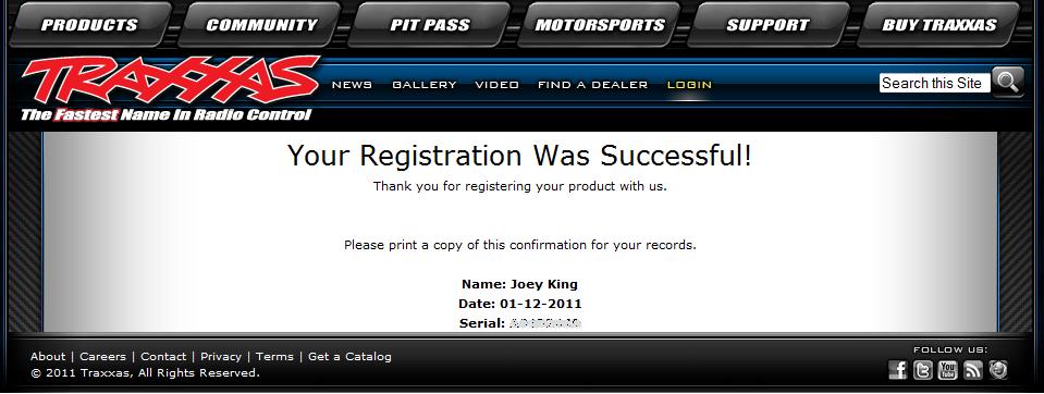

Post by JK Racing »
drbelleville wrote:PS: Being that the buggy still has its registration code, I wonder if they will let you register it :lol:
ummmmm....Yep :mrgreen: :mrgreen: :shock:
