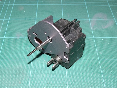

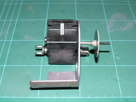

Just like this....
Notice that the A-3121 Slipper plate has the long boss.

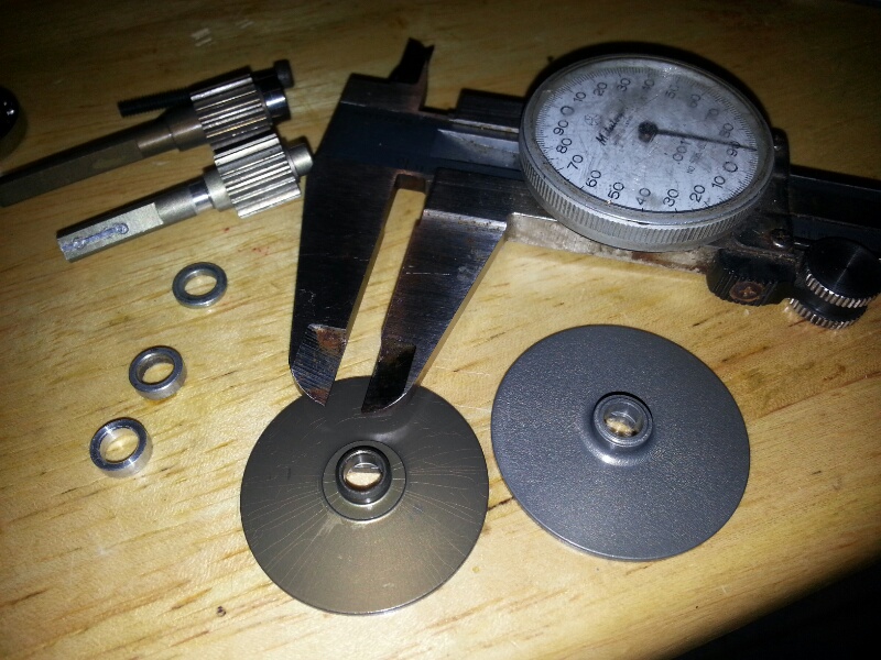

This is the spacers(basically rear axle spacer) and also a losi vs slipper comparison...they measure almost exactly the same.
Usually you can find a b4 slipper without the motor guard just plates,discs,gear,spring,cup,nut for like 9.99ish. Then all you would need is the spacer shown.
Or you could go losi tall plate and need to pickup the rest. In either case you will need the shaft for sure.
