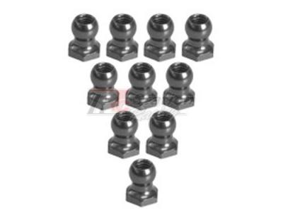

Had a closer look at the rear end, looks like even a millimeter or two will help free things up. To keep the rear shock springs from obstructing the camber links, I had a couple more ideas, but involving the way the camber links are mounted, instead of the shocks. If you already got the rear suspension working smoothly already, it may be unnecessary; but it could also help you get a more favorable shock angle, because you're tweaking the camber link position rather than the shocks.
You could add a 1mm or more spacer where the ball-studs attach to the rear bulkhead for the camber links, which would push the links rearward a bit. Another thing I did when I needed a ball-end to be as low-profile as possible is to simply cut off the bottom hex part of the ball nut with a hacksaw or Dremel, then screw it in from the opposite end with a 3mm screw. Since the ball nuts are threaded right through, you just need to make sure the screw isn't long enough to protrude through the ball when it's bolted on. That'll also help to push back the camber link a millimeter or two. I wish I had a better picture to show this, but if you cut just the hex part off a ball nut like this, you'll be able to screw it very close to the top of the rear carriers.

those are good ideas. the only risk with a "cut" ballstud is that you are missing the "larger" fooprint of that flat, extra-to-the-ball part, which is basically your best insurance for the stud to not break right where the plastic part stars. For now my assembly seems to work, the next step is to actually shim the rear inner camber mount back to get another fraction of millimeter back. But I'm getting there. As said, worst case, I will change the wheelbase via removing material at the front/rear of the (resp.) rear/front arms
