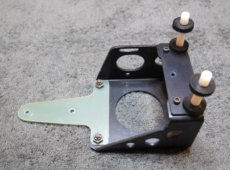

Re: Parma Euro Panther project - Chris Arnold special
Rear pod assembly was the next step now.
Pod was borrowed from a donor car as the t-bar. The parts were cleaned initially with brake cleaner and the proven super-sonic cleaning machine afterwards. For the rear body posts, Chris didn´t use the usual aluminium tubes but went with threaded posts again. These consist of metric M5 nylon bolts and the same Schumacher serrated nuts as used for the front.
Chris liked red dyed plastic parts at some of his cars, which also could be seen at his 1984 Worlds car at the museum. But sometimes he also used white parts. At the next buildings steps there will be special made parts, which are using white parts indeed, I decided keeping with white color for those bolts as well.
But I promise, some really nice looking red parts will show up in the end.

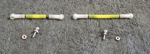

Next steps will be the center dampener, the roll bar and the steering rods. But I found some parts are missing which will prevent me from finishing, these are the 2-56 threaded balls and some plastic ball cups used there. These parts were sold by Parma, Associated, Calandra and some others but I can´t find them now.
Another step will be the rear axle and diff. I have no real manual for the Euro Panther and no idea how much worth of spacers are needed. From the pictures I know it is a lot and seems more than with other cars. Someone knows?
Have to find the amount of spacers then.

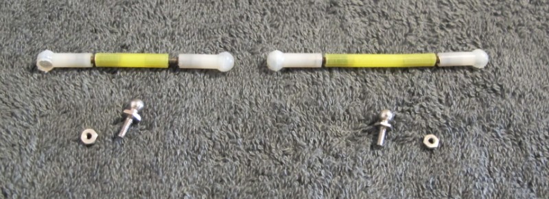

Found some more bits in the hardware boxes and "borrowed" some other from incomplete cars ....... which are even more incomplete now.
Parts for the center dampener. Comparing with the Delta cars there is no spring and no real shock. But the t-bar is more on the stiff side and act as a harder spring. Damping is provided by the silicone tubes. You could change damping by length of the tube, longer version acts softer and shorter version acts harder.
Roll bar assembly. Hand built by Chris, very few were made. Comparing this prototype roll bar with production units you will find two differences. White plastic and brass collars where the production roll bar came with clear plastic and steel collars.
Ball cups for connecting to the chassis are clear because there are no white ones.
