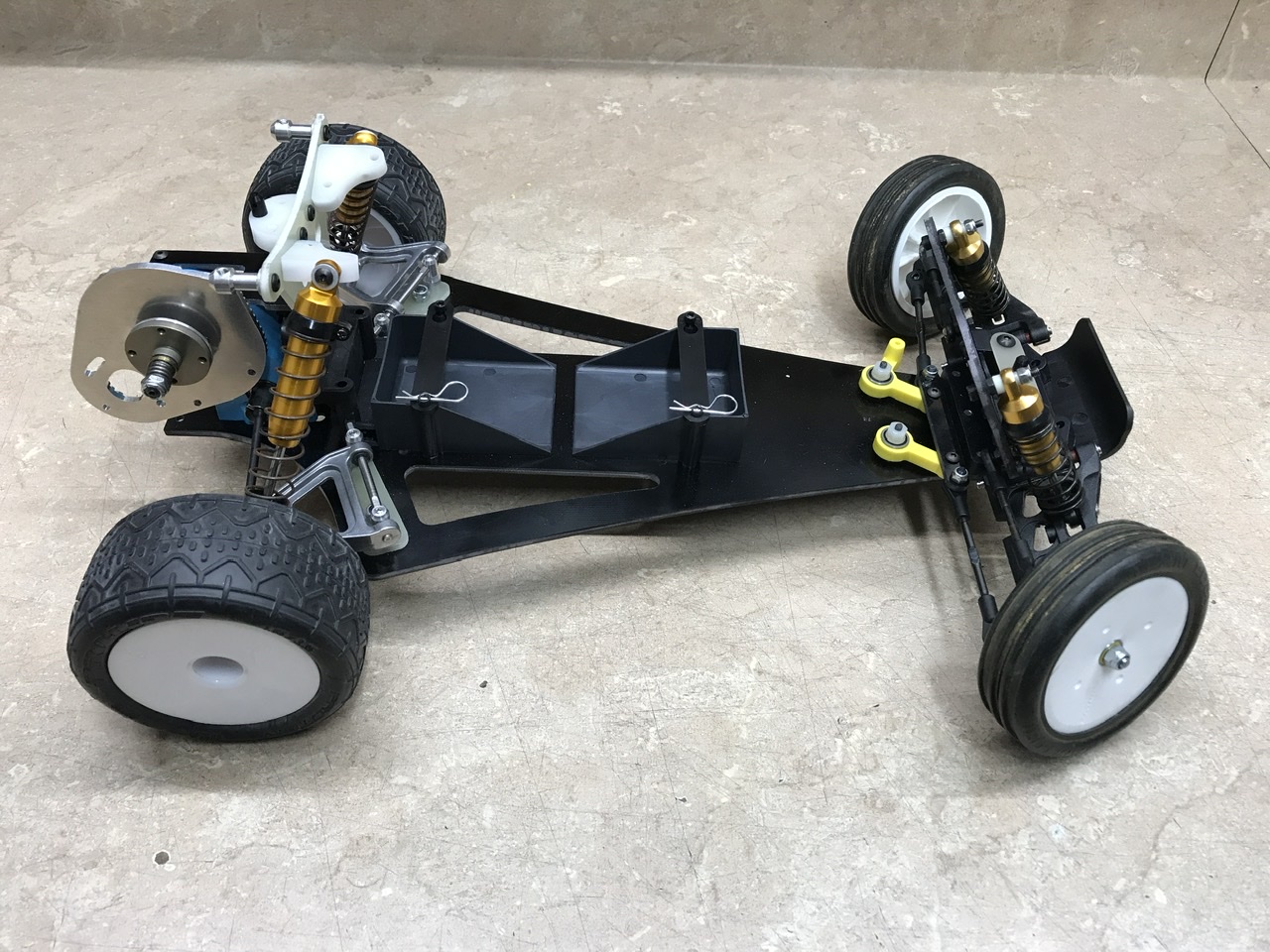

Sorry to resurrect this thread, but I had a quick question for GoMachV. The rear wheels on your TRX3-B are they the Traxxas wheels? And do they have a 12mm hex? TRA2474
I’m having what I think are fitment issues with some associated wheels I purchased. They are rubbing on the rear shocks. I was thinking maybe using the Traxxas wheels would have the correct offset. Awesome chassis BTW. I like the use of the nitro rustler rear bulkhead.

I don’t recall what I had on that particular car- they were likely the original bandit wheels. If I understand your dilemma you want a 12mm hex wheel with and old school offset to not rub on an AE buggy- for that I would recommend the Traxxas Mini E-Revo wheels. They are 2.2 buggy wheels. Part number is 7171. I have used them on optima variants and such, really the only negative is that they don’t offer a 2wd front that would match, and the mounting flange is thin which may require a washer on some axles. Here’s a set on one of my trailing arm cars.

Re: TRX-B (poor mans TRX3) and SRT-R (you guessed it!)
Thanks for the tip. I will take a look at those wheels. I am actually building up a Bandit with rear motor that I put associated wheels on it. I just think the offset is too deep and the inside lip of the wheel will contact the rear shock. But I’m going to take a look at the e-revo wheels

Finally got the 7171 wheels in. Unfortunately the offset is now to much. They push the width out too far now. Thank you for the option though. I will mess around with different width wheel hexes and hope for the best.
