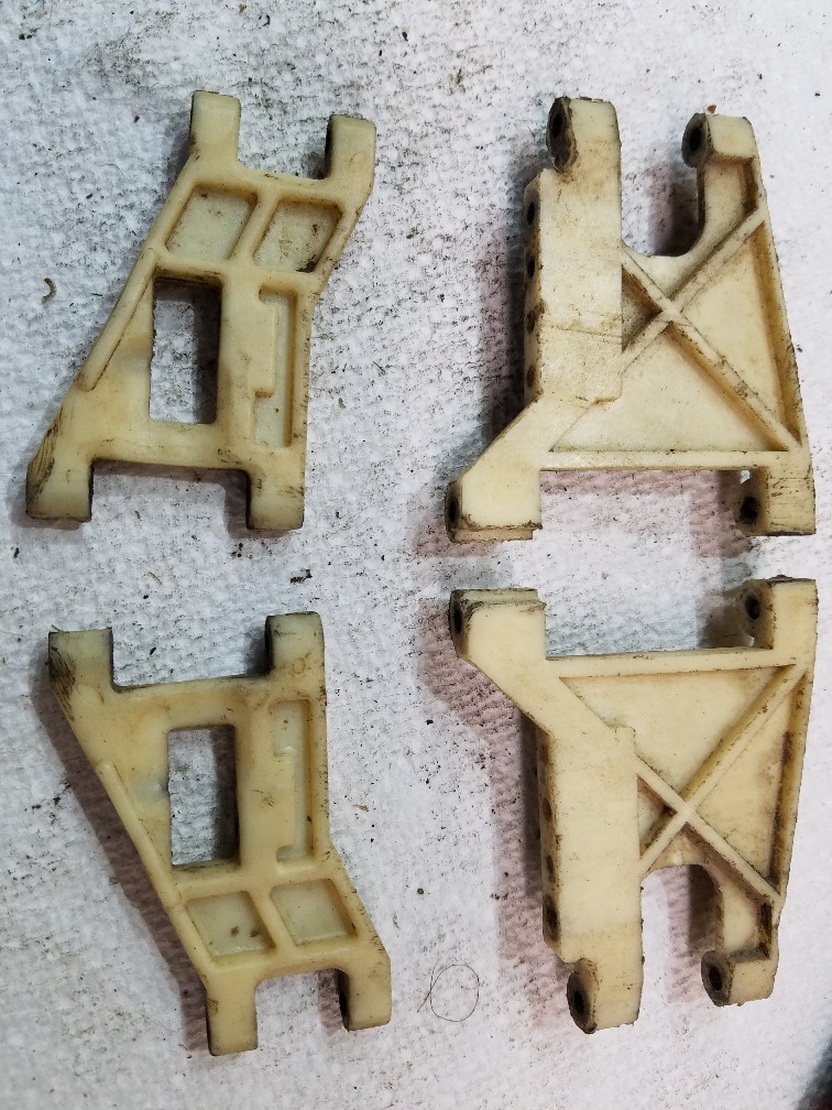

What would you guys suggest for ball cups for this car? Guess I'm going to need ballstuds too.

I would try to find the correct half hex ball cups..... Even if they are used. They would fit with the overall condition of the car.
Or just keep the heim ends on it. They were a popular upgrade.

Okay, maybe I'll just keep the heims. BTW, why did those fall out of vogue? The seem much better than ball cups. When I ran them BITD I never had one pop off. Ball cups on the other hand... Maybe because ball cups pop off and prevent something else from breaking or bending?

Yes and it's adding unsprung weight which is really not what you'll want.

I use them on my outer steering turnbuckles since those are the ball cups that usually pop off.

Cool, thanks guys. I think I'll reuse them, I think they are kind of cool. I don't need to worry about a couple grams, my shelf can support the extra weight no problem

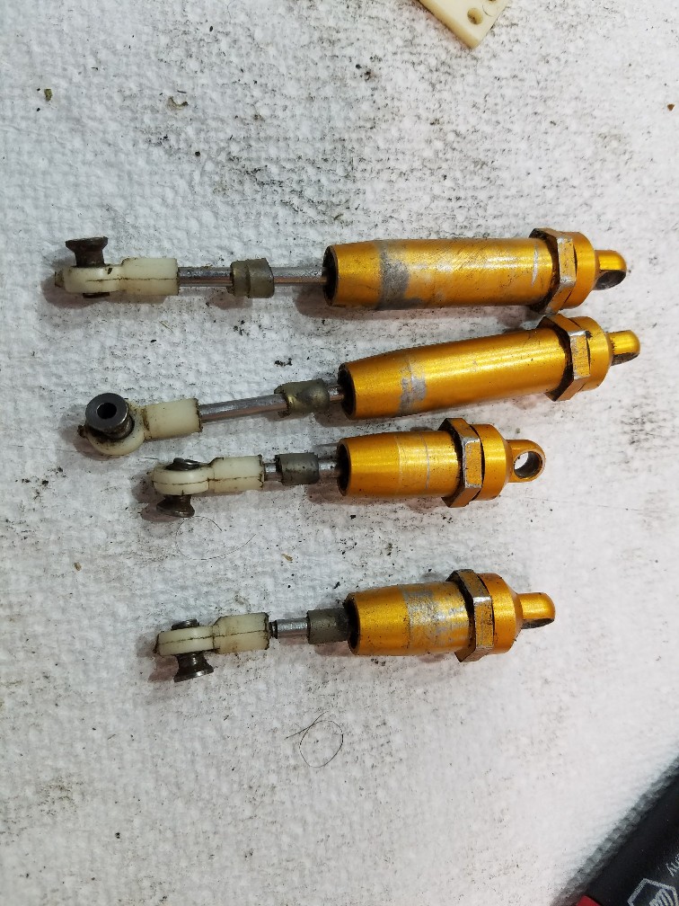

Question for you guys: Does the 6440 rebuild kit fit bottom loaders?
https://www.teamassociated.com/parts/details/6440-ASC6440-rebuild_kit/
- Posts: 12336
- Has thanked: 1129 times
- Been thanked: 3917 times
Re: RC10 Graphite resto
For bottom load I use a traxxas 2362 for the plastic washers and retaining clips and Associated 5407 for regular orange orings. In the 6440 kit you get the same orings and the plastic washers work great- but you don’t get the large plastic washer or the retaining ring. The 6440 also has rubber shock cap orings which work much better but aren’t era correct. There is no replacement for those that I’ve found although I’m sure they are off the shelf Teflon seals for something.

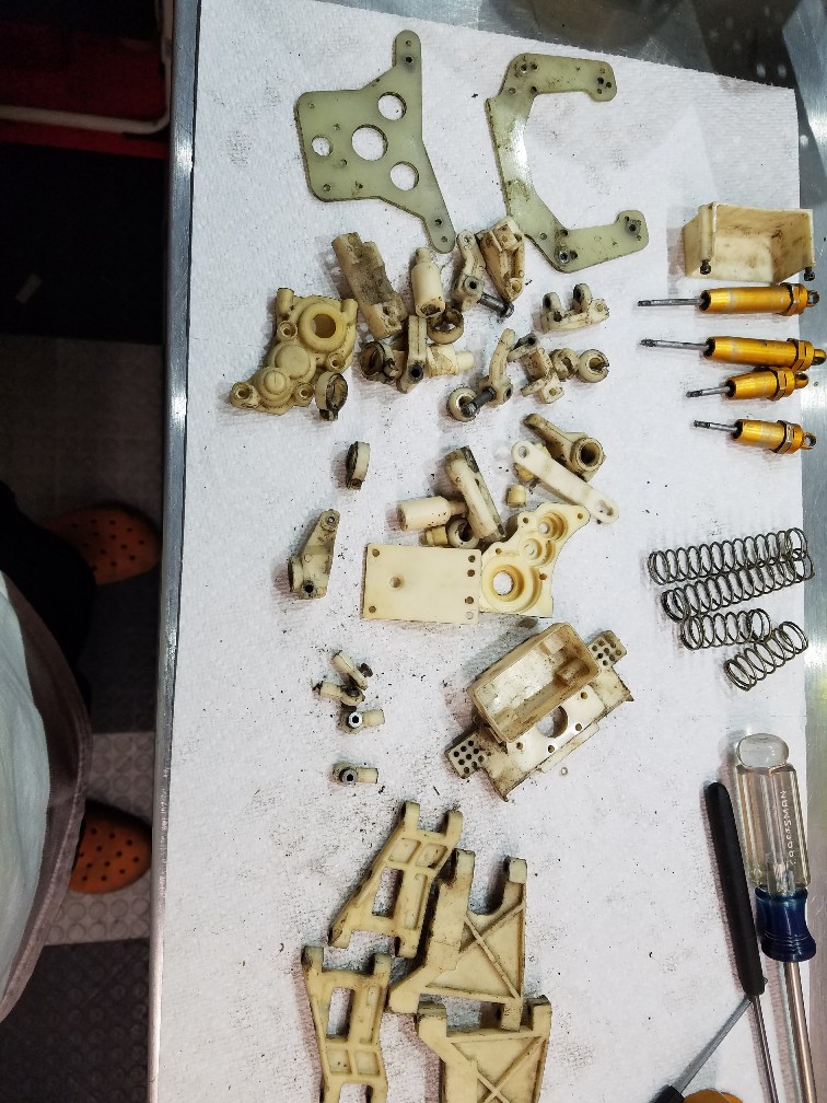

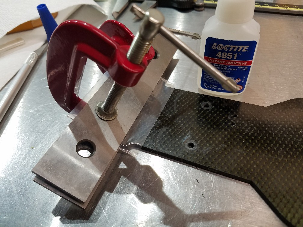

Thanks to the great tips in this thread, I glued up the nose of my chassis last night. I used LocTite "superglue" with a needle tip so I could get the glue down in between the layers that were separating. We'll see how it comes out. I'm sure I'll still have to trim some of the edge off, but hopefully not much.
I also took the nylon parts out of their bath. They had been soaking in water with Dawn for a couple days, and I gave them all a good scrubbing with a toothbrush when I first put them in. Only part I'm not happy with is the transmission case. I may give it the peroxide treatment to get it to match the other parts a little better. Note there's no battery cup there because I wasn't happy with how it had been hacked up. I have some unmolested original ones in my stash that I'll use one of.
For those of you that have done the peroxide treatment to whiten up yellow parts, looking at that transmission case about how long would that need to soak in peroxide to get it to more closely match the other parts? Just trying to get a rough idea, are we talking minutes, hours, days? I don't have a clue.Create an account or sign in to join the discussion
