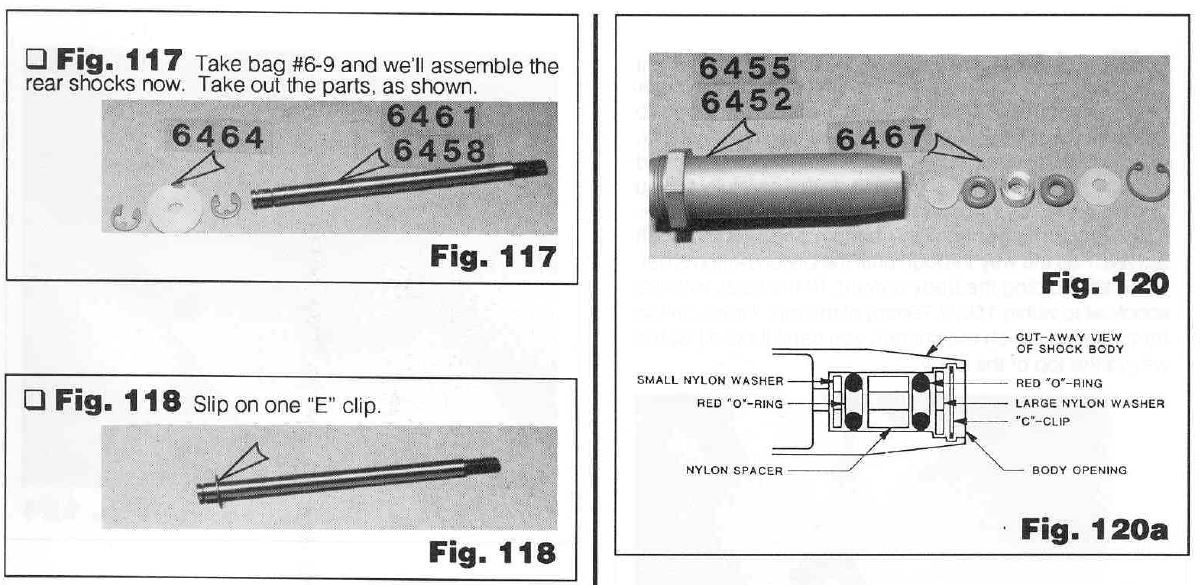

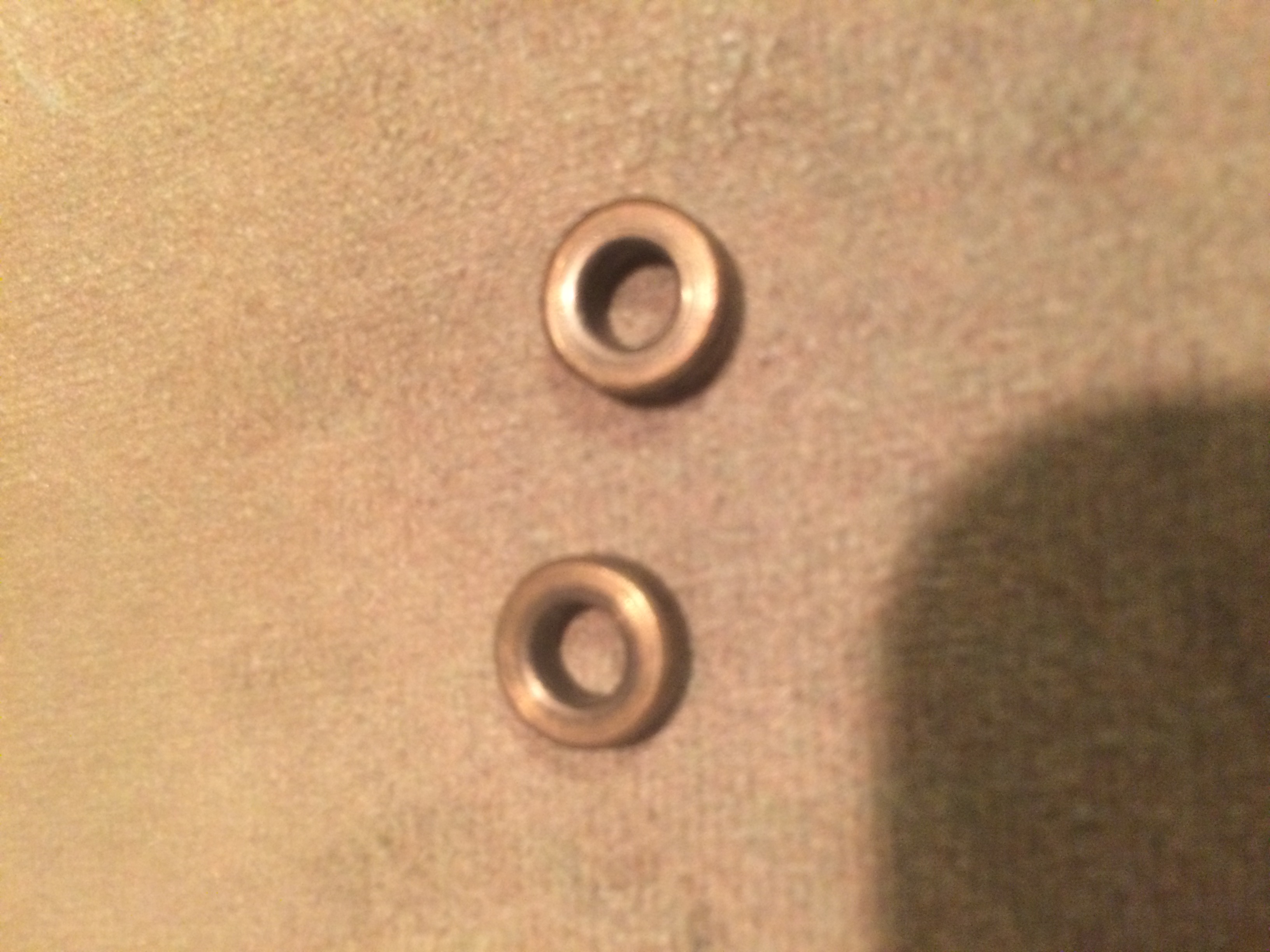

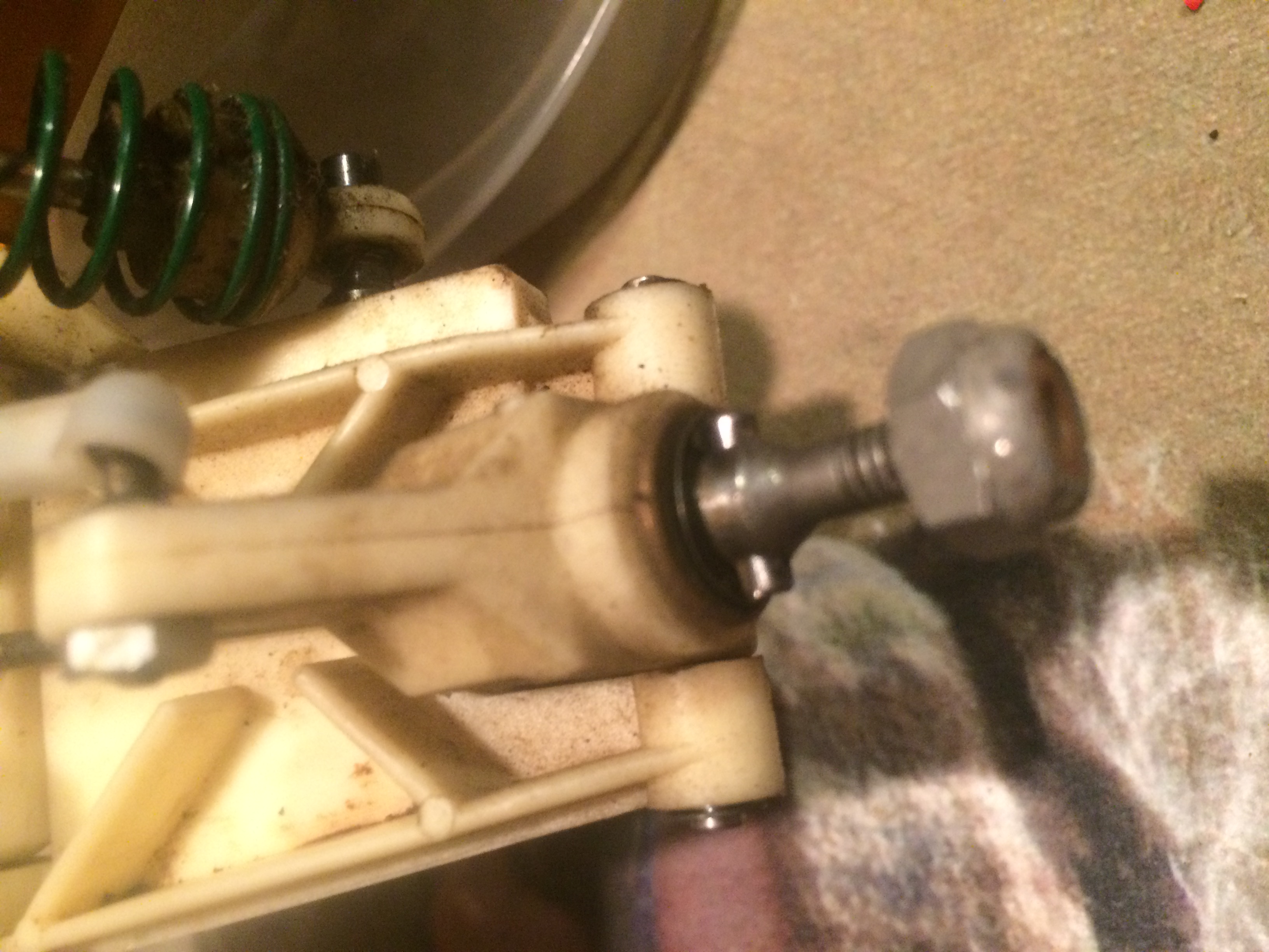

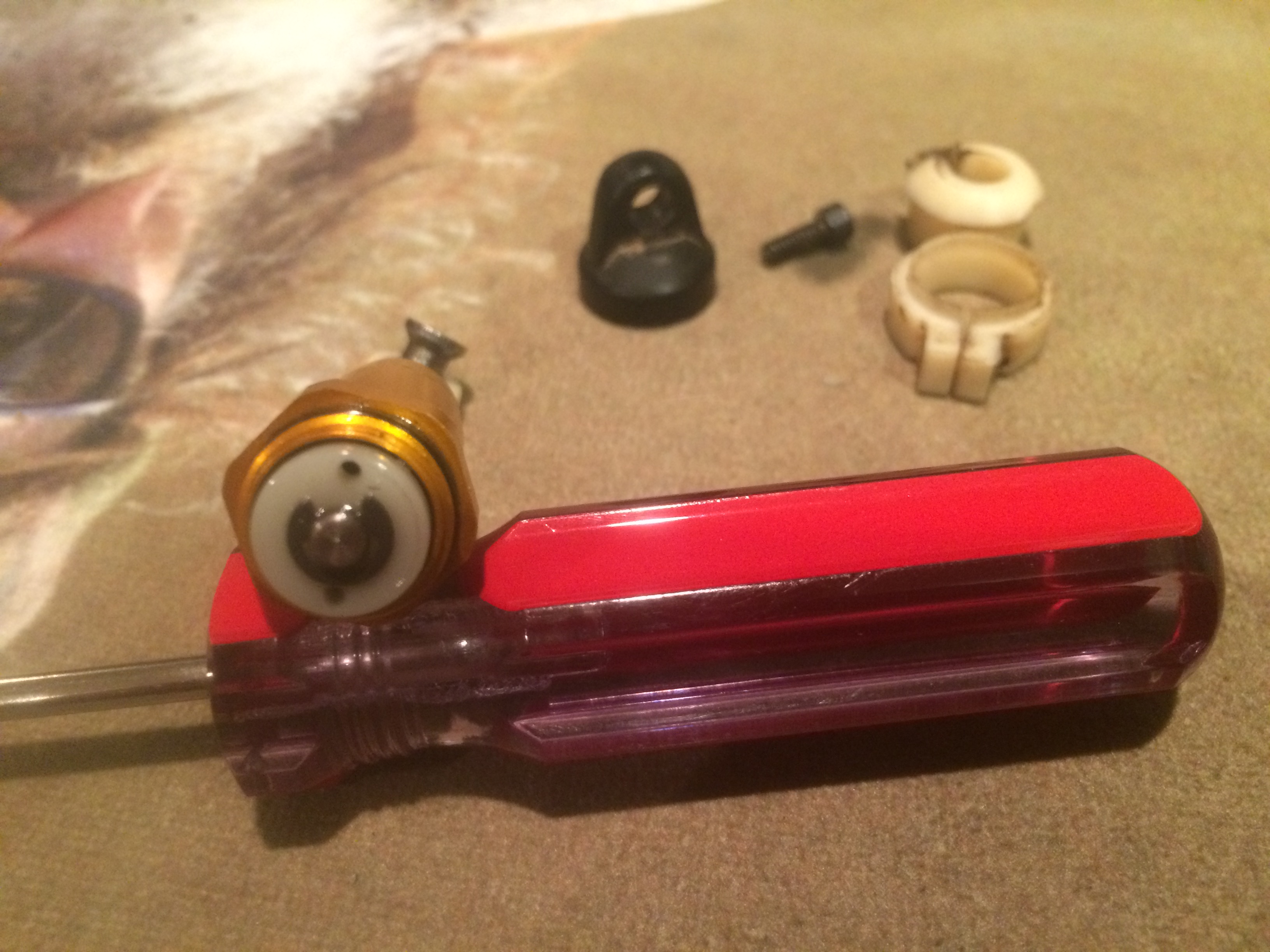

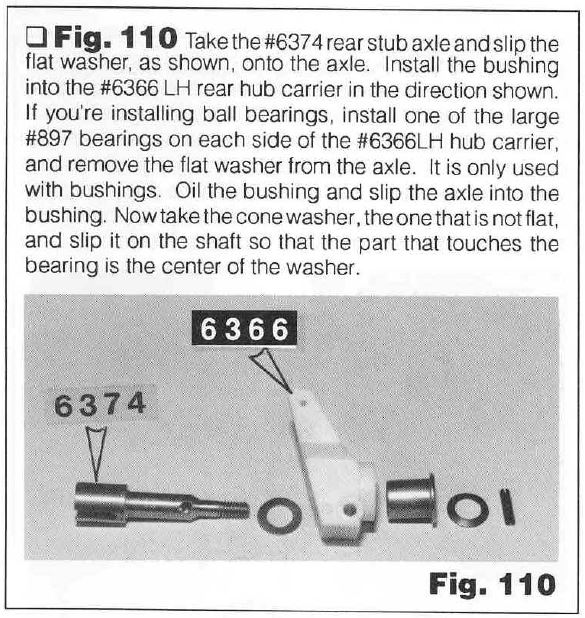

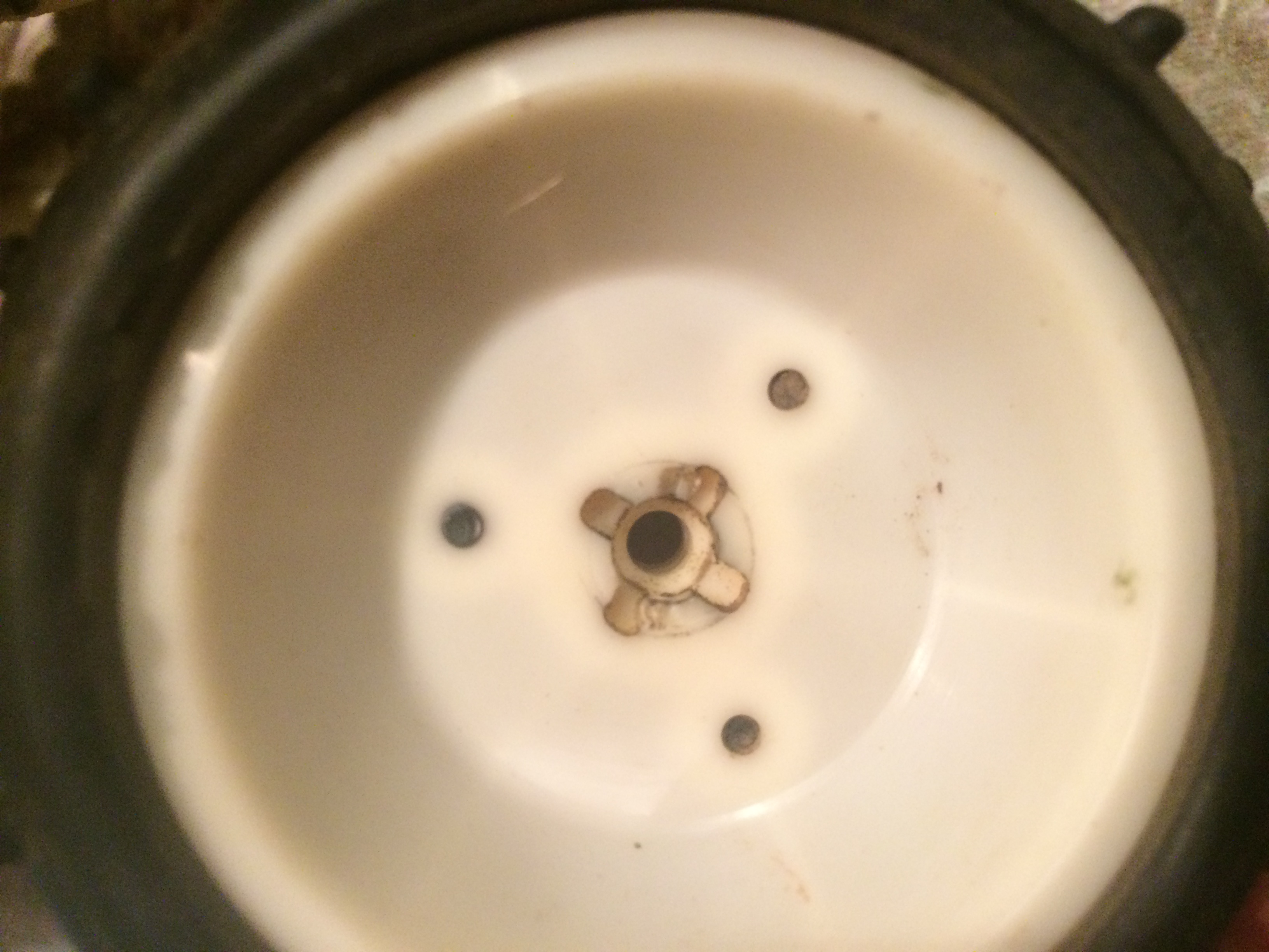

So i took the wheels off this thing and did a little light cleaning. Looks like this one still has bushings, at least thats what it looks like in the pic right? Well the bearing conversion kit has like 16 of em for the car. ive found where 4 go on the front wheels (1 inside & 1 outside of each wheel) but i thought id need 4 more on the rear wheels. well when i took off the rear wheels I didnt find the bushings. Looks like the rear wheels just fit in a groove on the axle. Any one care to help educate me on this? surely I need 2 per wheel on the rear as well right? that would be 8 total for front and back wheels. where do the other 8 go? transmission surely, what about steering?

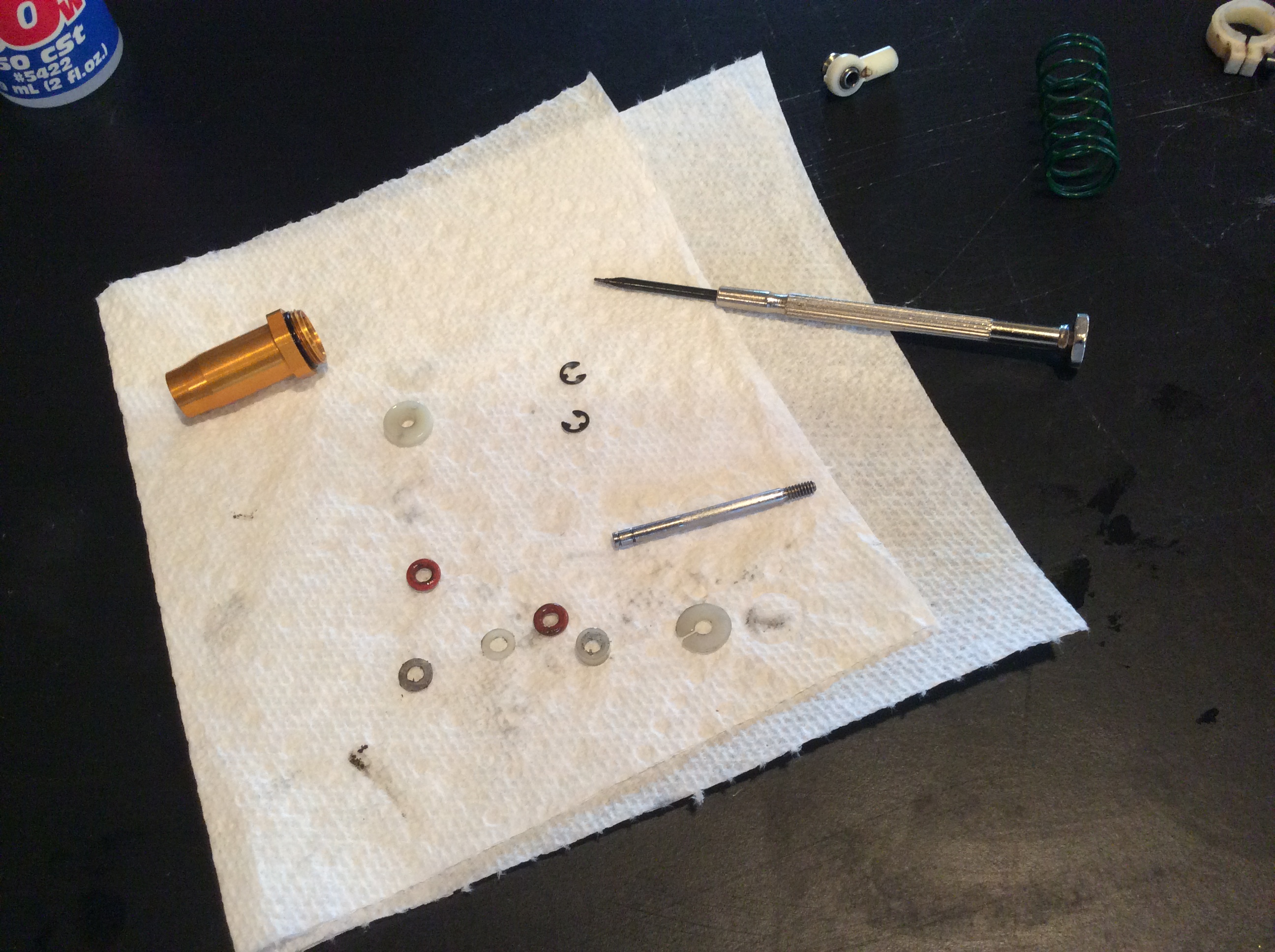

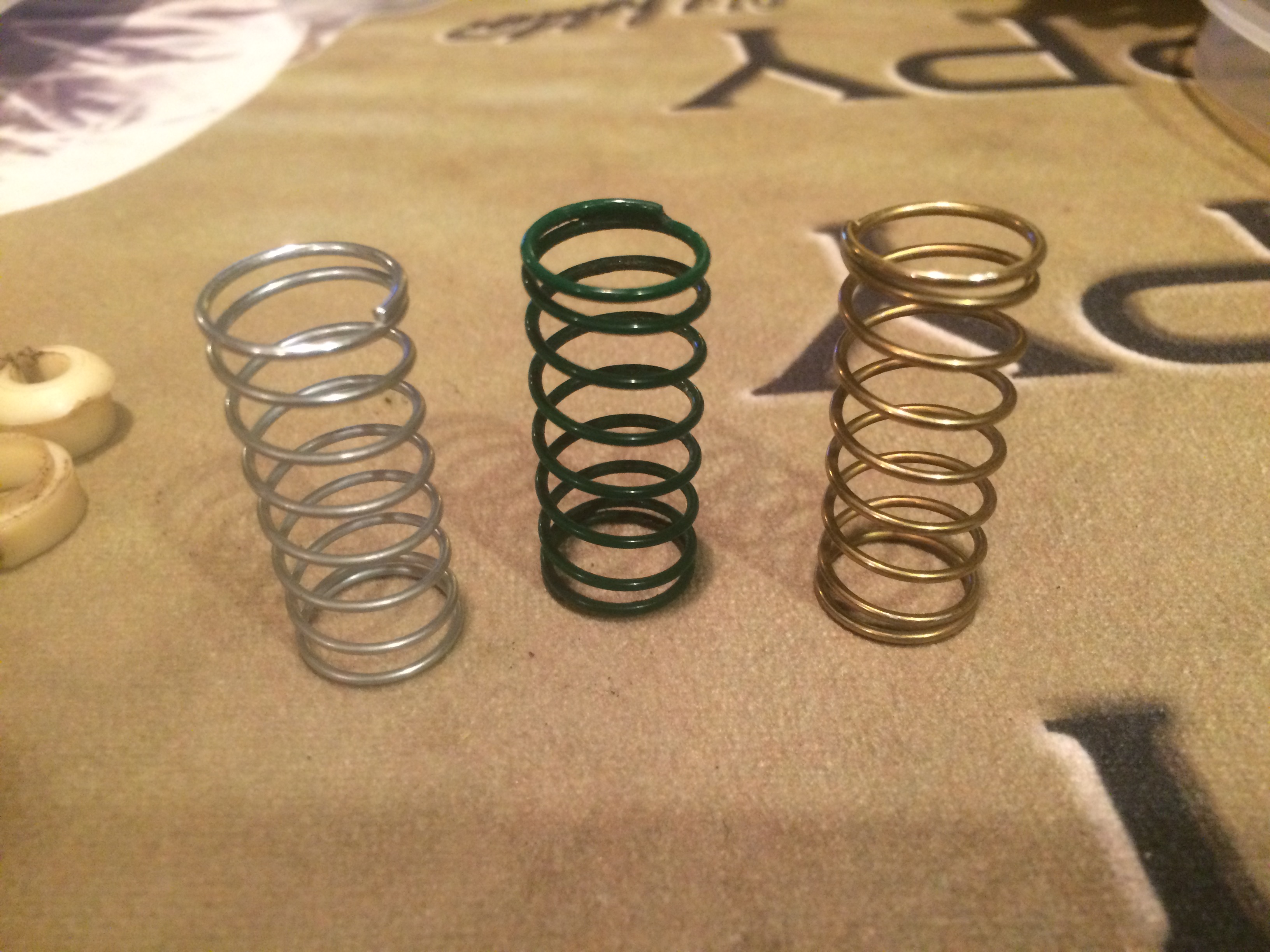

I also took one front shock off to try and clean/rebuild it. i was surprised it actually had a good amount of oil still in it after 28 years. Can someone tell me how to get the bottom of the piston out to full disassemble? I've got new o-rings to install also. Another thing, I found 2 additional sets of shocks. I have a gold, silver and green set of shocks for this car. Anyone know what the differences are? green seems softs, gold and silver are stiffer but I cant tell which is stiffest.

You'll need to pull that roll pin to remove the axle and its bushings. Gold springs are stiffer than silver. To remove the piston, you'll need to remove the bottom shock eye (use pliers with a paper towel or a strip of cardboard or something soft to protect the shock shaft). The piston is captured between two E-clips.

The only consumable item in the shocks (apart from fluid) are the o-rings. There's no need to buy a "kit", all you need are o-rings.
For fluid and springs, this will depend upon your track surface. The standard kit fluid and springs is a good place to start. My track is pretty tame so I like black springs and 20wt in the rear and silvers and 40wt up front. This and some sticky rear tires provides ample understeer to match my slow (old guy) reflexes.

Okay first shock is apart. What’s the best way to clean everything, esp the shock body? Simple green soak everything?
Figured I start with one in case I mess up. Also I can look at other side for reassembly.

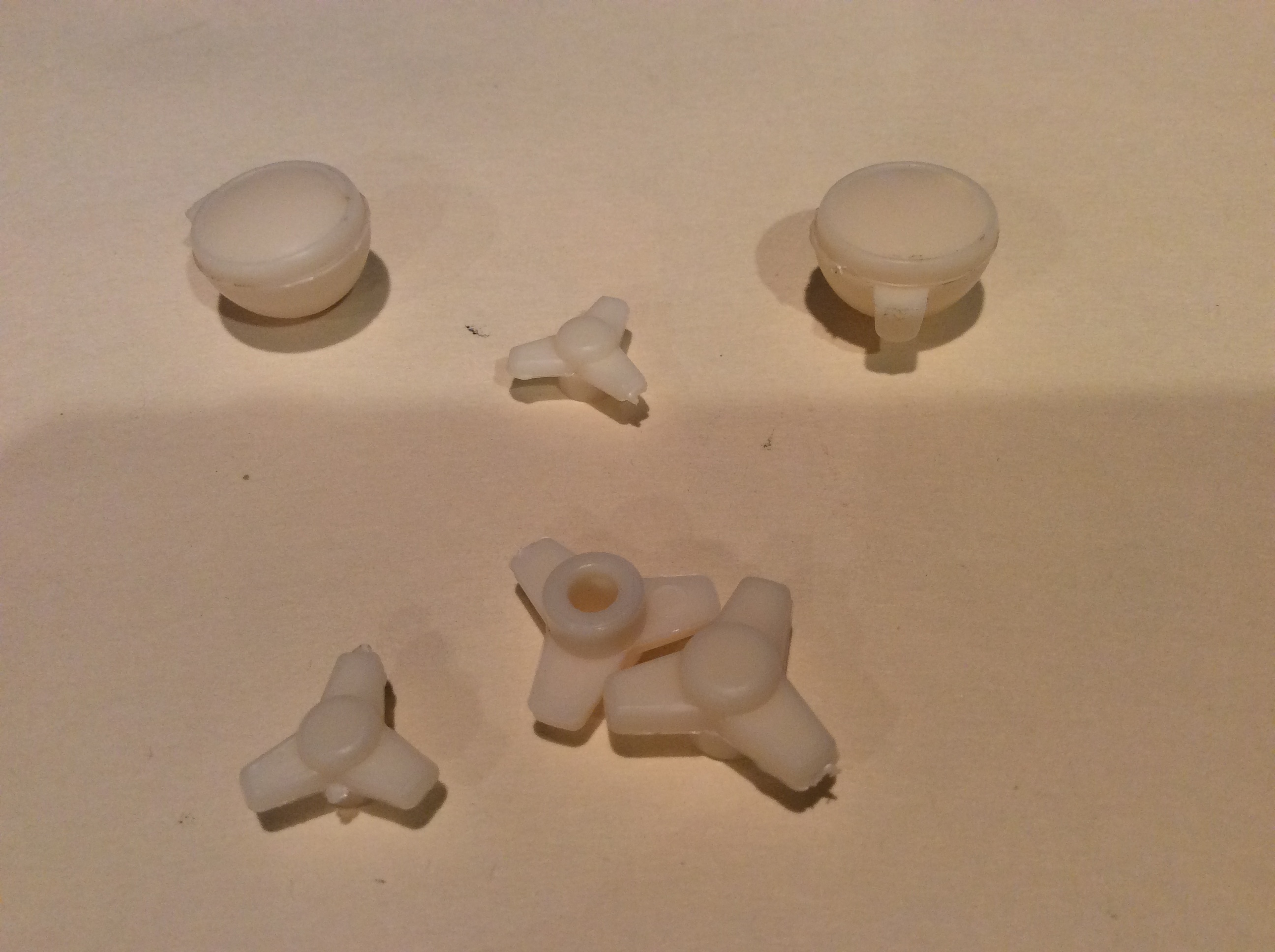

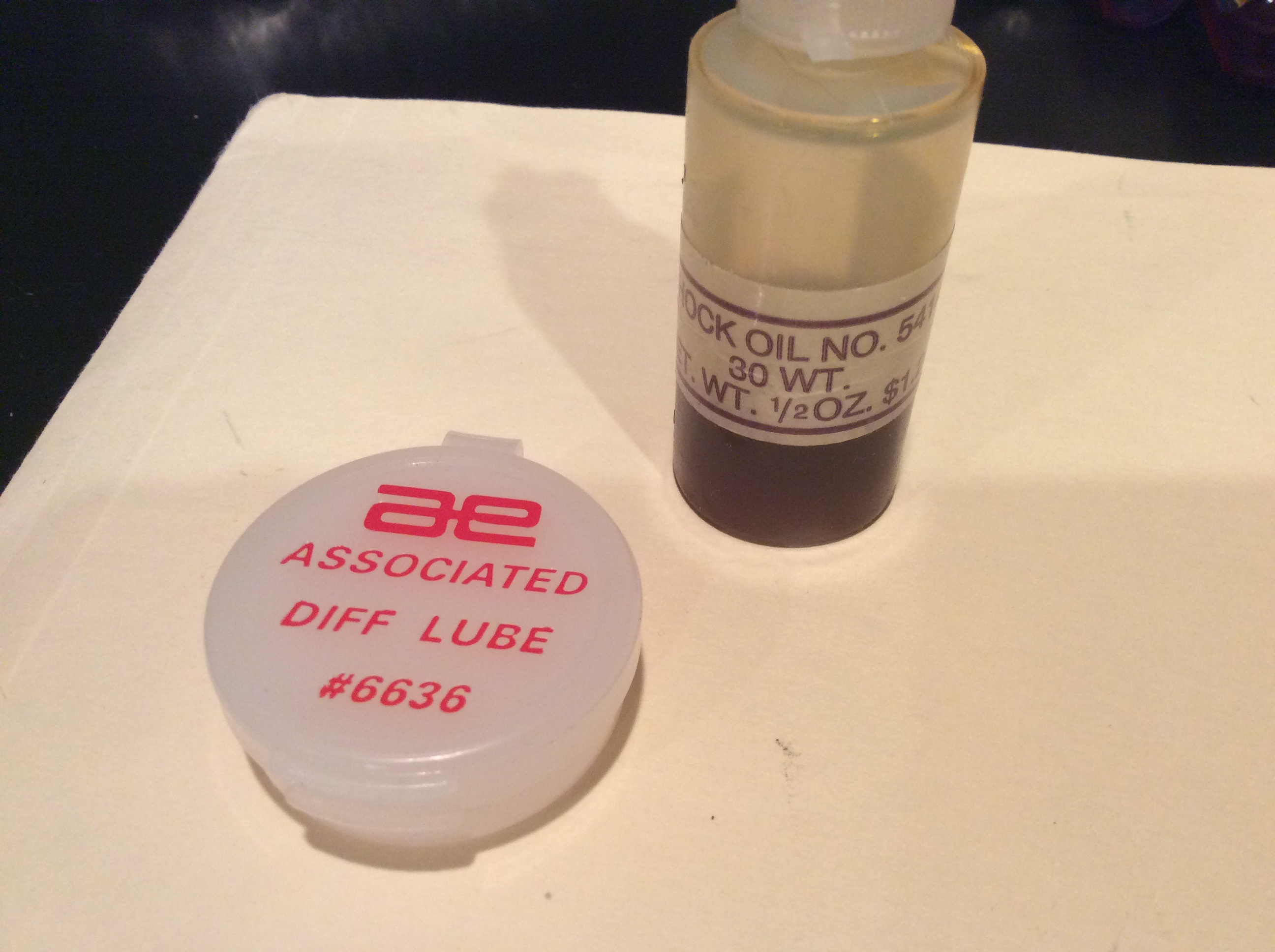

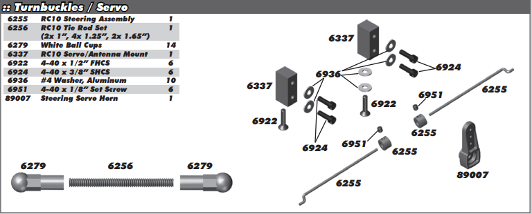

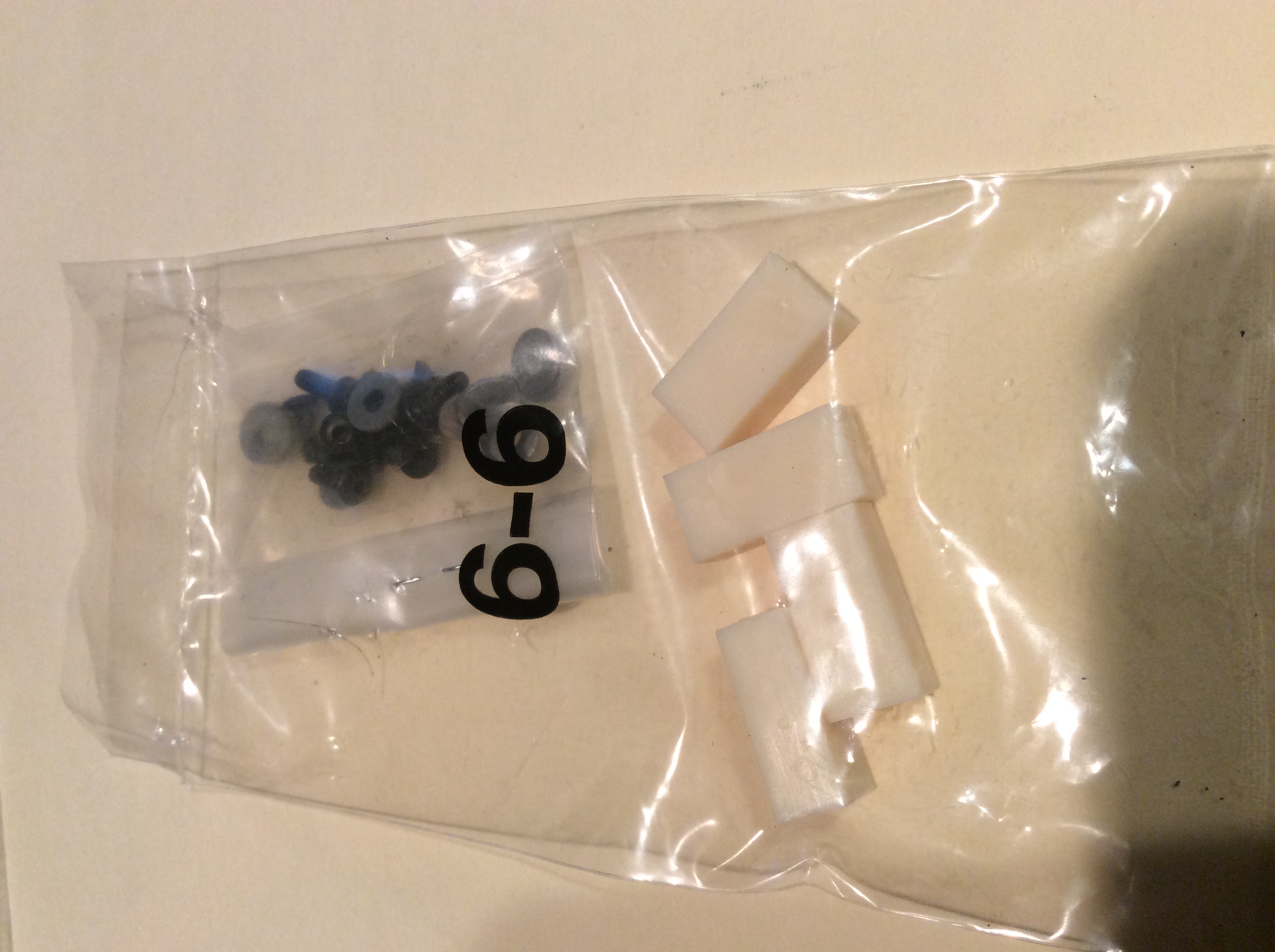

Here's a few other parts I have. Not sure what they are. appears to be extra parts from the original build. labeled bag 6-6. any ideas? also have this differential grease and shock oil....from the original build. not sure i'll use it but its prob fine. also have the KC lights, but what are the other parts in that pic? do those go on the wheels?

They look like servo mounts to me.
