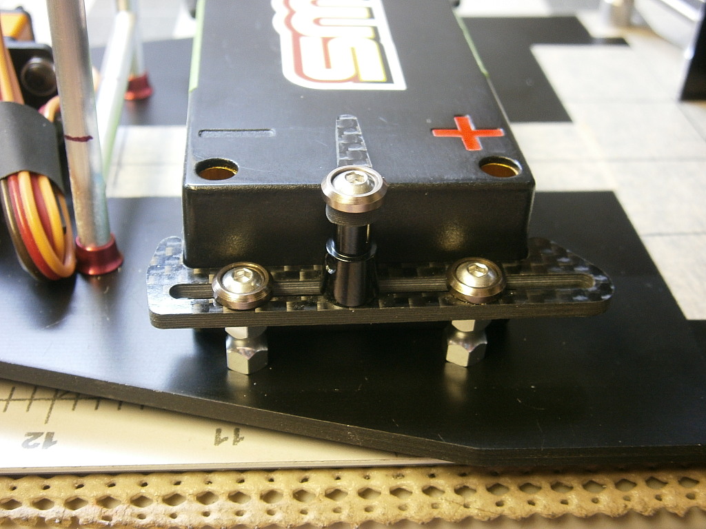

I got the battery (shorty lipo) holdown sorted out today. All I'm lacking is to mark and drill the 4 holes in the chassis plate to mount it. I used an Exotek brand #1827 system from AMain with a couple of mods and some 10mm tall hex stand offs. It looks pretty slick. You will be able to adjust it forward and back.

Battery holdown system installed on chassis plate. I was very precise with the drilling and everything worked out perfect, no movement of the battery at all and smooth movement forward/back.
