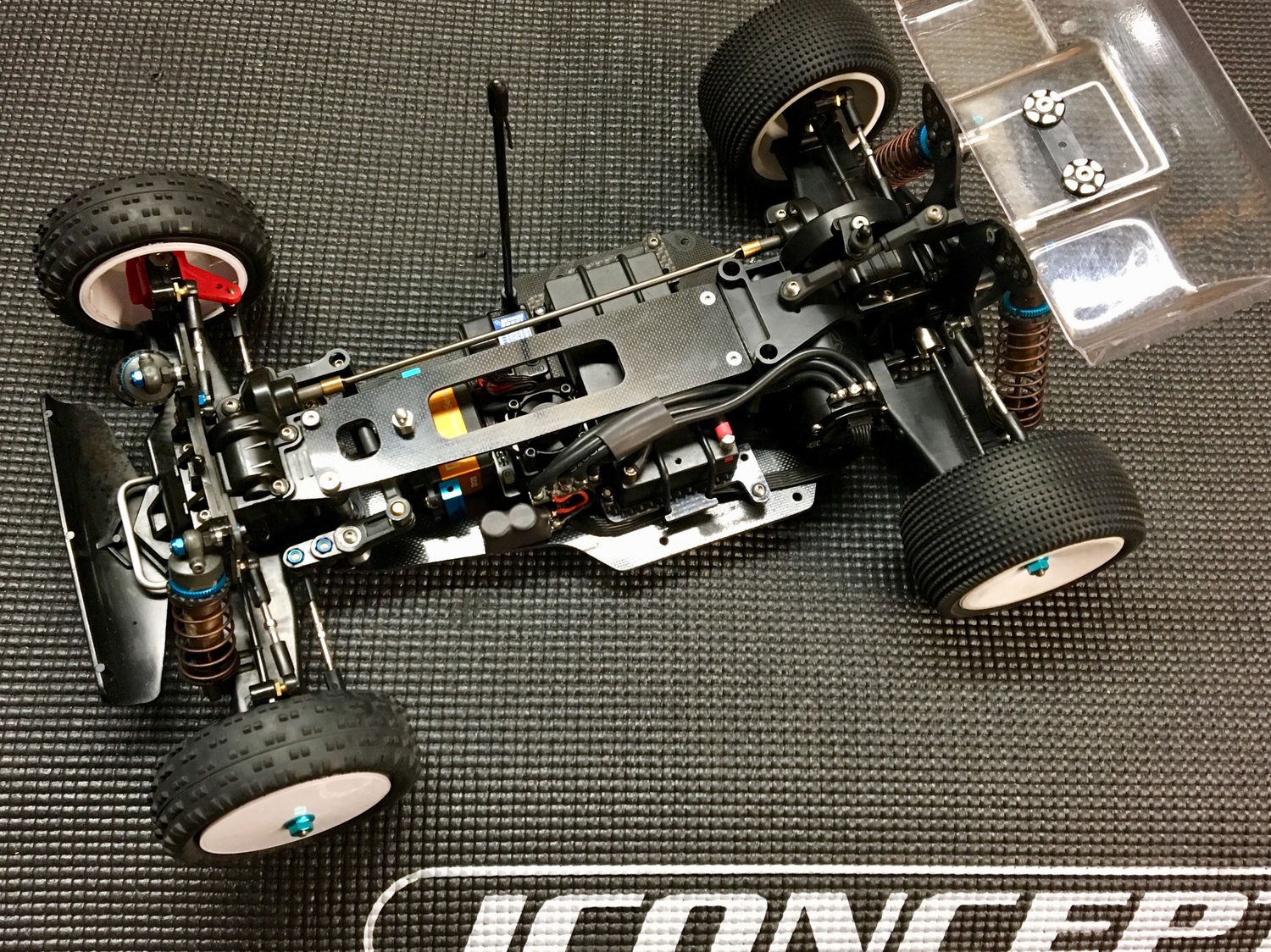

The drill mod on the rear gearbox is only "necessary" if you use the stock self-tapping screws. They tap a new thread each time you screw them in, and so with enough use, there's no more thread to tap and so it fits loosely. If you just use standard M3 screws from the start, then this mod is not necessary.
Those shorter shock towers are pretty interesting. Where did you get them?

The o ring will fit lcg and normal shorty Lipo
The tower came from Nick Walker who is on the top force Facebook group

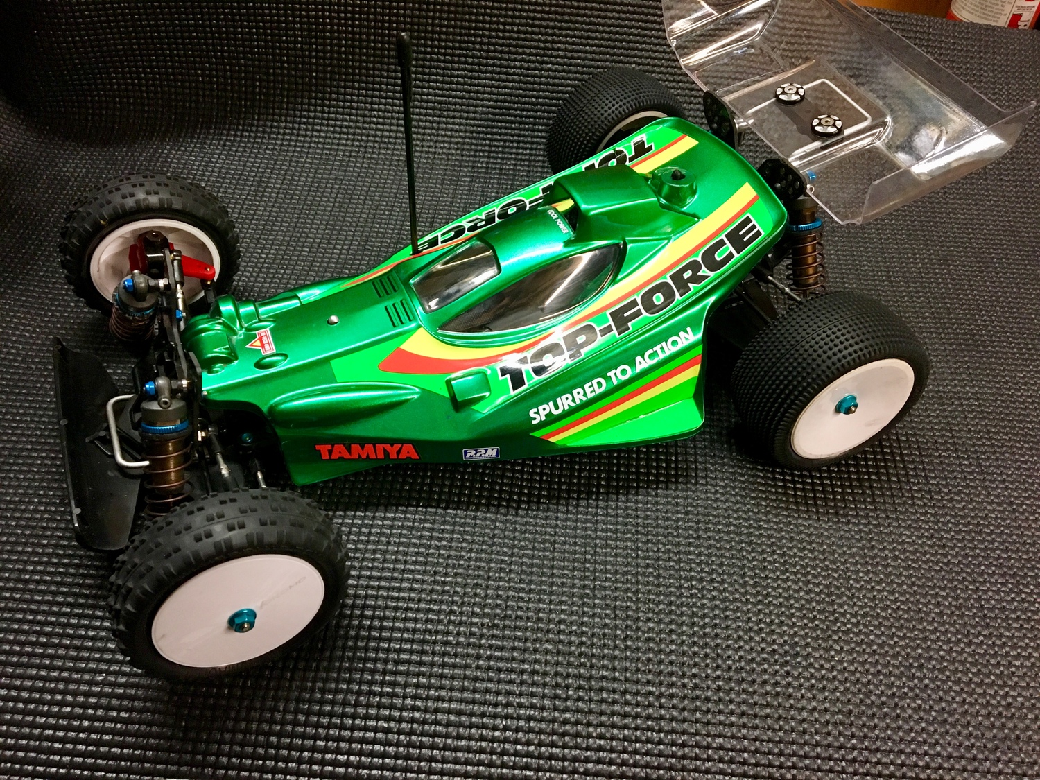

Done and ready for its first test next Sunday on EOS carpet
May change the shock oils and try and knock up some roll bars

Yes Schumacher tyres , staggers on the front and cactus rear
I’ll use the new fusion tyre on the front probably
Wheels are yokomo ones
Just low ride height, gear diffs with a thick grease (I use Tamiya anti wear grease) and stiff shock set up

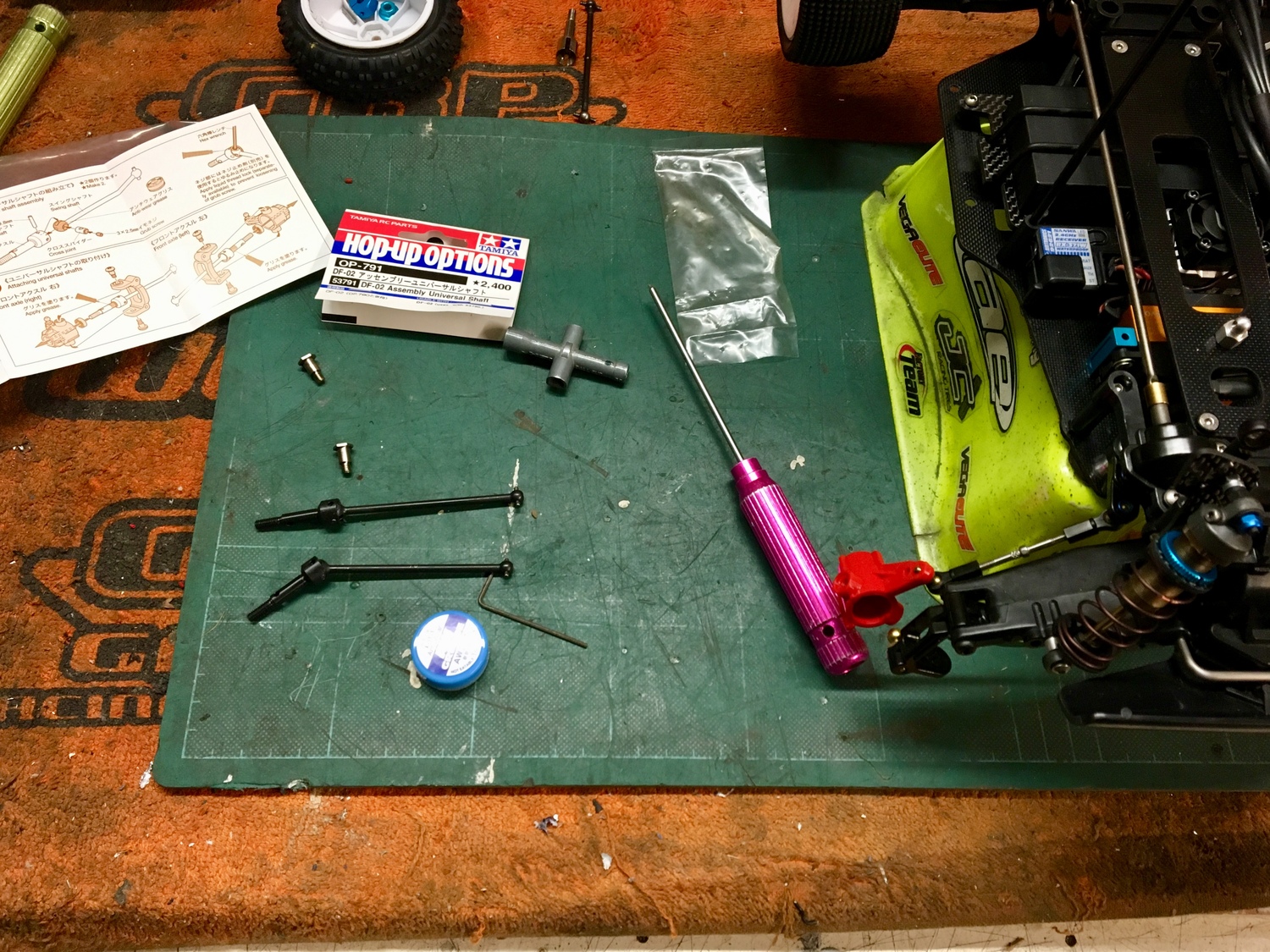

Do you know yokomo wheel part numbers by chance? That way I won't waste money on wrong offset 2.2 wheels?
Also, the gear diff's are part # 50529 correct? Do you need different outdrives as well and part # as well?
And finally, what is the one way layshaft you mention? Tamiya 53071? Hard to find if so.

Yes 50529 is the gear diffs and I took the one way out was want 4 wheel braking on carpet
Tbh if youre buying wheels just use the stock ones as they are the right off set, I had to mess about with different hex’s etc
