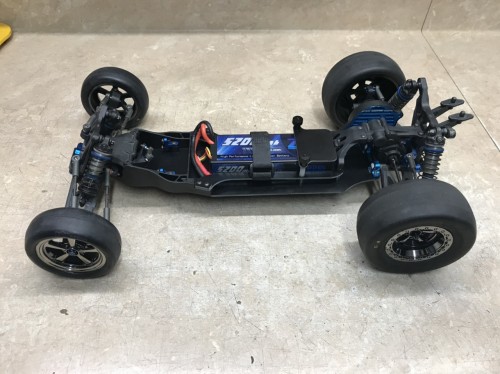

I just started in on a No Prep drag car build , using a B5M as a donor. I need to lengthen the chassis but the #71025 SC5M chassis needed to lengthen the wheelbase to +12 inches are unobtanium. A company X-Factory used to make a Carbon Fiber SC5M chassis at one time. I found out recently that X-Factory merged with or were bought out by TARP Racing.
I contacted TARP Racing through their FaceBook page about buying one and they told me that they would make a complete chassis kit for me. Not sure if its a production run or a one-off for me. Anyways, it seems that we can get a long chassis again to make a SCT wheelbase out of a B5M. They said that it would be available by Dec 8-9 2020 or so.

Just a heads up, we just finished up the design of our Factory Works lightweight no prep chassis for the b5m also. They will be $90 for the g10 and $130 for the carbon.

Not 1/10 scale just as almost nothing we have ever had has been a true scale. They are based on SCT length chassis, and since a SCT is “1/10 scale” that is what they call em. We do run 1/10 electronics, and 1/10 power... no 4s packs and huge motors. Don’t get hung up on the numbers, the recipe is simple. SCT length, buggy width.... and run em.

They are classified as 1/10 since they are based off of 1/10 shortcourse truck chassis, but the bodies that are made for them for no prep drag racing are closer to 1/8 scale. The class we race these in specify short course truck wheelbase. Widths vary between short course width to buggy width depending on which body is being used.
Jeff, that chassis is awesome. If I still had my b5/sc5m drag car I would definitely go for one.

It sure looks tuff there my friend and you along with others has sure got me heading this way-talking to factory works some as we speak to.Thank you for the awesome work you done here and helping us guys out to get started.Basher67 wrote: ↑Thu Mar 12, 2020 11:16 am I'm hoping to spark up some interest in rc drag racing in southern Oregon. This is my first drag car build. It is based on the Team Associated B5M/SC5M platform. For those of you not familiar with this class of car, Its basically a 2wd buggy that is lengthened to have the wheelbase of a short couse truck. This one started out as a B5M and I changed out the chassis and chassis side rails for the SC5M one. After a little help from the dremel and exacto knife, I was able to mount the SC5M body mounts to the B5M shock towers. I fabricated my own wheelie bar and mounts and topped it off with the Jconcepts '66 Nova body. Rolling on Jcon Startec wheels and proline Hoosier drag tires. I plan on doing some test runs this weekend, weather permitting. I'm using a Hobbywing V3.1 esc and a Sky Rc 6.5t motor. As I get the car dialed in and launching straight, I will be ugrading to a 3.5t motor and a higher amp esc. Probably be changing out some plastic gears for some aluminum ones as needed. I got the 4 gear transmission with ball diff in it right now. The ball diff is cranked down. I'm curious to see how it holds. I might try drilling and pinning it, effectively making it a spool. I'll keep you posted of the progress as I start testing and making improvements on my car.
