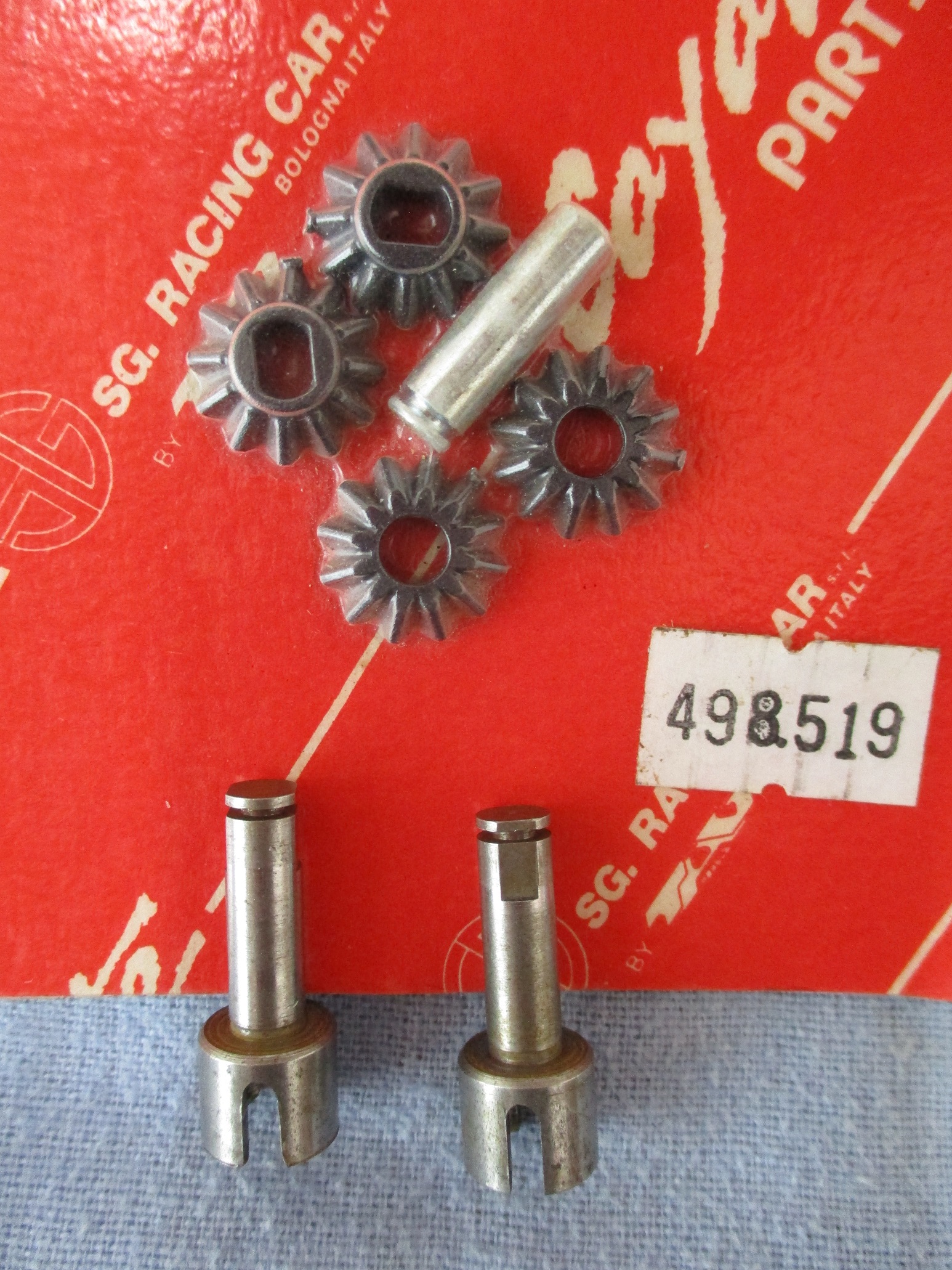

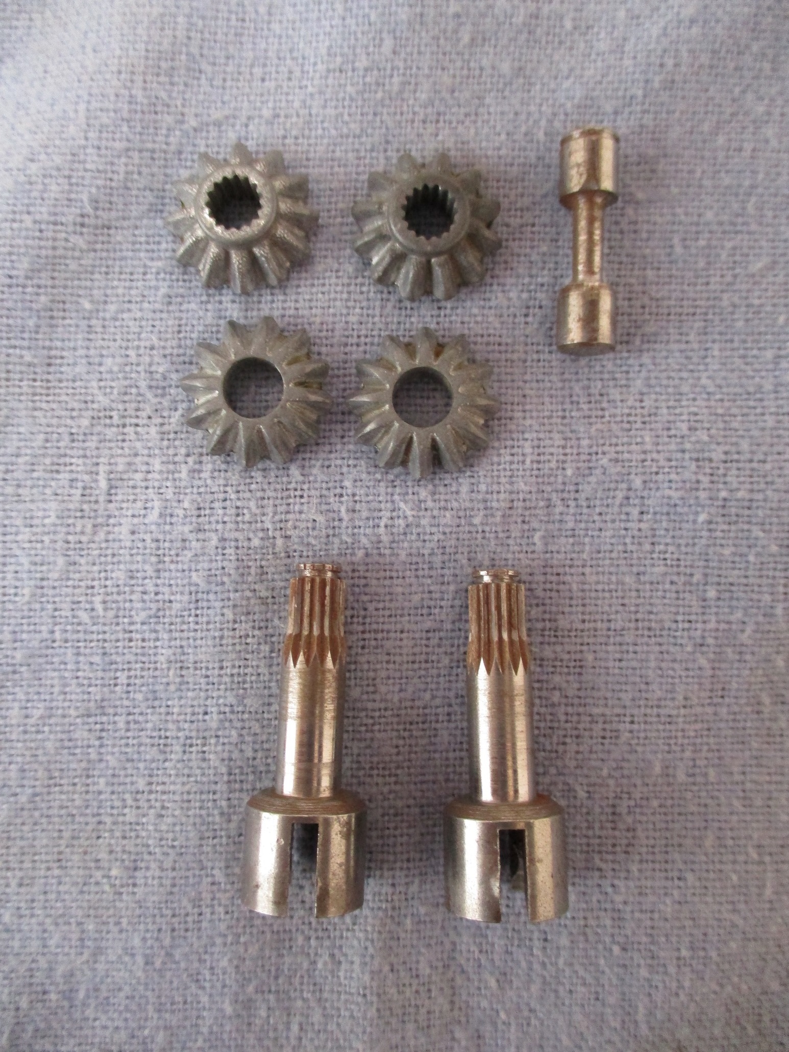

Re: SG Coyote differences
I thought I'd add more about the diff gears and output shafts. I've included the TAG Pro 10 versions here as they're interchangeable with the Coyote.
Early Coyote. Plastic internal gears. The output shafts are silver and have two flats machined into them to engage the gears and a rounded end in the drivecup slot. The spider gears spin on the round steel shaft. The gears have fairly large teeth. Later Coyote. Hardened steel gears. The output shafts have a hard black coating (which is partially worn in this shot) and still use the two flats to engage the gears. The drivecups have a square ended slot. The spider gear shaft is the same. Note the finer teeth. Pro 10. Cast metal gears, non-ferrous. The chromed output shafts are slightly longer than the Coyote's and splined to engage the gears. The spider gear shaft is machined down in the middle to accommodate the longer output shafts. Note the larger teeth. There are two different versions of the Pro 10 output shafts. The ones I have are the optional lightweight hotup versions from TAG. The stock versions are not chromed and presumably slightly heavier.

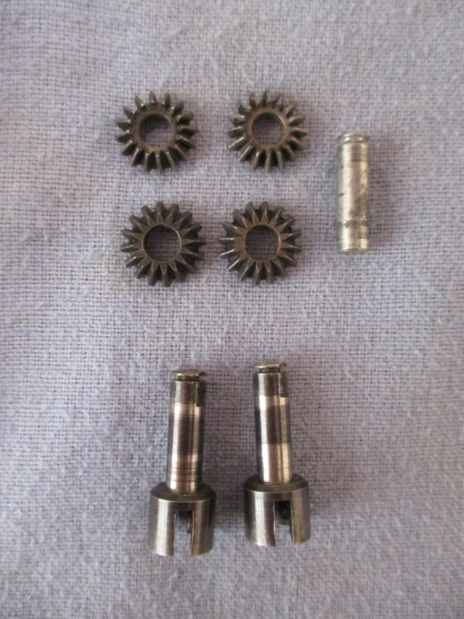

Great breakdown of these gears! The cast/pot metal ones have been a curiosity for me..like the similar ring gear. The ones I have are cast a bit rough with flash, so they would need some file work to be smooth.
I will add this 4th version.. Hardened steel gears but 12 tooth like the plastic & cast…Silver outdrives. Notice how shallow the flat spots are, it’s hard to see and the shaft only measures 4.9mm across there. These came off of a used fwd Coyote.

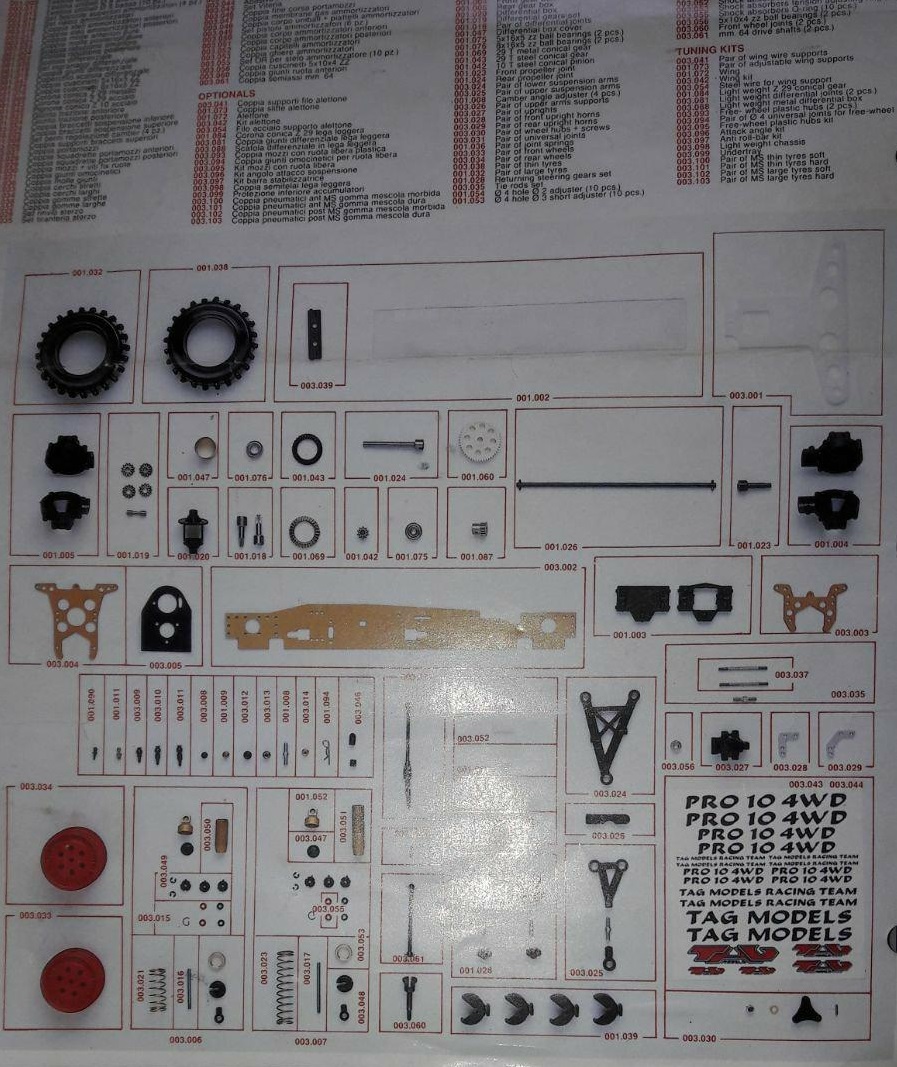

I'd say so. My best guess would be that they went to all the trouble to lower the weight of the diff gears. Which sounds weird but when you look at the optional parts list there's three lightweight diff options on it. I've copied (stolen)Dadio wrote: ↑Sun Jan 29, 2023 4:05 am It's odd that Tag opted to go to die cast alloy for the latest version , an investment to make the moulds but cheaper in the long run ? I'd have thought they would stick to the steel ones as the cost of machining new moulds and redesigning the splined output shafts must have been quite high ?
I would like to see the lightweight chassis option. How could you make the chassis rails any lighter without sacrificing chassis strength? Thinner material? They'd bend even quicker.

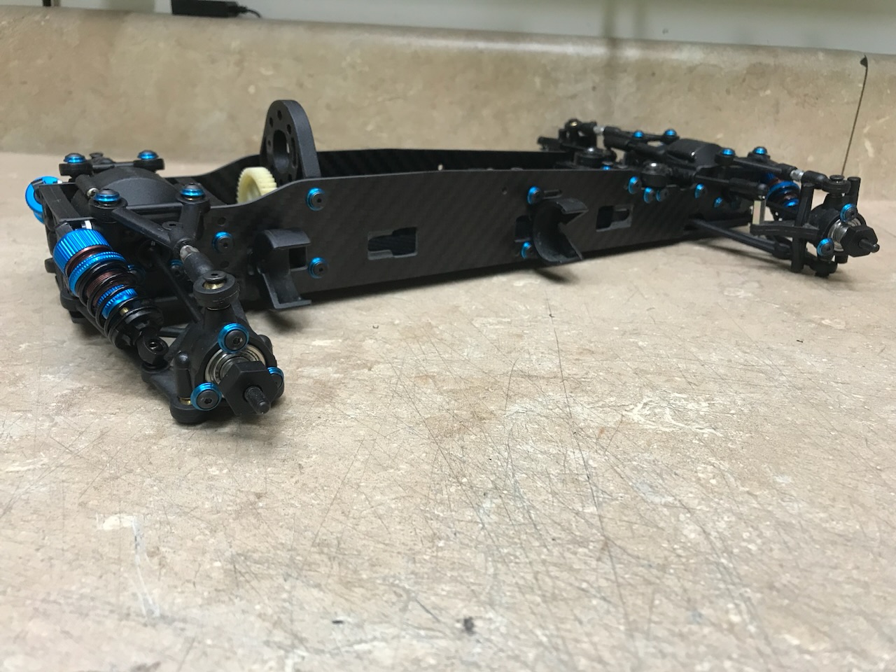

A friend in Hong Kong commissioned this one. I don’t recall the specifics of the chassis, but I believe the 3 cell was able to be shifted fore or aft for balance, or you could use the outer holes for the fourth cell. I’d have to look at the drawing and see for sure but that’s what I recall.
