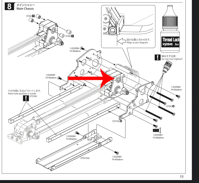

Am I crazy or is this exploded view different from my manual, in that there's TWO OT225b spacers instead of the ONE ??!

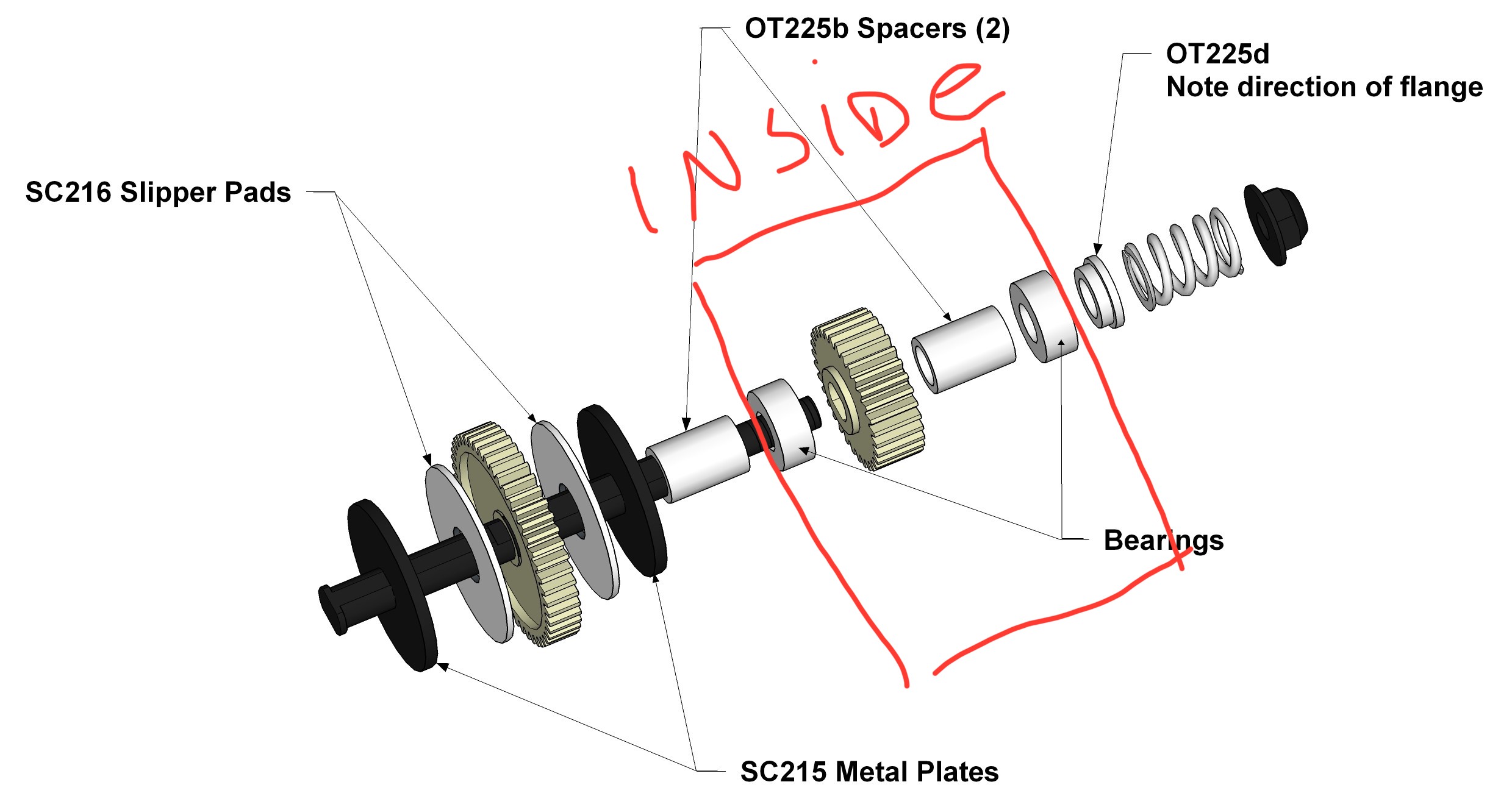

Re: Turbo Optima Re-Re Transmission
the other spacer is installed inside the trans case in a previous step along with the gear, so it would not be shown in that step. You must have both spacers!

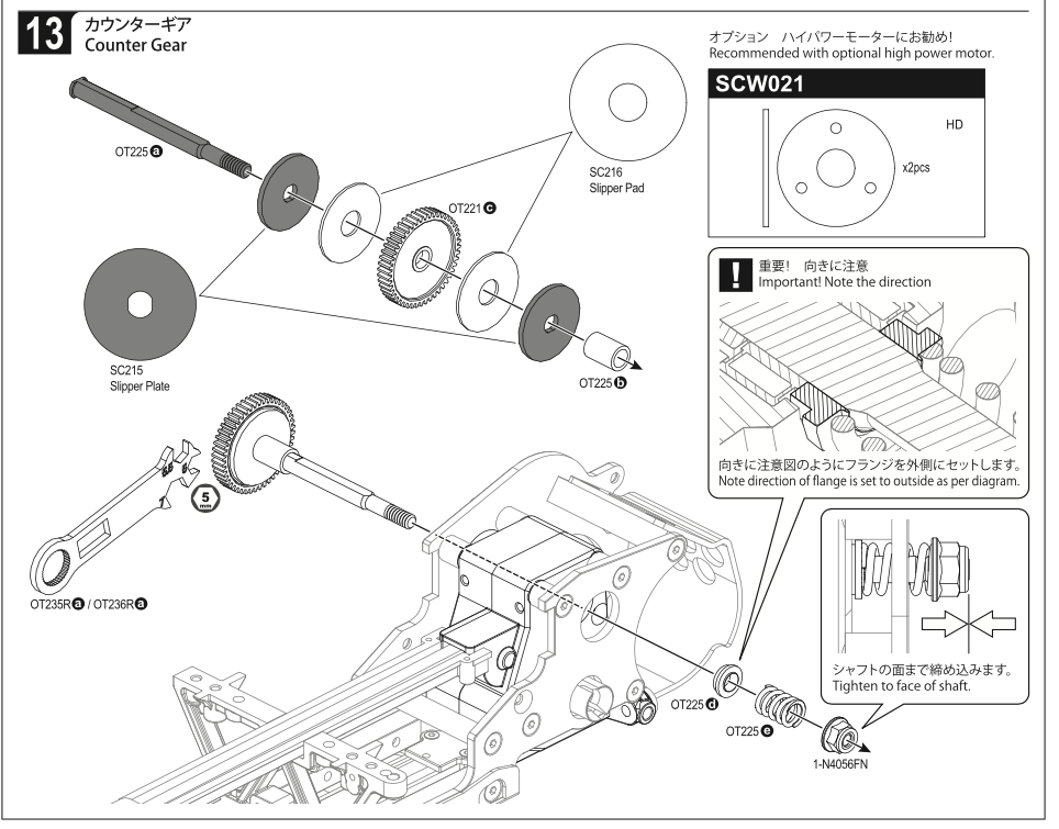

Right; I see, from step #4... I haven't tore open the gear boxes, but would the diffs & belt drive able to rotate/move smoothly by hand or rolling if I'd forgotten that spacer somehow? It'd also be in my 'extra' bin...and I don't think I lost it. Crap. I thought I had a possibility there. It does sound like a slipper clutch issue, but tightening it all the way doesn't help. Should that spring be rotating in the opposite direction of the wheels? I did have to reverse channel 2 to get FWRD/REV correct from the transmitter...
The spacer only comes into play when you tighten the slipper, which is exactly what you are describing. The drivetrain would be free with or without that spacer so long as the slipper is left very loose. When tightened, since there would be no spacer, it would bind up
Yes, the entire slipper clutch/gear/shaft/spring assembly rotates opposite the direction of the wheels.
Unfortunately, it appears that you've missed installing one of those OT225b spacers when you assembled the slipper shaft assembly and this is why you're not able to tighten the slipper sufficiently to drive the car.

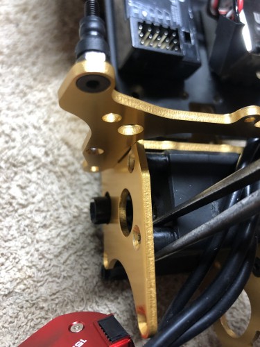

I've already torn most of it apart...so I guess I may as well keep going. Though now I'm really struggling to keep the OT202 thingies from moving so I can remove the long screws... can't even apply enough force with the needle nose to keep it steady. There might also be some thread-lock in there gumming things up.
Worst. Build. Ever. I don't think I'll ever get the rear stabilizer bar on there either with that tiny nut either. If I can manage to get it apart & can't find anything wrong in the rear gearbox, I will cobble back together whatever I can & ship it off if I don't smash it into pieces out of rage before then.- Coelacanth
Aren't those tiny nuts captured inside plastic hex holes in the mounting pieces? I never had problems assembling the rear stabilizers. Press the nuts inside the plastic mounts and install the screws.sundevil67 wrote: ↑Thu Dec 24, 2020 3:23 pm Worst. Build. Ever. I don't think I'll ever get the rear stabilizer bar on there either with that tiny nut either. If I can manage to get it apart & can't find anything wrong in the rear gearbox, I will cobble back together whatever I can & ship it off if I don't smash it into pieces out of rage before then.
https://www.youtube.com/watch?v=i0bxA_C_tkA
I'm also not understanding the difficulty with removing the long gearbox screws. Those OT202's are nothing but spacers from the looks of it. Won't the screws simply pull straight out once they're unscrewed out of the opposite gearbox side-plate? The original design had these spacers molded into the gearbox shape itself, the only threaded part is in the opposite gearbox plate.
Yup the screws come right out, the most I’ve ever had to do was to use a paper clip through the motor plate holes to push the screws a little so I could grab em. The spacers are not threaded so there should be no need to hold them with pliers at all
Wow, this is a serious head-scratcher.sundevil67 wrote: ↑Thu Dec 24, 2020 7:43 pm I did manage to pull apart the rear gearbox, and just like I feared, it's all correct, spacer & all.
Now that it's apart, maybe you could assemble the entire slipper assembly outside the car (from plates to nut - the whole thing) and confirm that you can tighten the nut against the spring sufficiently to lock the big gear so that it can't spin on the shaft?
If the slipper assembly is working correctly, it should not be easy to spin the big gear with one hand while holding the small gear with the other after the nut is tightened.
