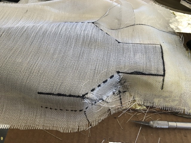

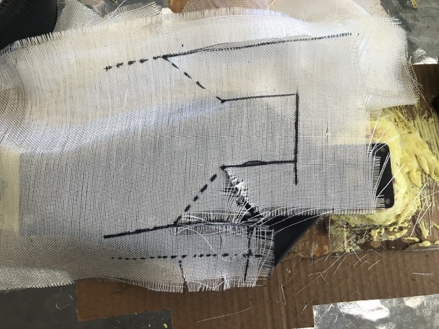

Getting back to it. Since I know now that I will have to bag the part I decided to test laying the material and bagging. So no resin for this attempt.
Now this that is glued to a board I can tack down the fabric as I test relief cuts.

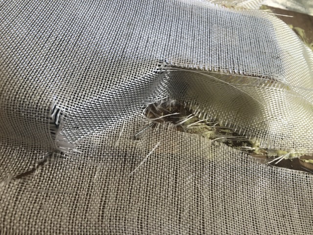

The front of the chassis is pretty straight forward. Looking at the top there aren’t wrinkles that need to be worked out.
The rear is another story. There are 2 main pain points. The first is the chassis angle as it plunges towards the bulkhead. The angle is sharp enough all on it’s own to wrinkle. The next is the location of the bulkhead support. It’s just all sorts of trouble.
I am trying a variety of cuts to see what gets the best coverage. There are a lot of different ways to try and I don’t think it’s too critical for the mold as long as I have enough support. I think that I will have the exact same problems when molding the part so I am trying to come up with something that looks ok.

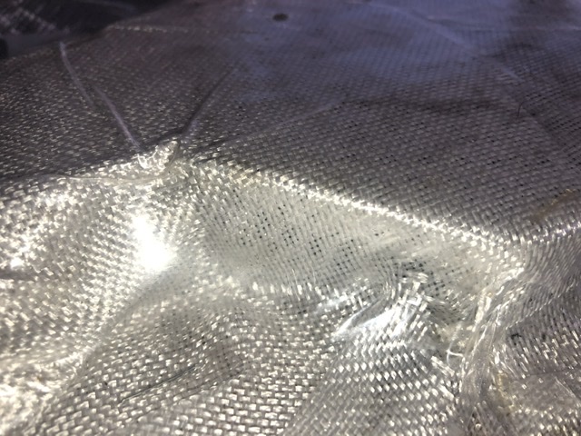

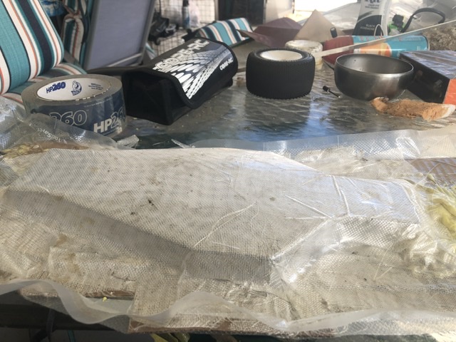

Now that it’s tacked up I can put it in a bag and see how well it handles vacuum .
I am glad I went through this with no resin first.

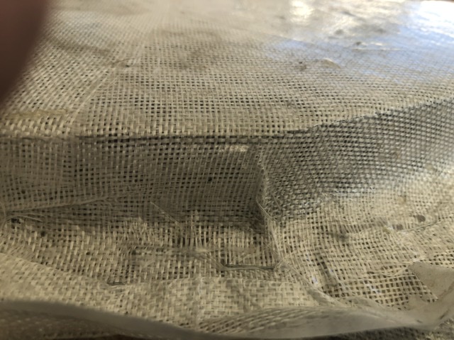

This showed some problems i didn’t know I had. Wrinkles and voids are bad.
Even the front of the chassis will need some relief cuts. There is a corner wrinkle.
The bag is not big enough for the the project with the board attached. There isn’t enough material for it to full draw down around the rear bulkhead support.
The force of the vacuum is enough to bend down the rear plate.
Since I am not using a real vacuum system I am also now worried that the speed is to fast for working out the bag.
I have a larger bag that I will try. Unfortunately it is finicky to seal properly.
I can add some relief cuts to the front seams.
I can try to pull the vacuum slower and hope it still is enough to get a good fit for the mold.

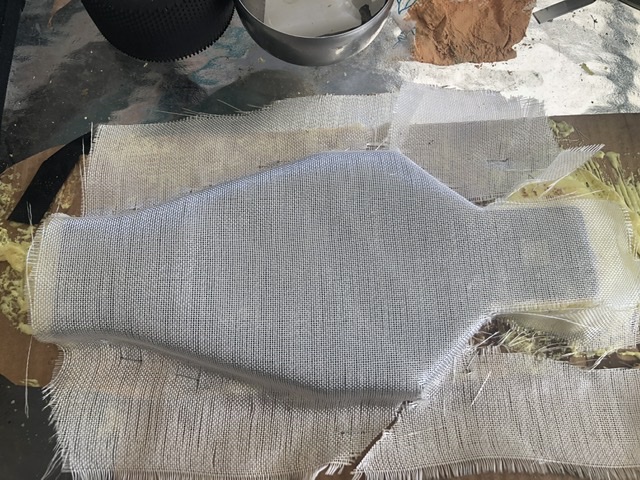

Thought of a different way to slice up the cloth.
This one cuts a straight strip out along the widest point in the chassis and tries to wrap it straight back. The rest of the material is cut out and folded over.
I don’t feel like I have enough coverage on the bulkhead mounting tab since the folded cloth goes over the last angle of the chassis. Still this seems like it’s worth trying. I may try 2 alternating patterns to build up support in the corners.

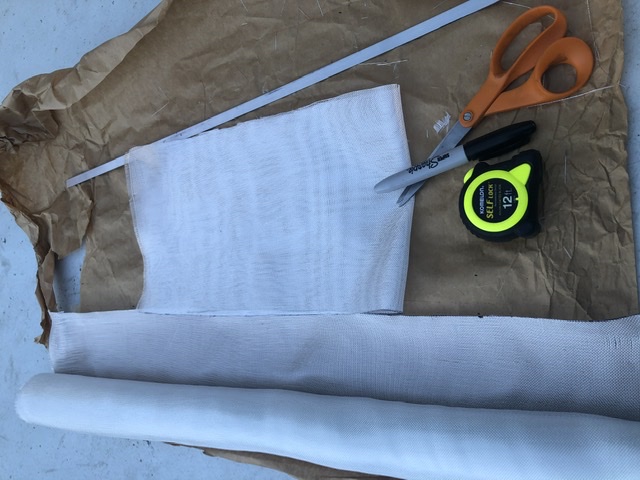

Cutting fabric is a skill.
Unrolling the fabric without disturbing the weave is challenging. For this step it’s not critical, but I want to attempt to have a good weave for a final chassis.
What seemed to work best was to pick up the roll, then unwind the width I needed. Pulling on the edge makes a wave I can’t smooth out.
Even with unrolling there was a wave in the edge that was just cut straight. I may need to watch some sewing videos.

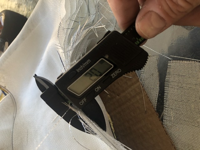

Each layer of fiber is about .1mm I piled up 19layers to get 2.0 mm. I’ll have to measure again after the resin is applied to see if any appreciable thickness is added.
I think I will have to cut the pieces to pattern one at a time. The thickness of fabric is enough to displace the bends in the fabric if I cut them all the same.

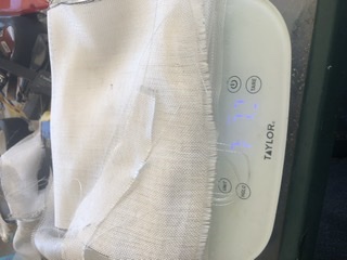

Had a bit of insomnia so started looking ar resin to fiberglass cloth ratios. Most of what I found was for epoxy, but I’ll assume the polestar resin will be similar.
To get a wet out and a coat it seems to be that the ratio is between 2 -2.5 oz of resin per oz of cloth.
This should be enough For wet out and a coat.
The scale is reading about v2 7oz so that would be a 14-18 oz of resin which is a whole lot of resin to work with.
