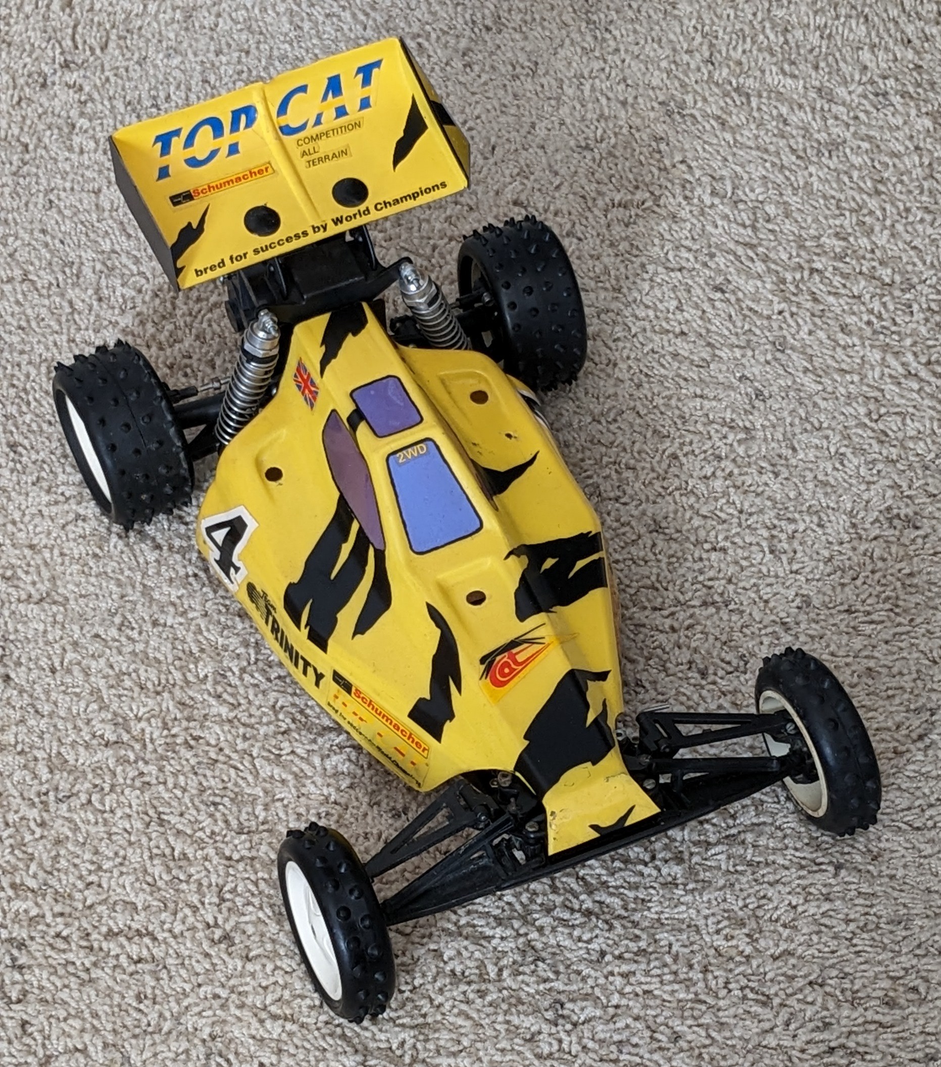

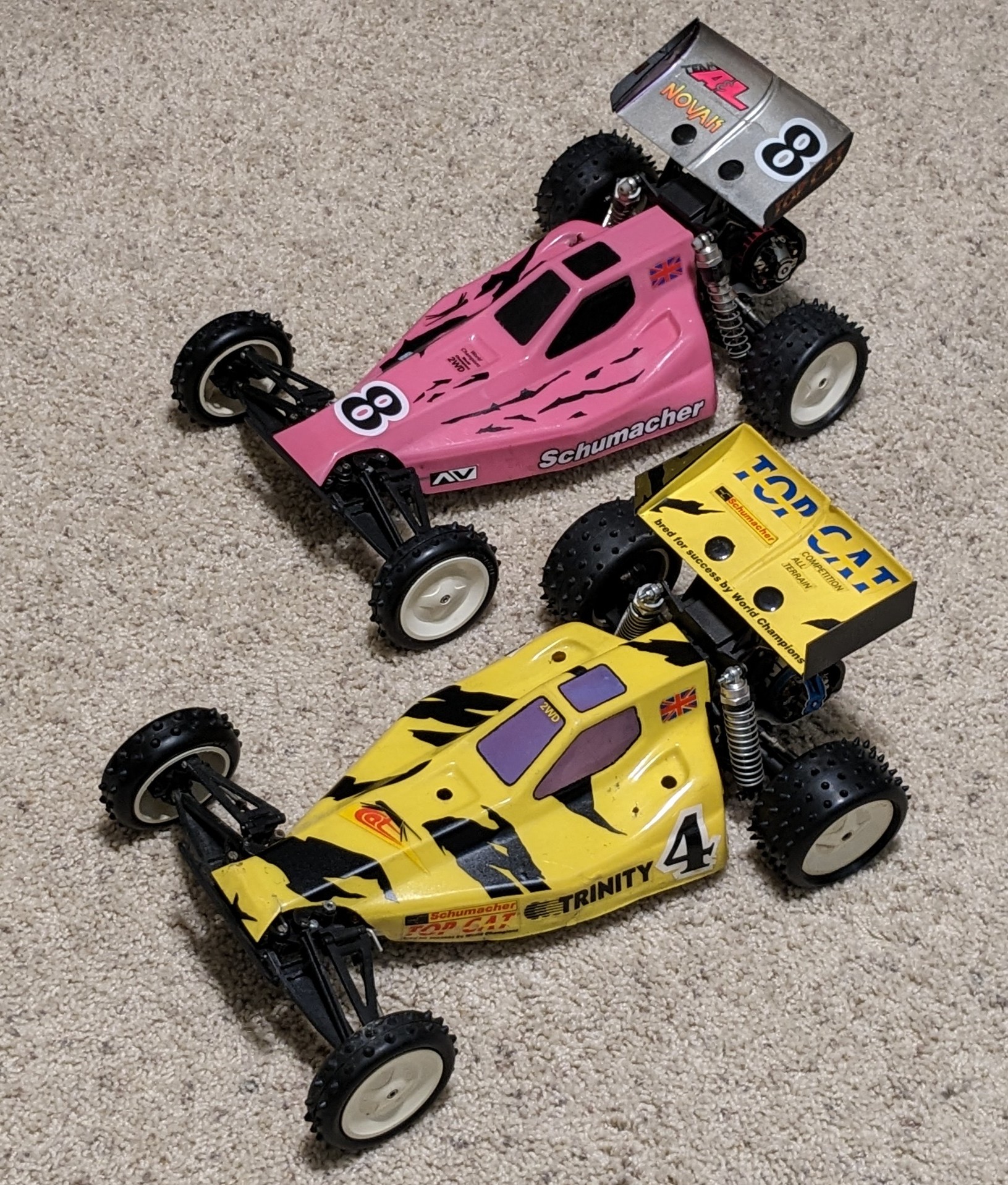

Unexpectedly, Pinky's litter mate came available. I really wasn't looking to get a 2nd Top Cat, but thought I should take it in on the off chance that I need one because there's a sudden Schumacher apocalypse. Apparently not everyone is drawn to the extreme level of weirdness that the Top Cat has, and that's ok.
After a little sticker work the yeller one came out looking presentable enough for my standards. It also got a Speed Gems Sapphire added to plug the hole. Not quite the flamethrower that Pinky has (*narf!*) but I didn't order a pro transmission upgrade for the yeller one that I didn't own at the time of ordering.

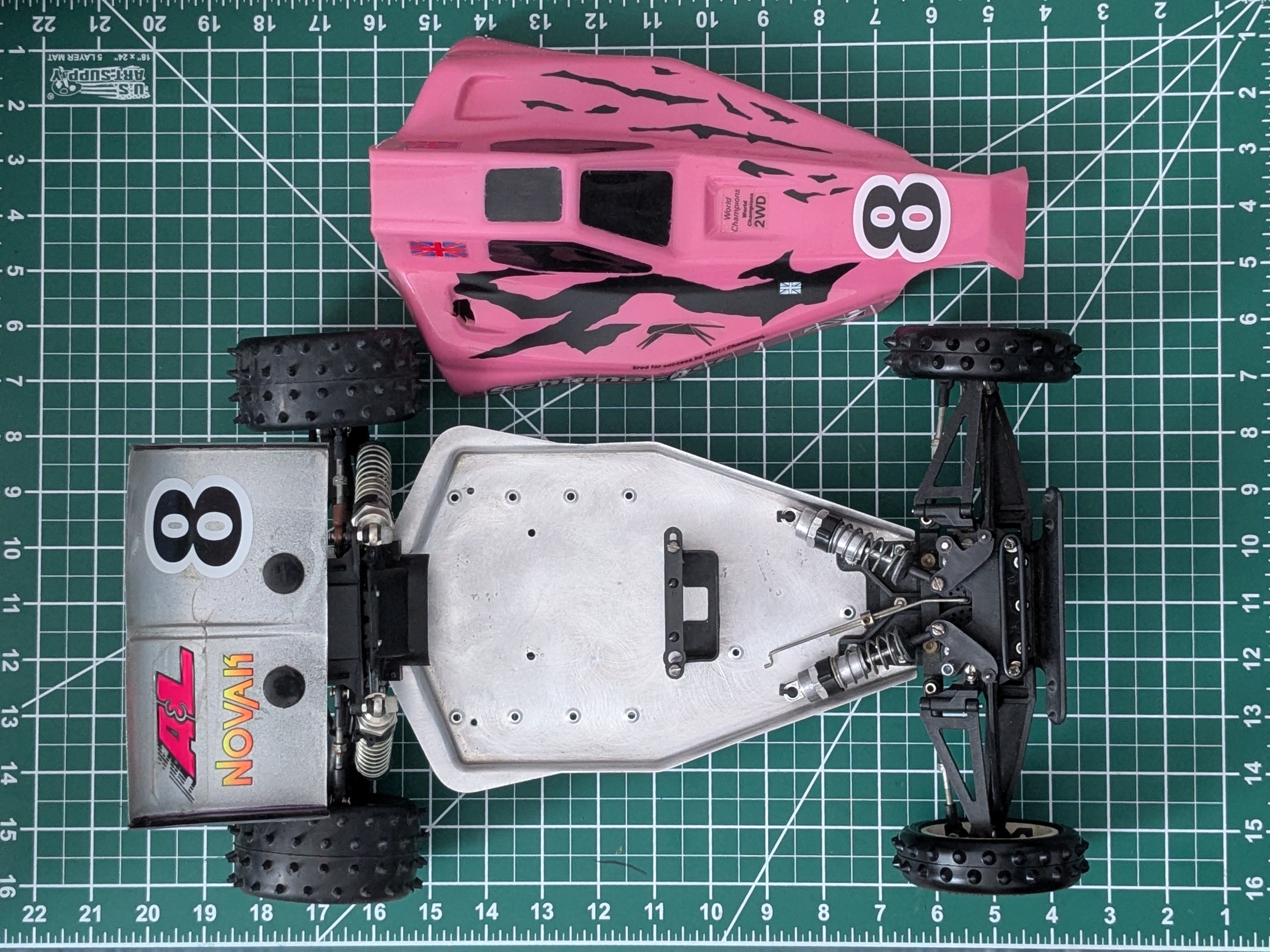

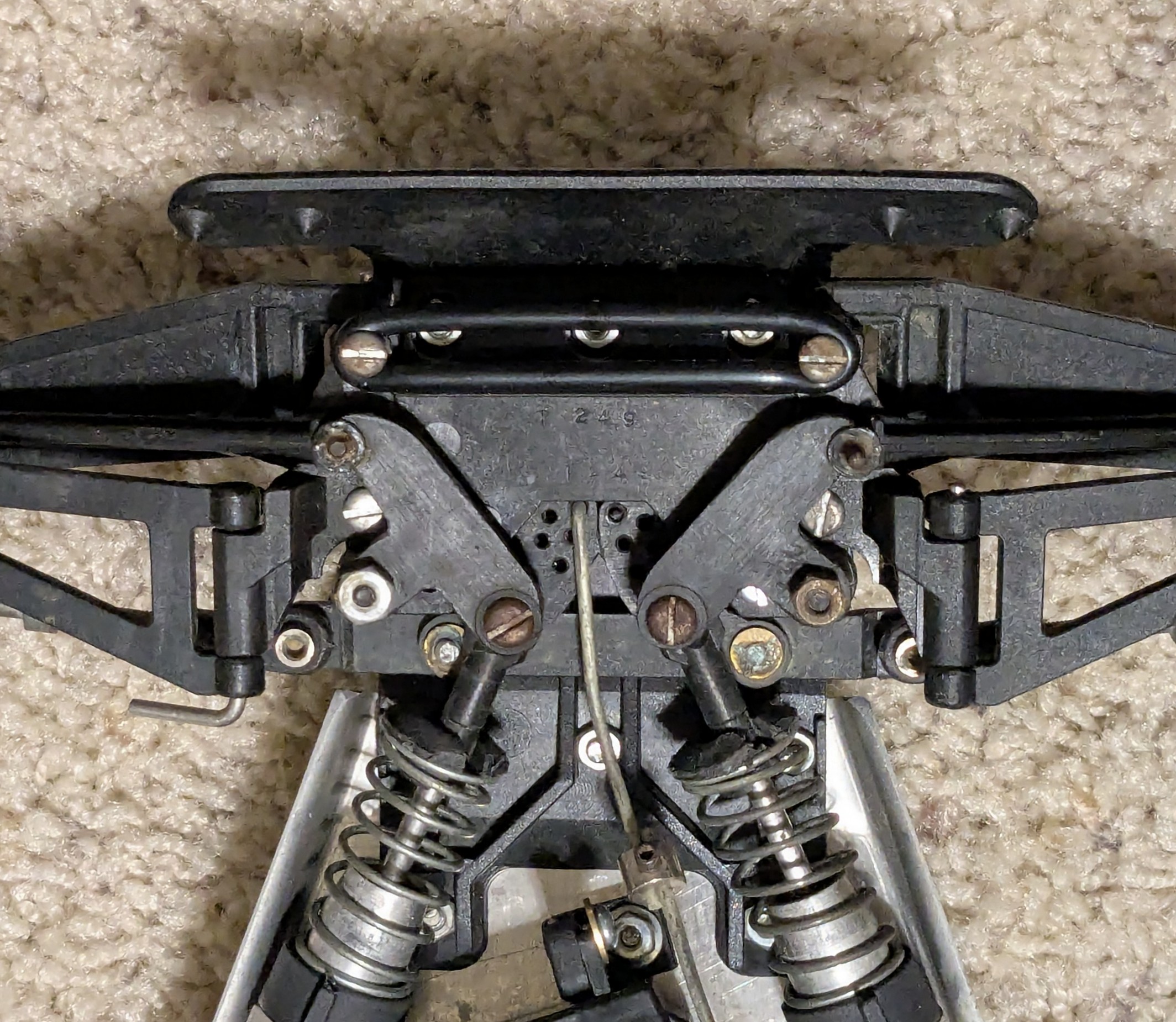

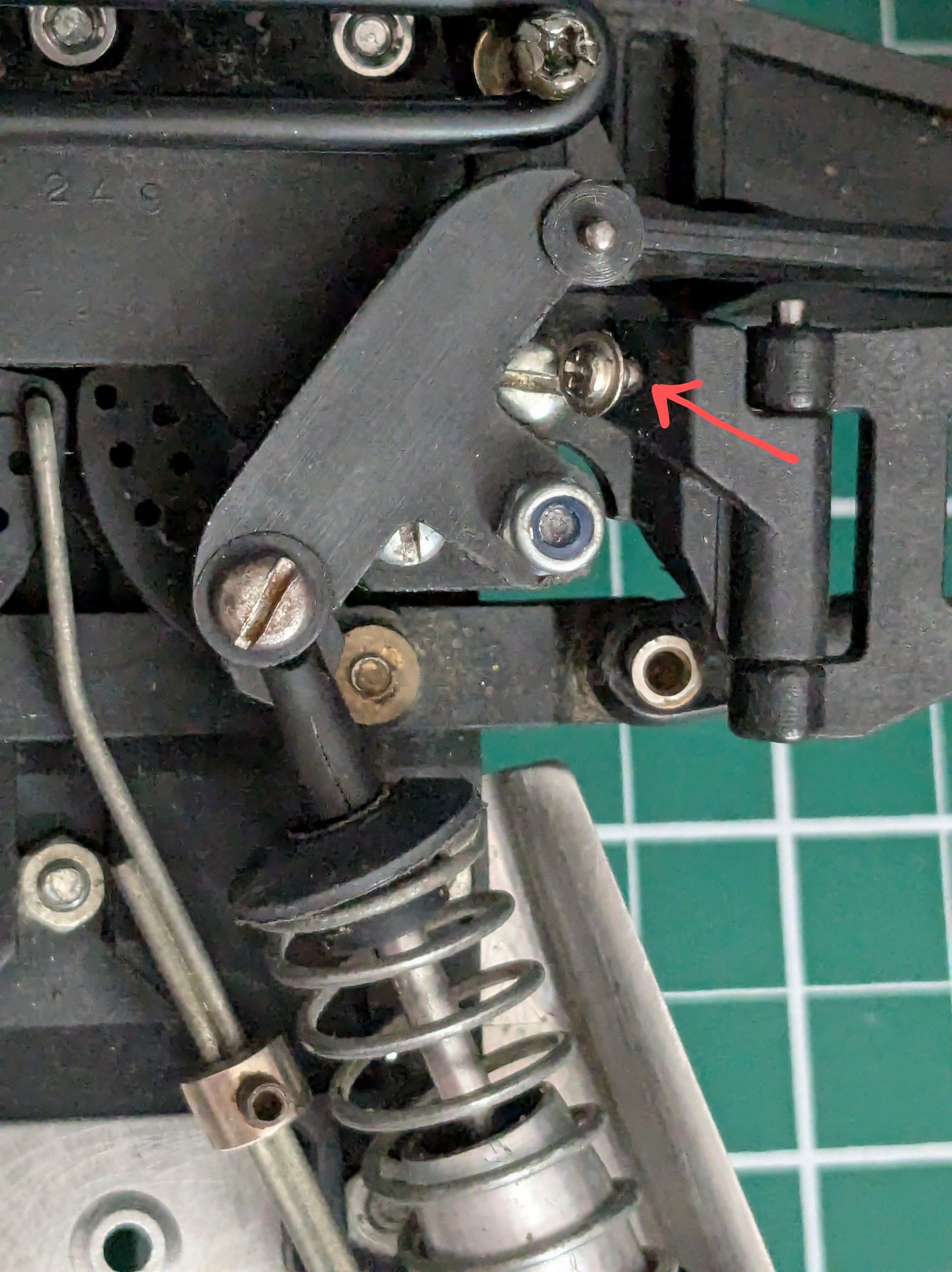

I was looking over the pink one for some future plans and noticed an odd random looking screw in the front. Assuming this was done with some sort of purpose, does anyone have any thoughts why? Only the right side has this screw and the yellow TC doesn't have this mod.

I think it is a droop limiter. There is a flat on the underside of the upper A-arm. It looks as though the end of that screw would would contact the flat. I don't know why it would be on only one side unless the previous owner was just adjusting the right side to mimic the left, or maybe using it to set ride height. My TC has dimples in that spot to indicate where to drill., so this must have been intended as an optional tuning aid.
Curiously, your A-arm mount is different than mine. Mine has support ridges on either side of the mystery screw head.

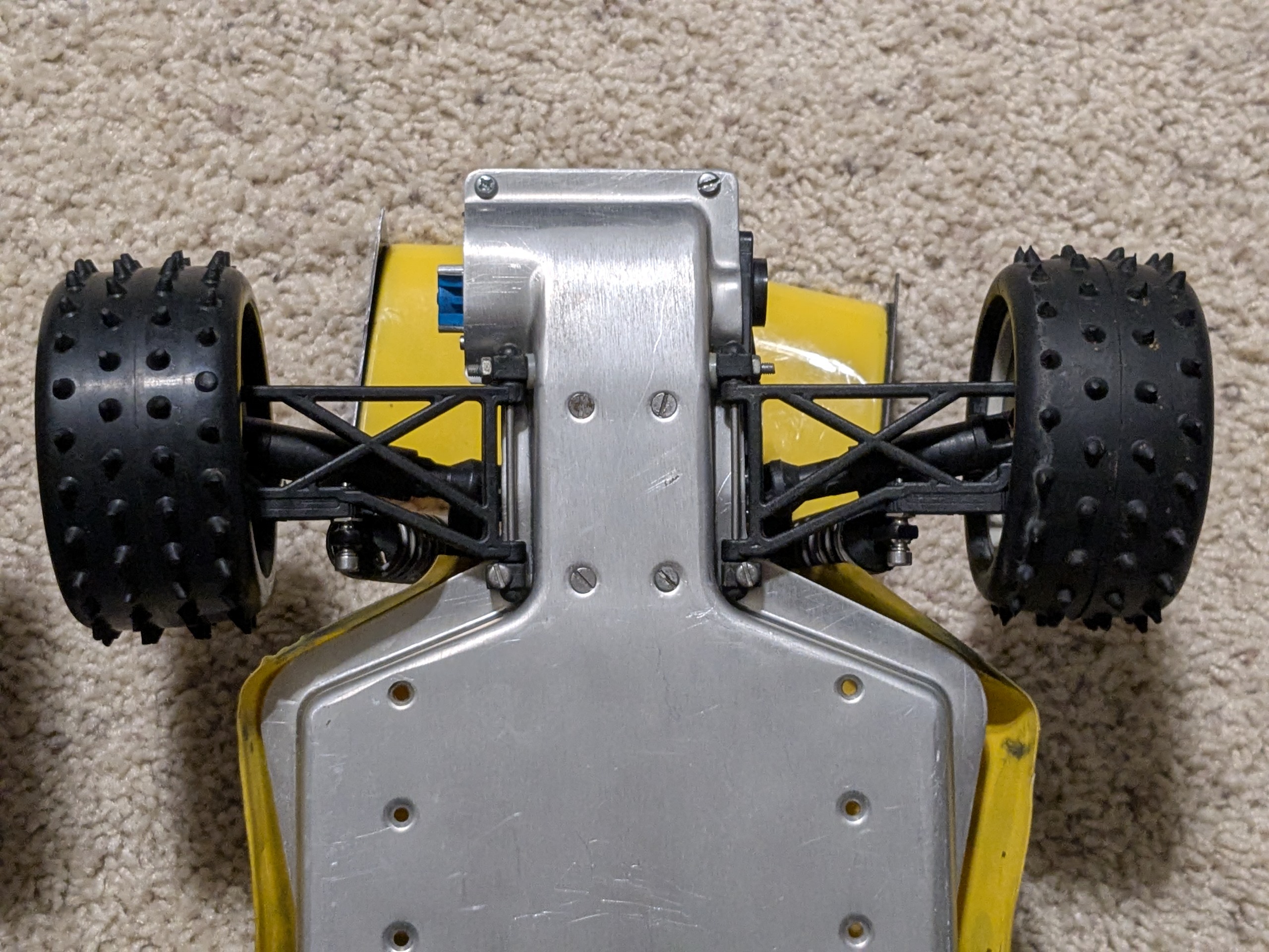

Neither of my TCs have that extra support. This is my yellow TC.

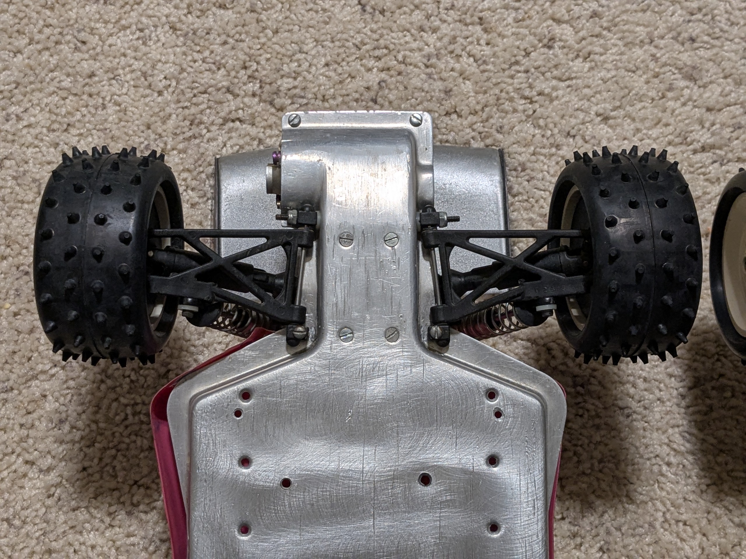

The pink TC also has a curious rear suspension alignment. Both buggies came from the same original owner.

That looks like a hasty assembly mistake. I wonder if the car was apart and the PO put it back together quickly to sell. The front arm mounts are on backwards. Easy fix. I can't think of a reason to do that on purpose. It could be done to widen the track, but extra spacers would be needed in the back to straighten the arm.
Regarding the front arm mounts, I suspect yours are from an earlier production run. Maybe some broke or flexed too much, so they added the supports later? On the other hand, the rear support sits very close to the rocker pivot, so maybe they removed the support to gain clearance. :lol:

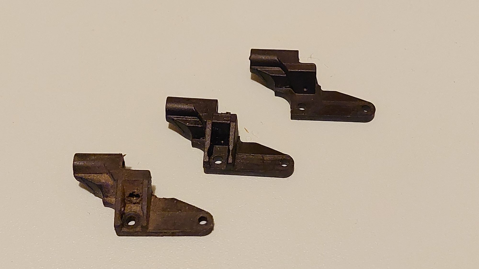

Just to back the statement on the suspension arms (T213 and T214, left and right). They were upgraded with extra support.
Like 1911Colt describes, the dimples were there to indicate where to drill holes for down stop screws.
As seen, this is even written in the original manual under "Track settings".
Posting a picture of the two versions of the original suspension arms, and the later version with a hole for the down stop screw.
