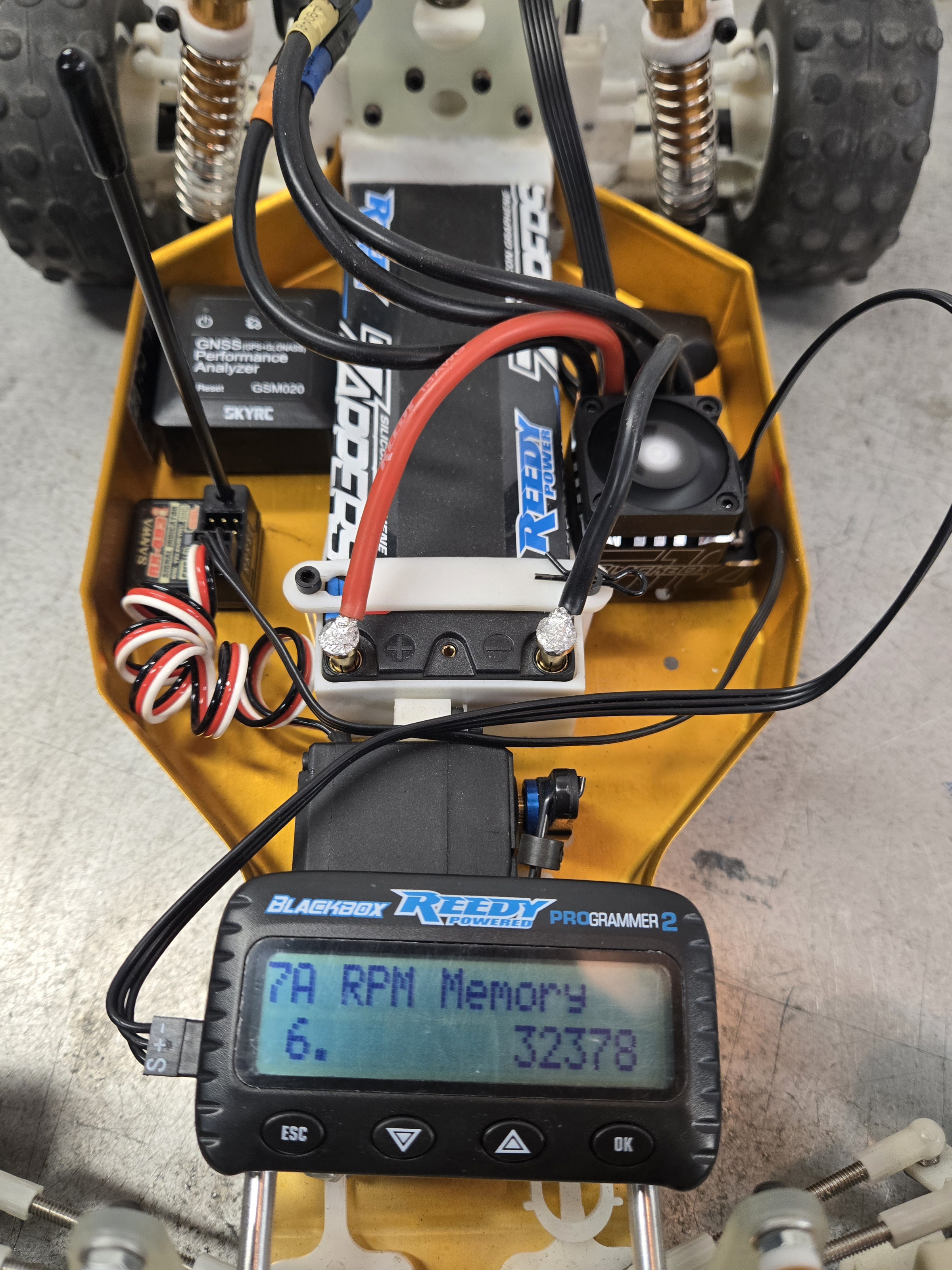

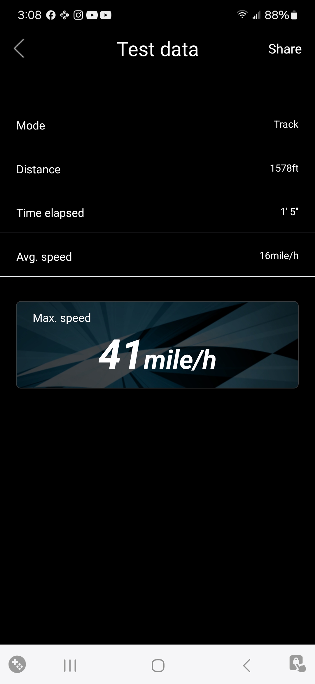

OK now I'm trippin. Not going to repost duplicate pics, but you can see my programmer recorded a max RPM of 33,670 when my GPS logged 35mph.
Yesterday GPS got me at 37mph after I added 5° turbo timing. Buuuuutttt.....my programmer shows that my 37mph pass max RPM was 32,378.
Make it make sense lol.
Timing, gearing, rpm, traction, slipper, pinion.....how did 1300 less rpm gain 2mph via a timing adjustment..

Could be traction, diff slippage, tires ballooning, or just simple deviation with the electronics.Stevothehoe wrote: ↑Tue Jan 21, 2025 9:28 pm Timing, gearing, rpm, traction, slipper, pinion.....how did 1300 less rpm gain 2mph via a timing adjustment..
Let's be honest, we are talking about hobby grade (probably Chinese made) electronics, not NASA instruments.

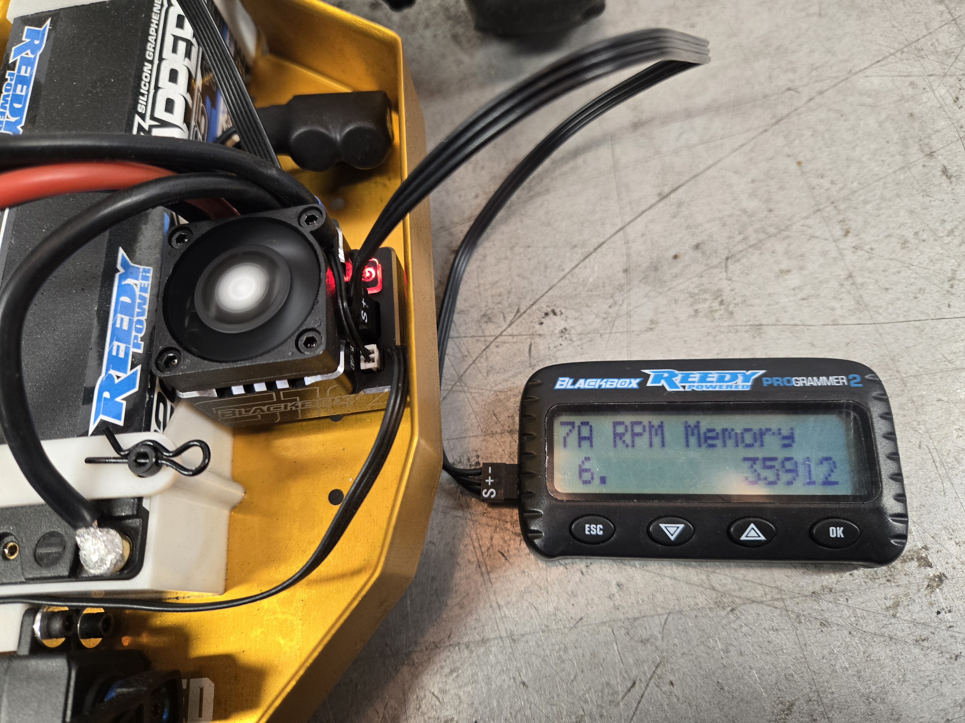

Well it's official. The 40th hit 40. Bumped the turbo timing to 7° and added only 3° boost timing. The electronics are still new to me so baby steps. Damn near 36,000 RPM. Still drives like a dream. Smooth as silk. (Not pictured: 108° motor temp)
Thanks for the tips and comments and for playing along with me!

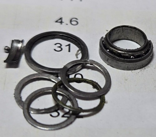

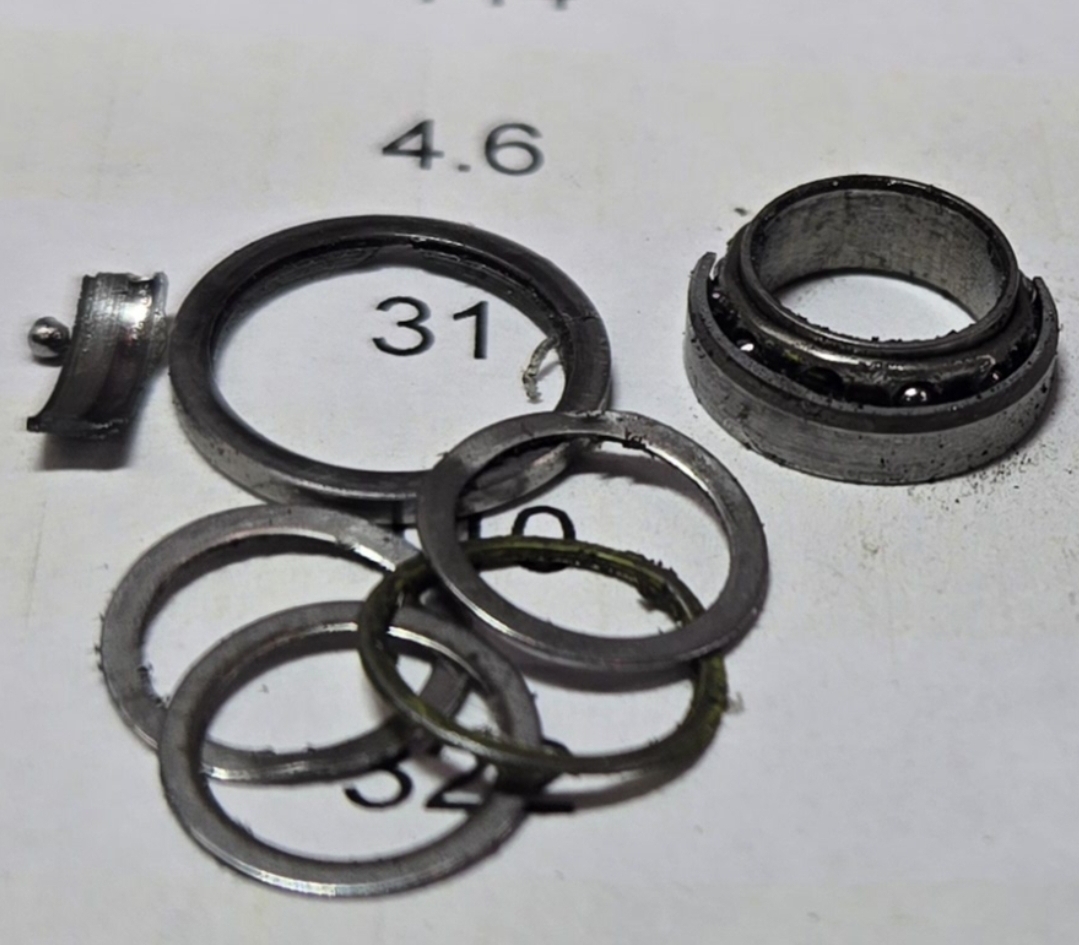

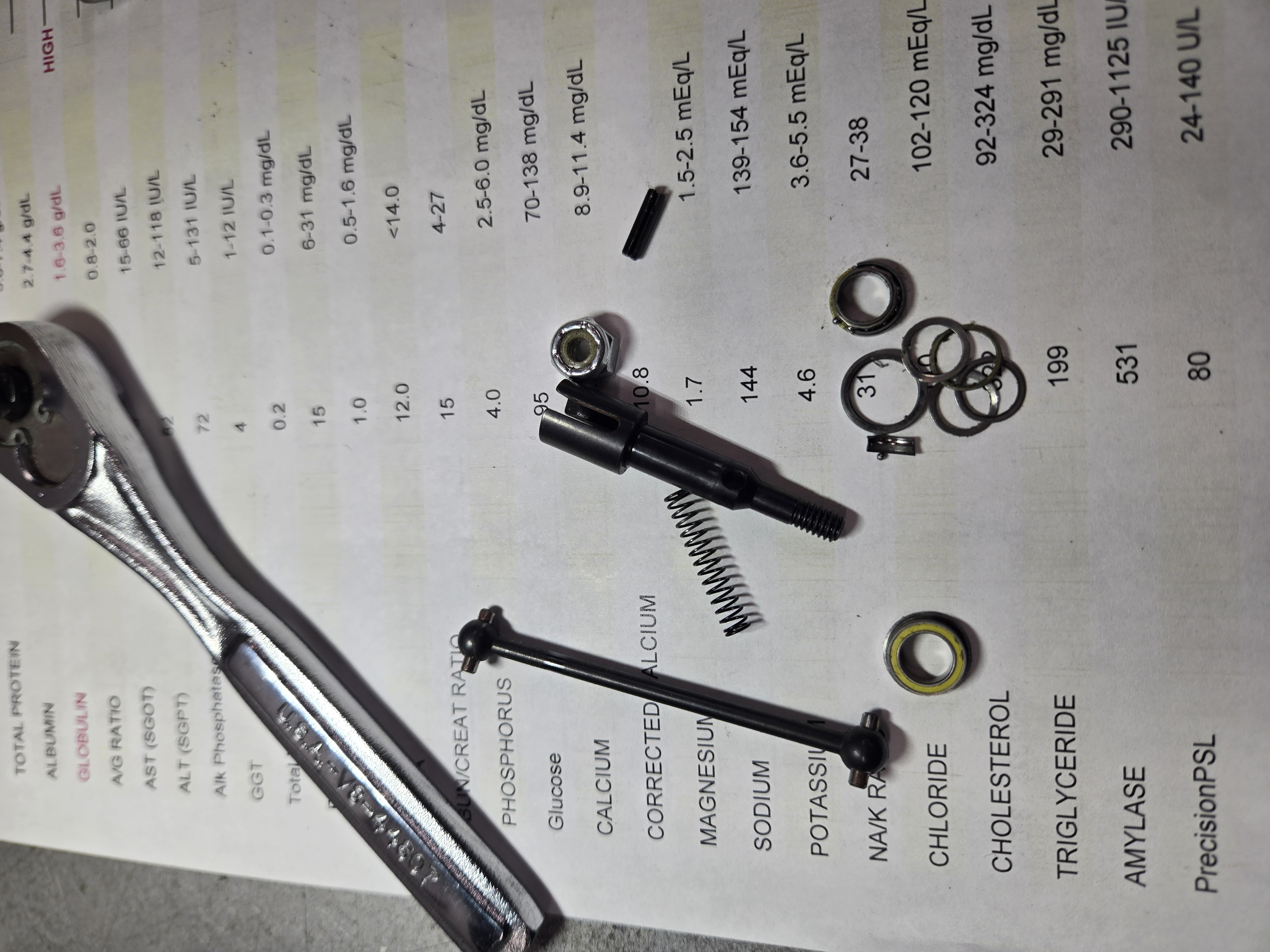

Buuut my right rear wheel was wobbling and i thought maybe the nut was loose. Nope....Anyone have any idea why my right rear wheel bearing would just disintegrate? I was always under the impression that bearings were an 'upgrade' from stock bushings. I'm pretty sure they were installed correctly. Left rear feels a little loose but I haven't pulled it apart yet. Possibly defective? Cornering or braking too hard at these speeds?
Should I be worried about the bearings in the tranny next? Going to put the stock bushings in and see what happens.
I used an ACER RACING bearing kit from a-main for what it's worth.

The bearings in the rear hubs aren't particularly robust. When you assemble it make sure there is just a little bit of end play (in/out) which will help with their longevity. Unfortunately the bearings will still require frequent cleaning and oiling if you want them to last.

How is play adjustable? Seems they just push in, put the spring, dogbone, shims and pin in and done.

Because of their smaller roller sizing, the bearings for 1/4" rear axles are not as durable as the bearings for the later 3/16" rear axles. Also, bearings being run that hard probably need frequent re-lubrication to keep them cool-ish for high speed runs.
Bronze bushings wear out too. They aren't perfect. They lose the oil in them, they lose material due to rub and get to be a sloppier fit. They also eventually wear grooves in the steel axles and ruin the axles. They aren't perfect, just different wear to keep track of.

You might want to write acer and see if they will just send you a replacement. 40 mph isn't exactly top end for a modern rc.The bearings should have survived.Stevothehoe wrote: ↑Sat Feb 08, 2025 11:48 pm *not electronics related but prolly not worth a new thread.

Any pre load/side load without a crush sleeve will drastically reduce their life.
Try without the conical washer and see if there is a bit of end float. If so flatten the washer or use a 1/4" pan car axle shim so when the wheel is tight there is the slightest bit of play. Also when everything gets hot it will expand slightly.
Edit, if the 40th uses 1/4" shims remove one or more until perfect
