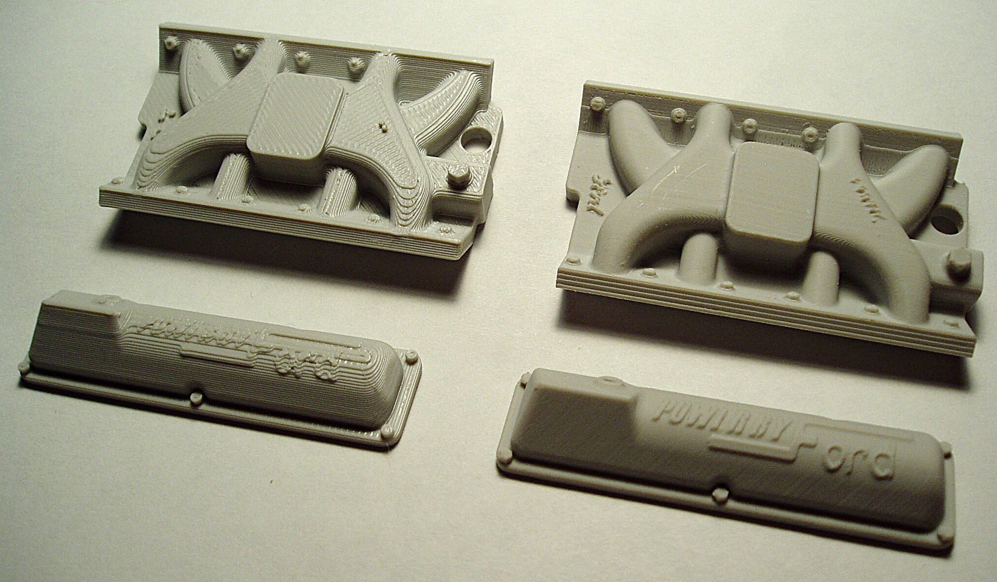

... and unfortunately, I'll continue to derail this thread. :lol:
The F100 pickup is only my second RC project using a printer so I'm still learning.
One feature in Bambu Studio that I've started using with this project is adaptive layers.
Parts on the left were printed with uniform layer heights (0.2) and were laying flat to the build plate.
Those on the right were printed using the adaptive layers (0.06 min) and smooth features and were angled from the plate.
It's a substantial improvement so I've been going back and re-printing some parts.
