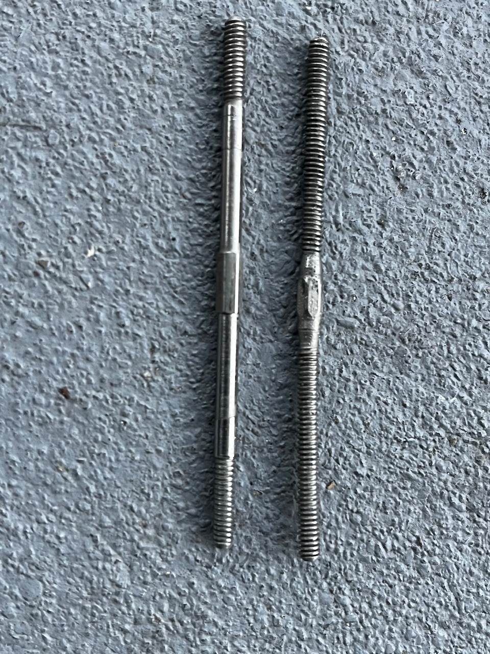

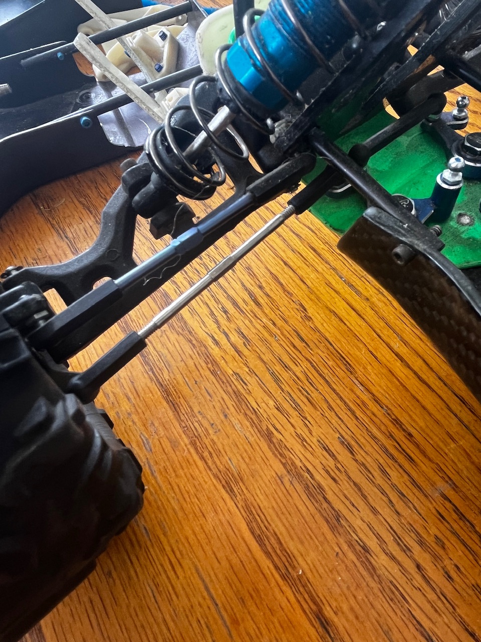

Hard to tell from the pic but it looks like smut on the turnbuckle around the hex? If it is, it should polish out. If it's poor nickel adhesion then toilet bowl cleaner (hydrochloric acid) will strip the nickel so you can re-plate it.

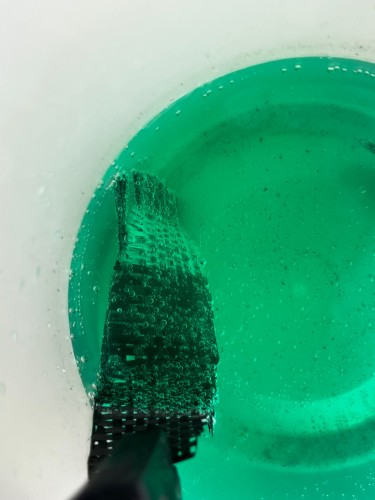

So over night I the pieces were out of the tank. Any place not sufficiently coated flash rusted, so on the first piece the threads were where I saw rust, on the second piece most of it flashed over.
Didn’t take pictures, but they are soaking in the rust restoration now.

Dangeruss wrote: Sun May 25, 2025 6:08 am Hard to tell from the pic but it looks like smut on the turnbuckle around the hex? If it is, it should polish out. If it's poor nickel adhesion then toilet bowl cleaner (hydrochloric acid) will strip the nickel so you can re-plate it.
I’ll double check, on the first piece it seems good except the threads, the second one was taken out of the bath because I had to leave , not because it was done.
I didn’t see any smut. Still I have to de-rust the parts and I was going to etch them in muric acid before the next coat.
I’ll see if I can get a few hours to let this run.

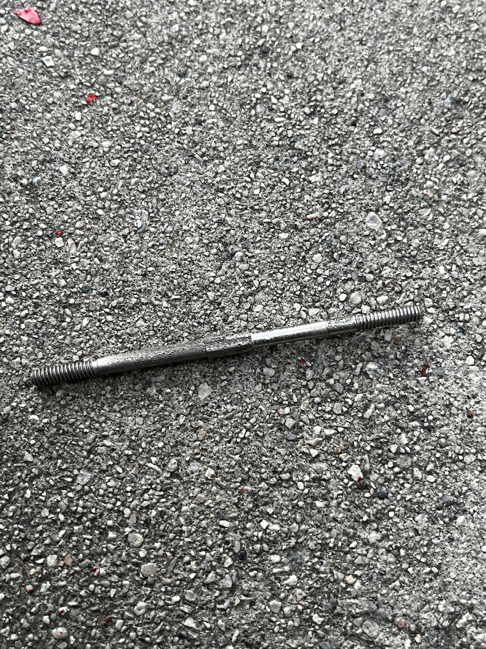

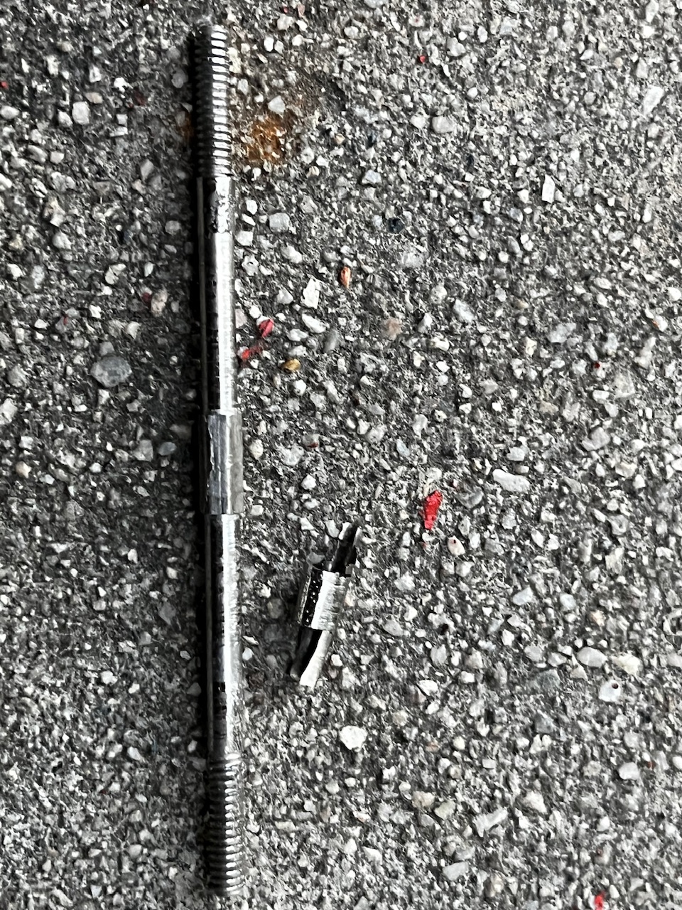

Some result

JosephS wrote: Sun May 25, 2025 5:01 pm I can’t imagine it would be less expensive to get these professionally done that it would be to just buy new ones.
Yeah, but sometimes there's more fun in the journey than the destination, anyone can buy anything, but how many people can make something from nothing. :wink:
The left one on the first pic looks like it polished out nice.
...last one funnily enough looks like it was pretty rough before it went in.
Not bad results, especially this quickly. 👍

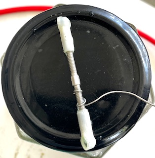

Thanks. This was the get off my ass and see what it’s like step. Next step is to do this well.
I’m going to need more vinegar,
Most of the recipes I see are for 1 liter. I think the anodes are still in good shape, but I might wear them out making a liter of the plating solution.
Reading more about the process I think I should be watching the current draw more than the voltage. For these small parts .1a seems to be correct.
The distance of the object from the anode seems and the surface area of the anode have the greatest effects.

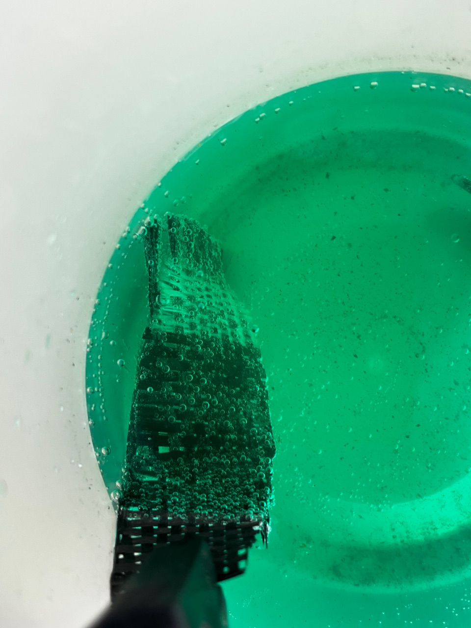

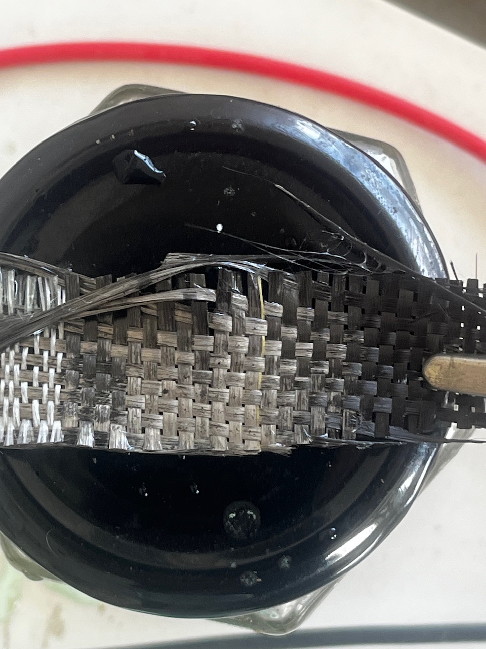

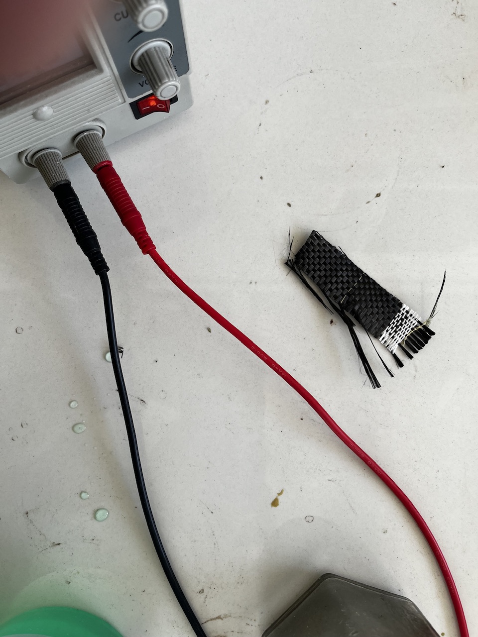

I don’t know what to do with this knowledge, you can nickel plate carbon fiber fabric.

JosephS wrote: Mon May 26, 2025 4:39 pm I don’t know what to do with this knowledge
Didn't Heisenberg say that... once. :lol:
You've been gaining ground on your carbon fiber chassis'... nickel plate the cloth then mold the chassis and have the first "Nickel Plated Graphite Classic Clear Edition" ...Associated NPGCC??? :P

So it turns nickel plated carbon fiber is a thing in Aerospace. In addition to electrical conductivity it's thermally conductive. It might be good to make a motor mounting plate out of it.
I was also thinking of making a fiberglass chassis with embedded wiring. I wonder how much current it could carry.
