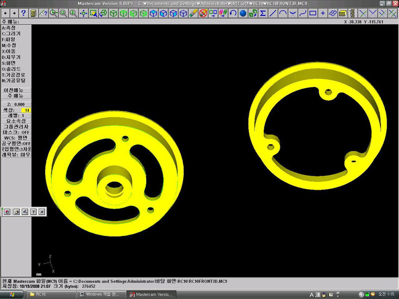

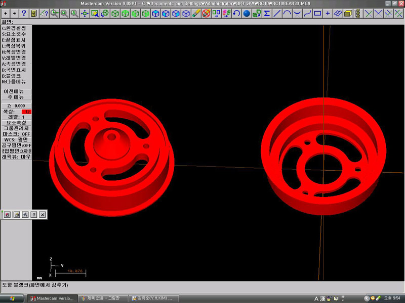

3D design finished.
went to almost complete jelly bean wheels except the plastic rings. 2-piece 2.1" front wheels need the plastic rings from #6854. the tape trick from yokomo would be useful for 2.2" tires. I tried old 2.1" and recent 2.2" tires. and, got no issue. :D
the rear wheels are 2.2". found right material samples to be milled, chopped and turn to be the rings holding tires. I didn't make a same choice on the front ones to save time and money.
rear
rear
front
front
