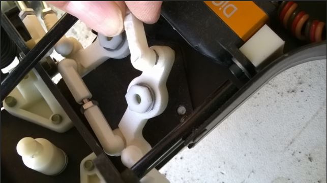

SLS-printed nylon parts are surprisingly strong...
I had a huge rollover with my rere-Worlds and saw steering was broken. I found 8-32 screw snapped - SLS bellcrank was OK !

That's good to know, on of my friends broke the same screw on his re re worlds too.Niki wrote:SLS-printed nylon parts are surprisingly strong...

Re: NIX91 Questions and Answers
Use a steel screw there instead of aluminum. It won't break again.
Anyone find 8-32 100 degree steel screws? I'll stick with alumimum myself but to those looking...make sure your finding 100 degree or you won't fit them flush. Too much taper and you'll have to washer up the steering just to clear the taper
i have never seen a broken bellcrank screw until recently. meaning, the re-release kits. you can tell the 8-32 screw that came in the classic and worlds kits are far from "good quality".

Good job Niki
Luckily the screw broke instead of the servo gears.
I had an 8-32 head pop off on my stock worlds re-re just tightening it in the nose plate.

The aluminum screws AE has been selling for the last 10 years have looked like s**t.scr8p wrote:i have never seen a broken bellcrank screw until recently. meaning, the re-release kits. you can tell the 8-32 screw that came in the classic and worlds kits are far from "good quality".
As far as using steel steering screws, I'd rather break the screw than the plastic steering part. Stick with aluminum.
