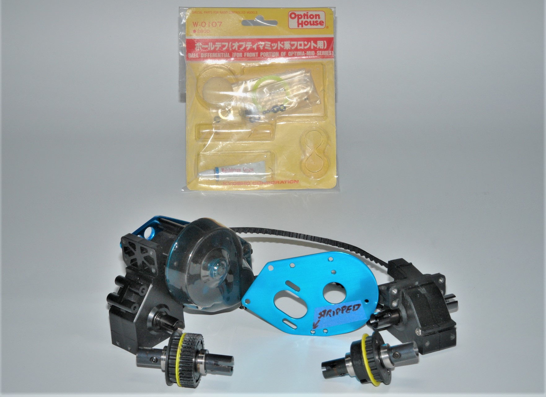

Took the car apart.
After building the diffs with new gear diffs I finally decided to open the two new ball diff packages. Just could not leave well enough alone again.
So I rebuilt both front and rear diffs with ball diffs.
The new gear portion of the rear diff housing that engages the center gear definitely helped with the somewhat loose fit I thought was due to the aluminum center gear being smaller.
There is quite a bit less backlash now in the rear trans.
The front pressure plate has a "blackened" finish that the diff balls ride on and was way more gritty feeling than the rear which ride on more conventional polished rings.
So off to sandpaper and polishing. They pressure plates eventually polished up very nicely, mirror-like. The steel is very hard however.
The front is now just as smooth as the rear diff, way better.
Should have taken pics of the front pressure plate in the process but forgot to.
The motor plate that I struggled with getting anodized wound up having a stripped screw and a few well worn holes too. Guess I should have checked that.
The brand new motor plate I got had a few light scratches to sand and polish out. The anodizing was a pita. Duralumin :twisted:
Pics show new motor plate and threaded inserts in front housing.
Before making any more trans housing decision I'll wait to see what parts might pop up that could work from the new re-re.

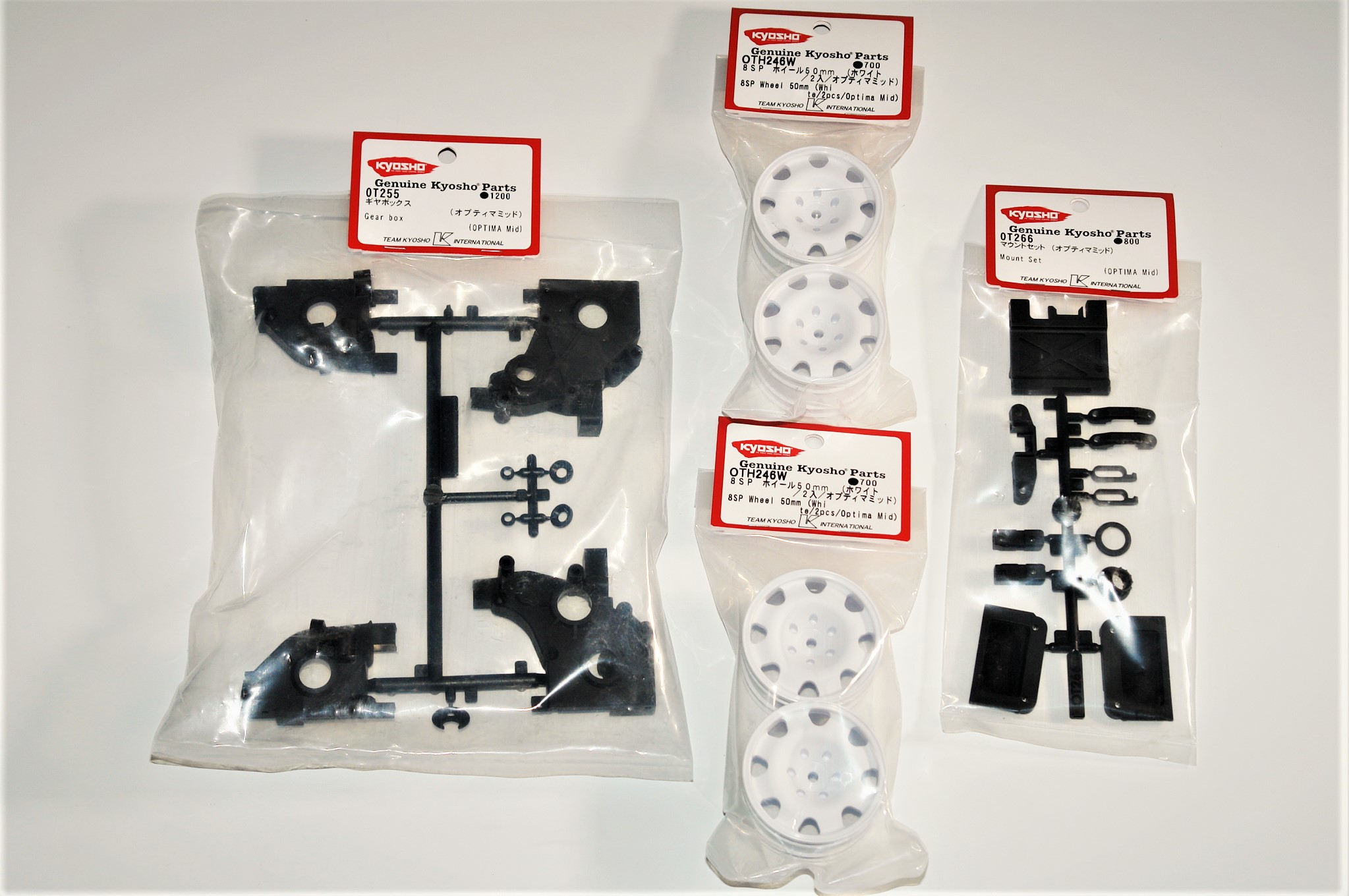

Well after a long wait it looks like some parts are coming available!
Saw a post from mikea96 and put in an order for some on Ebay.
Quick ship from Texas to Texas,
I was going to get the Wing Stay & Bumper Set (OPTIMA Mid) OT268, but some purchased all 10 available :evil: before I could purchase.
Oh well next order probably.
Chuck

First opened the trans housing bag.
Front diff housing...
All mounting holes seem to line up with original chassis, front shock plate and front suspension plate.
The screw holes are intended for 3mm machine screws not the "self tapping" JIS of the past thankfully.
Outward appearance of the housing is very very similar but not an exact replica.

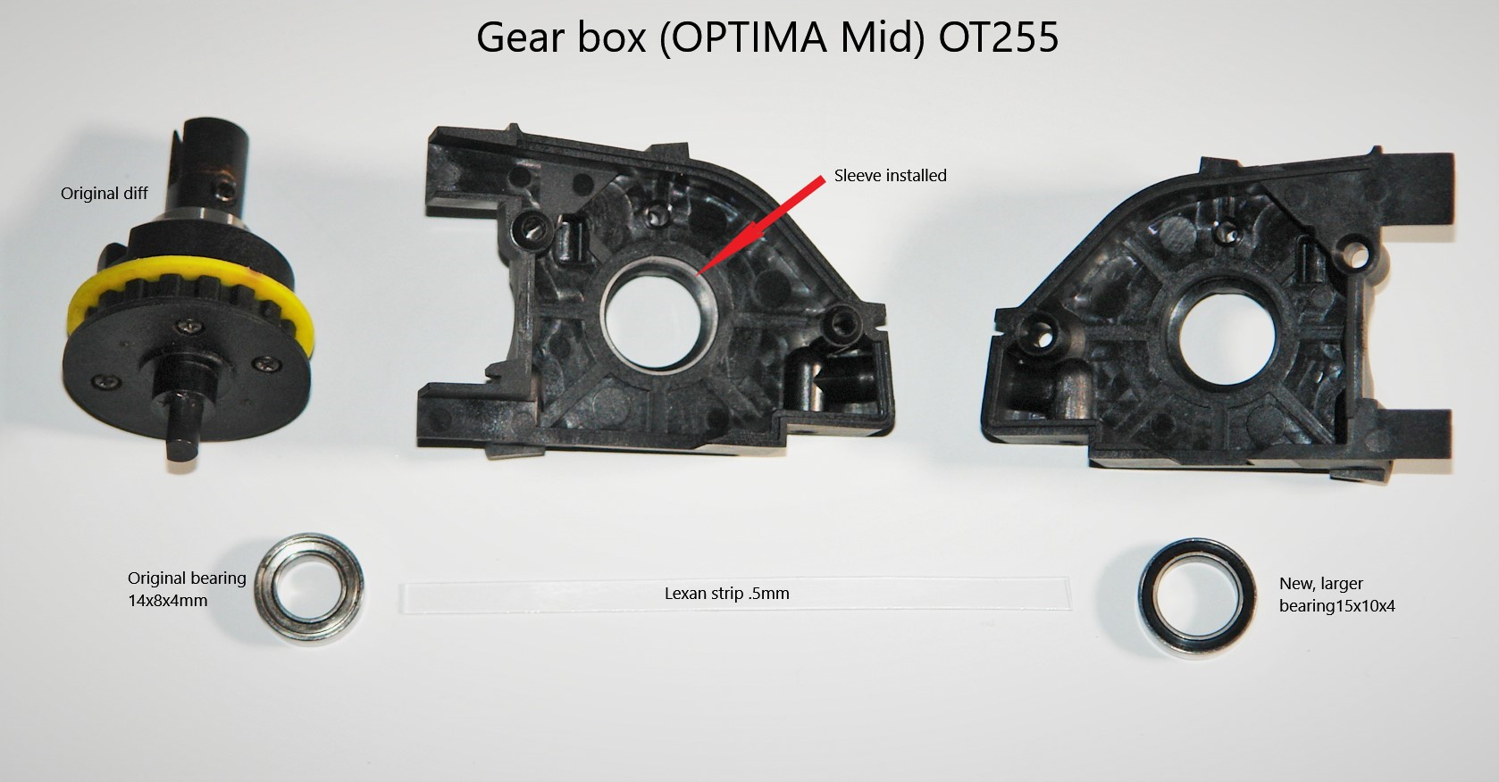

The bearing size in the new trans housing has been increased to 15mm OD, original bearing is14mm OD.
But the new bearing ID for the new diff is now 10mm. The original bearing ID is 8mm.
There does not appear to be a bearing that is 8mm ID and 15mm OD.
So I started hunting for shim material... aluminum, brass ????
I saw Tecno actually makes a plastic bearing adapter, but not in the correct size.
So lexan was a thought.
The very first piece I picked up was .5mm, voila!
Cut and trimmed a piece of lexan and the 8x14x4mm original bearing fits beautifully.
It is as snug and flush as the larger 15mm x 10mm bearing when seated!!

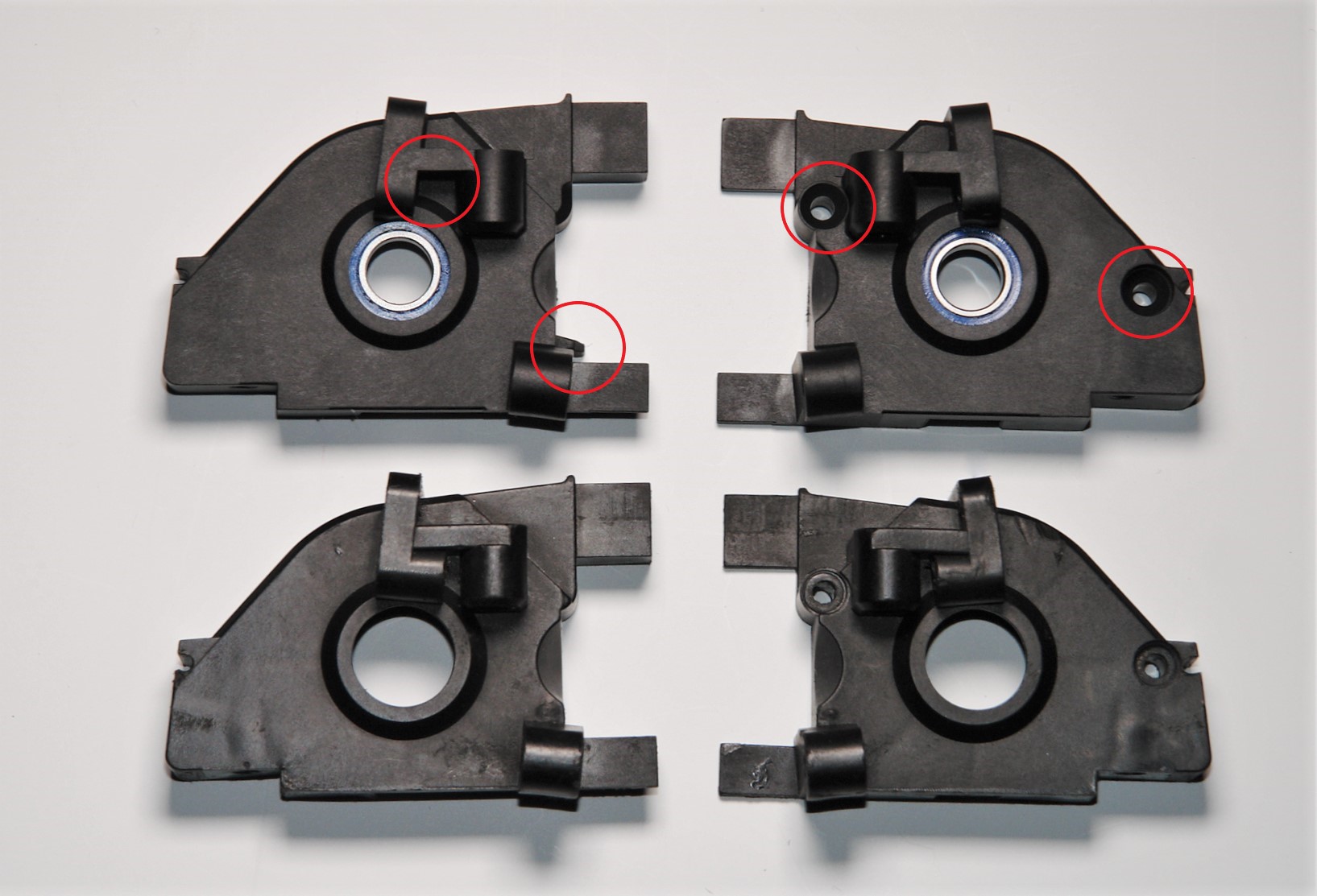

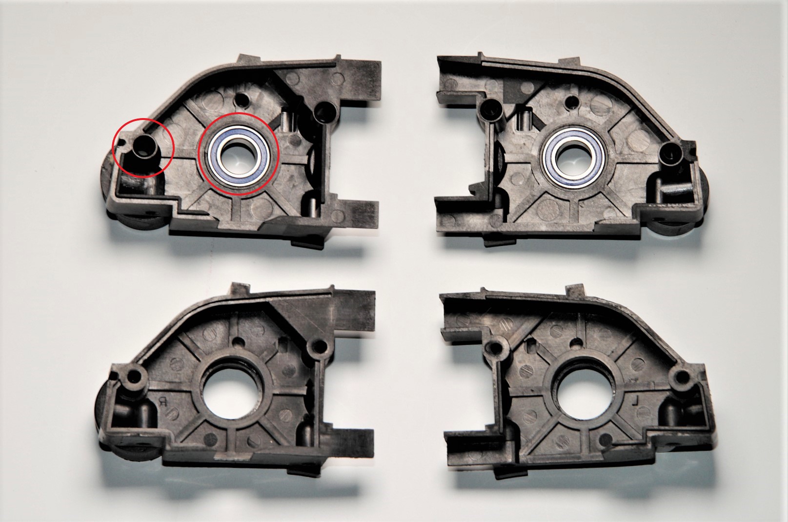

Front housing similarities...
All attachment points in same locations.
Vintage ball/gear diffs will fit
Front housing differences...
On the outside
Recesses for flat head 3mm machine screws that join the 2 halves together.
Lower attachment point for front shock stay is shorter.
Molded bosses for upper deck are slightly different.
Small tab to help retain front portion of belt cover.
On the inside
15mm bearing recesses.
Tapered and recessed bosses where case screws join and help align the two halves.
Various molding marks look to be in somewhat different locations.
New case has bearings installed...
Chuck
