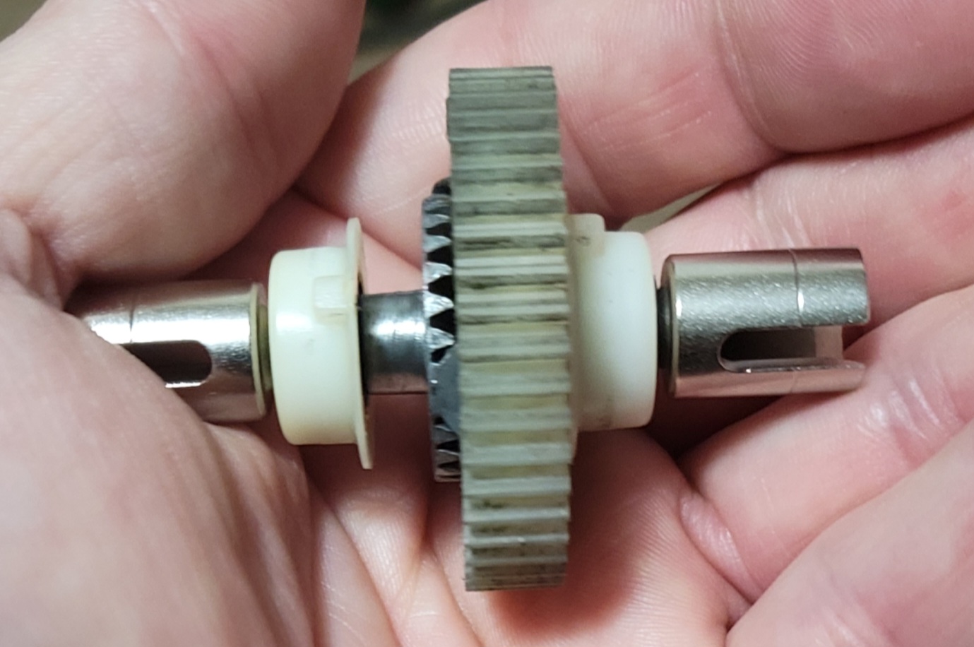

Modded Frog diff. This one has re-re outdrives (for CVD's), right outdrive shimmed, "Old Frogshot" mod, and Traxxas blue seal bearings.
If that damn Brat body and decals would get here, I might be a little more motivated to move this past a pile of parts.

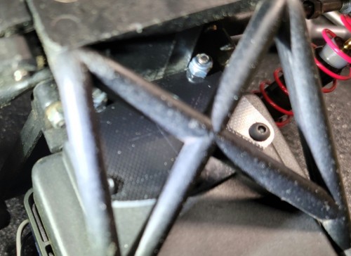

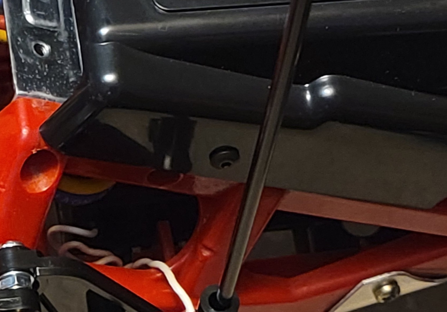

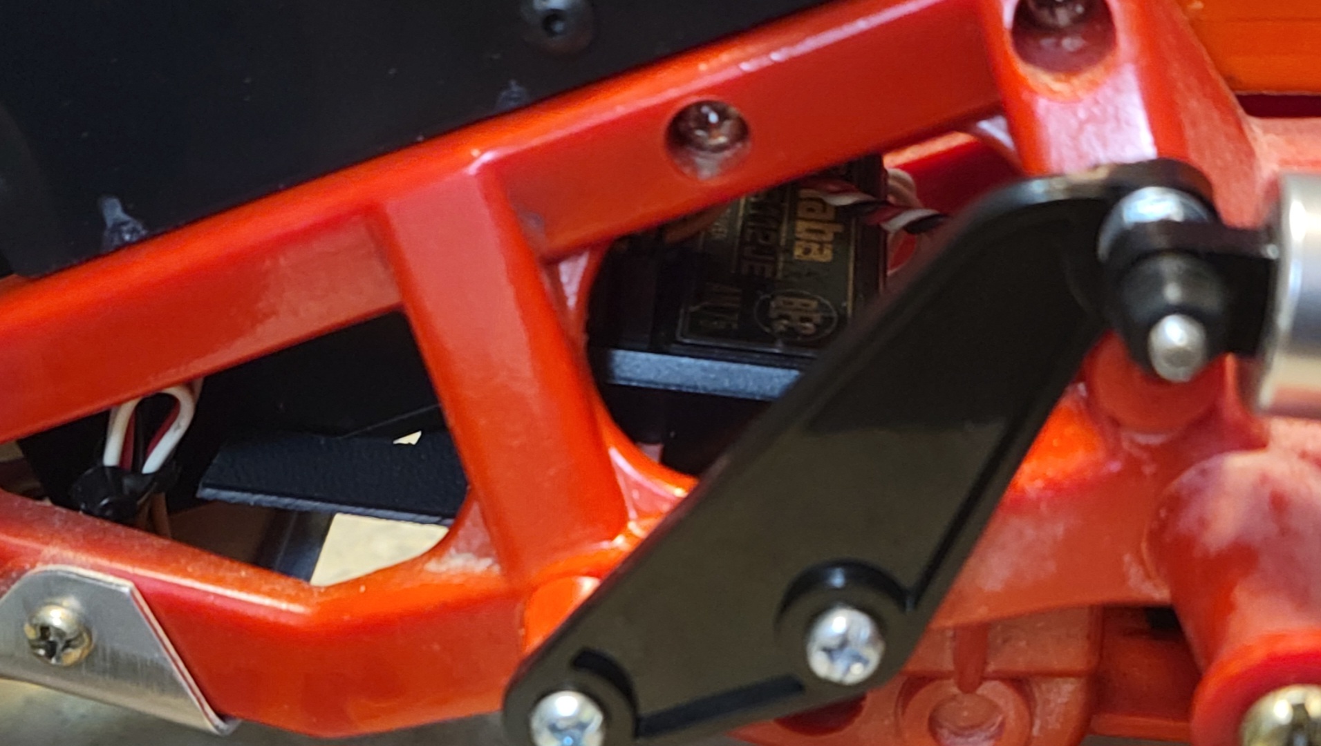

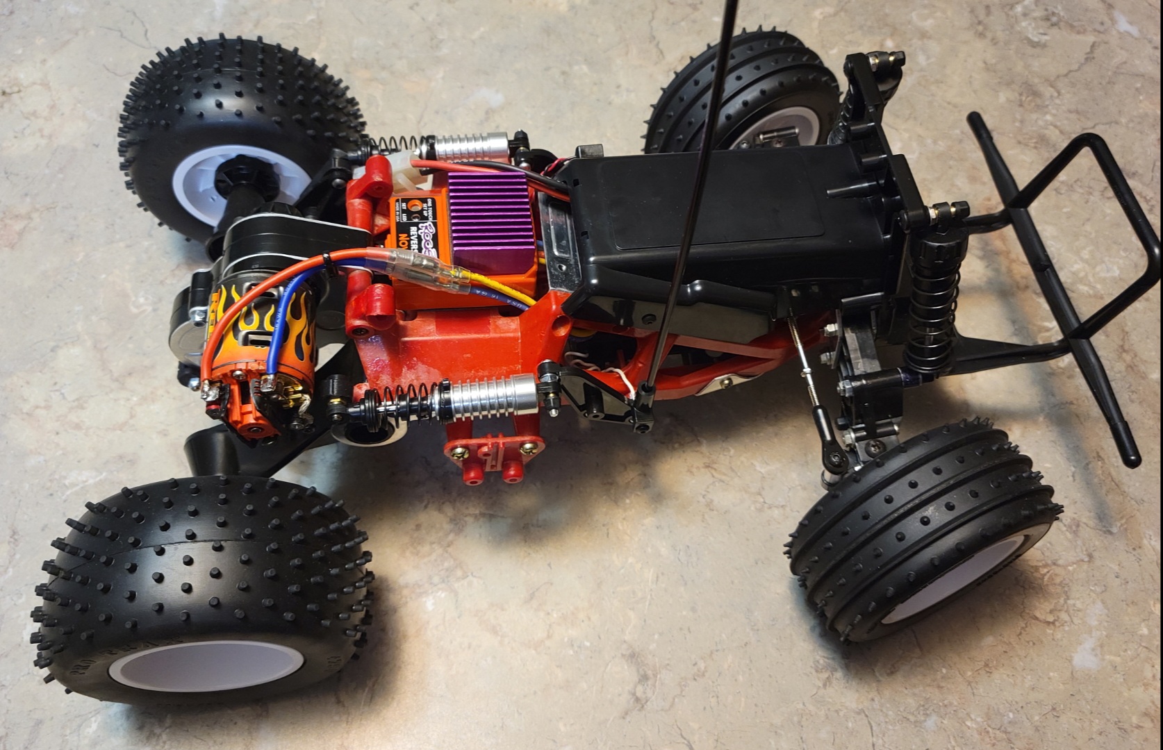

Got this Blackfoot wired up. Futaba receiver and servo, Novak Rooster, and Reedy 19T Quad Mag.
Made this shelf to mount the receiver inside the chassis and keep out some of the grass and sticks.
Made a bracket to attach the dust cover to the chassis, bracing the shock tower.

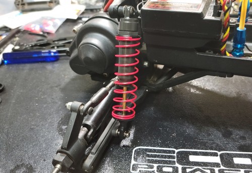

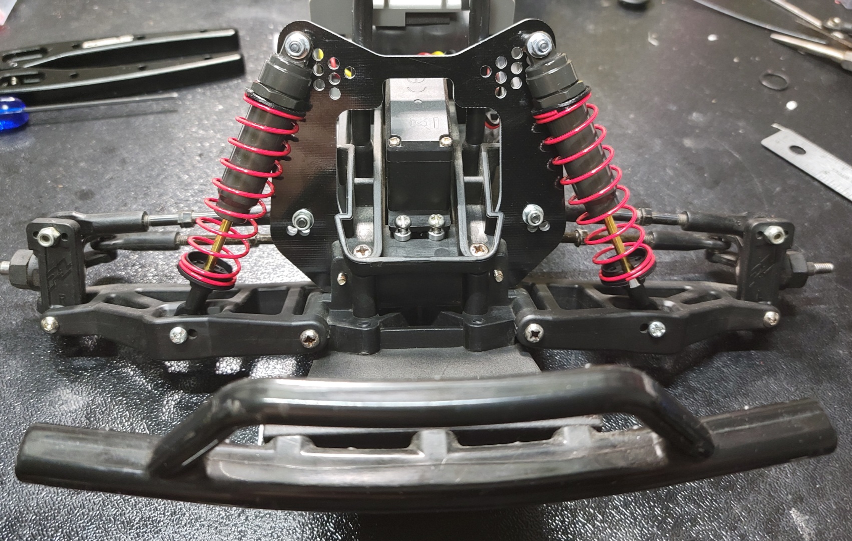

Dug out some spare clips and got the shocks built.
Rebuilt a set of Traxxas "Big Bore" shocks (not really, but that's what they call them). Used some 3D printed collars from Frankentruck to allow the use of larger (and much more common) Traxxas Ultra springs.
Then I installed them on my Stampede, with a Factory Works front tower (for long shocks). Also visible is the Pro-line wide front arms, carriers, and steering blocks.
Rear. Also visible are the Nitro Rustler rear carriers, which are more robust and have better geometry than electric versions.
Also added a Factory Works chassis brace.

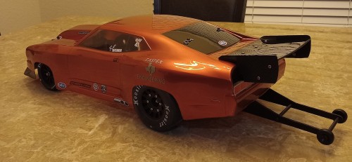

Worked on a new body....

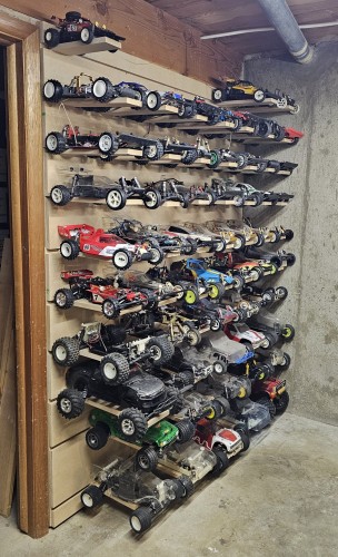

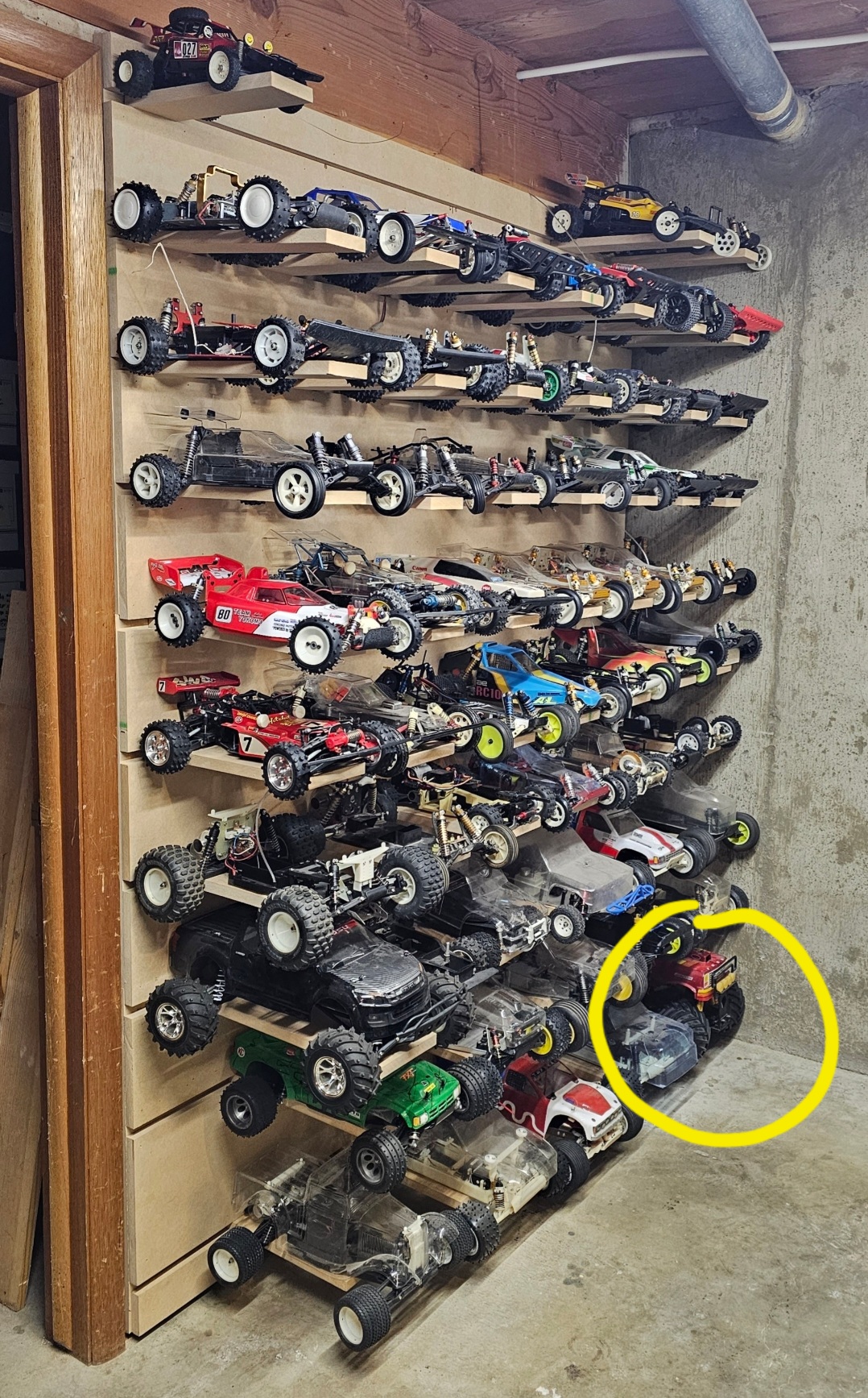

Finally after 2 years some of my cars are out of their boxes and breathing the fresh clean Idaho air. This is half of the new rack system, the other side of the doorway is getting one as well
Ignore how dusty they are. That is stage 2 haha

I like the little Turbo Hopper on top. Those were so cool!
How do the planks stay in the wall?
