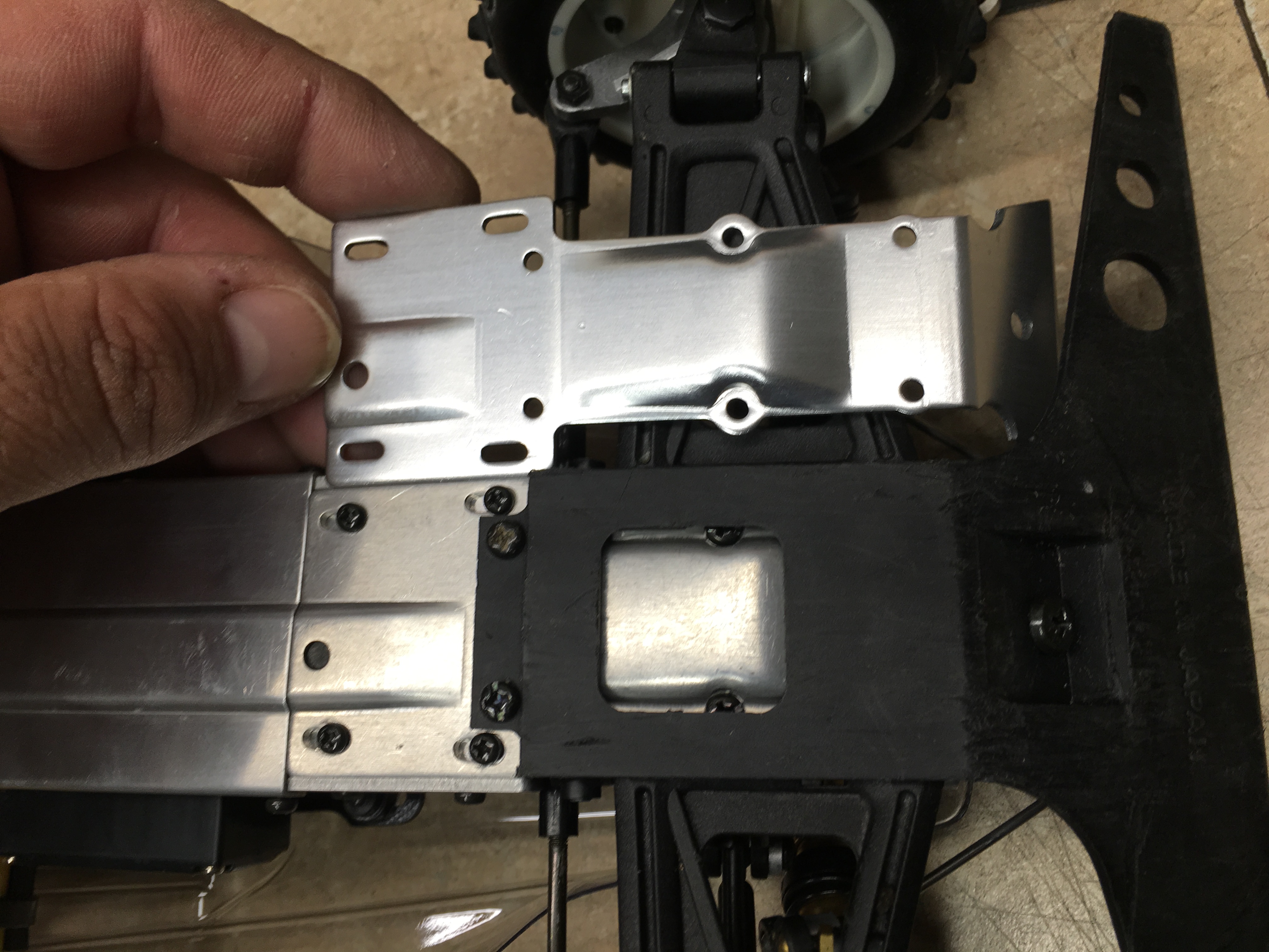

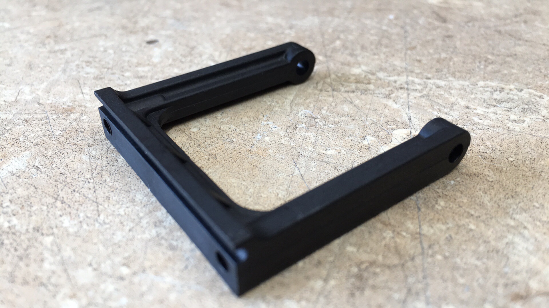

Marc, the front skid looks identical, even has the now unused hole for the bumper

How sturdy does that chin plate seem, Jeff? The original Optima one was weak and thin, and later cars (Turbo, Salute) had a visibly thicker, stronger plate. I wonder if the new aluminum parts were hard-anodized? I seem to recall many pages ago that Kyosho stated the aluminum parts were stronger than the originals.
EDIT: I also like the direction they took with redesigning the bumper. Having a center-hole affixing the bumper to the chin plate only caused the plate to bend or fold up every time there was a front-end collision. They designed the bumper the same way I designed a custom bumper for Barney, using the 4 holes on the bottom...theoretically this would distribute front end impacts longitudinally through the frame rails, a much stronger way to go than having the skidplate & bumper brace fold up and break.

the metal is noticeably thicker than what i recall! The plate measures 1.58mm thick

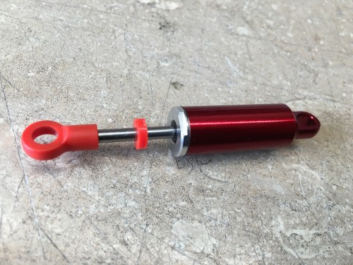

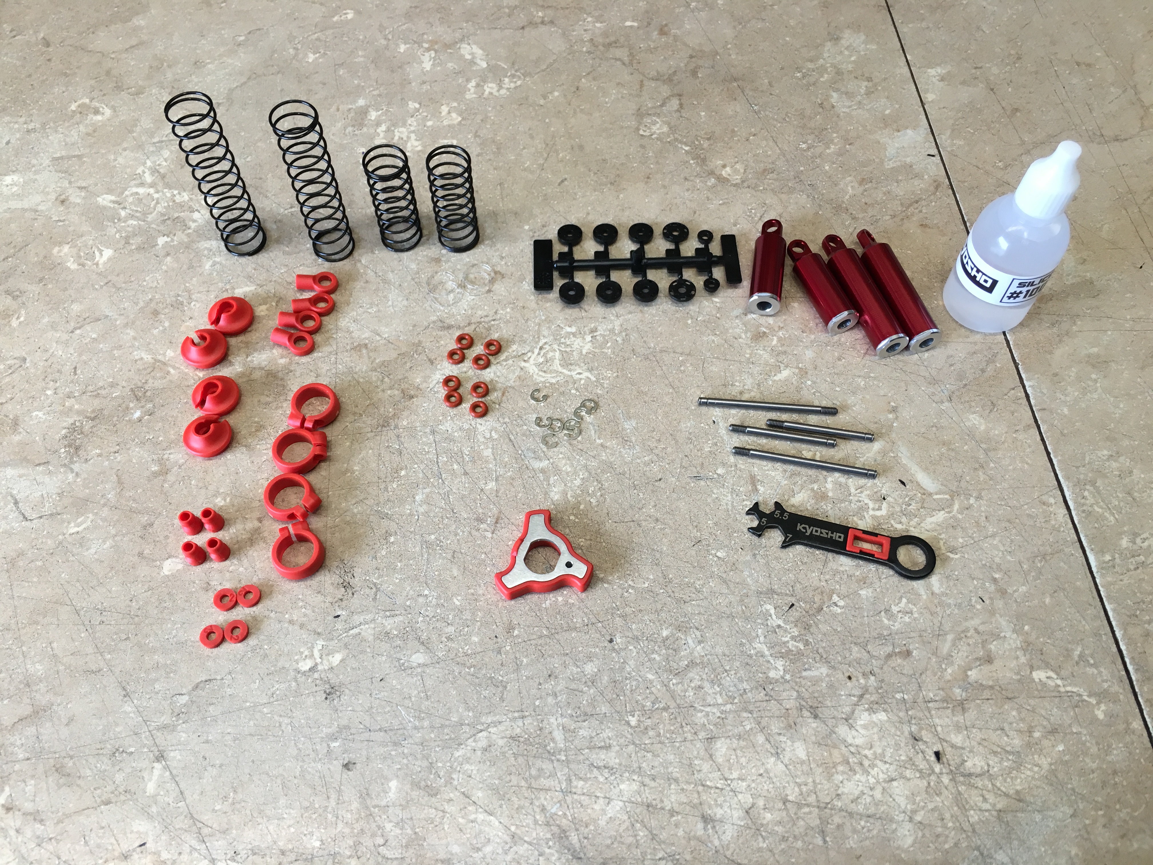

Ok a few more updates

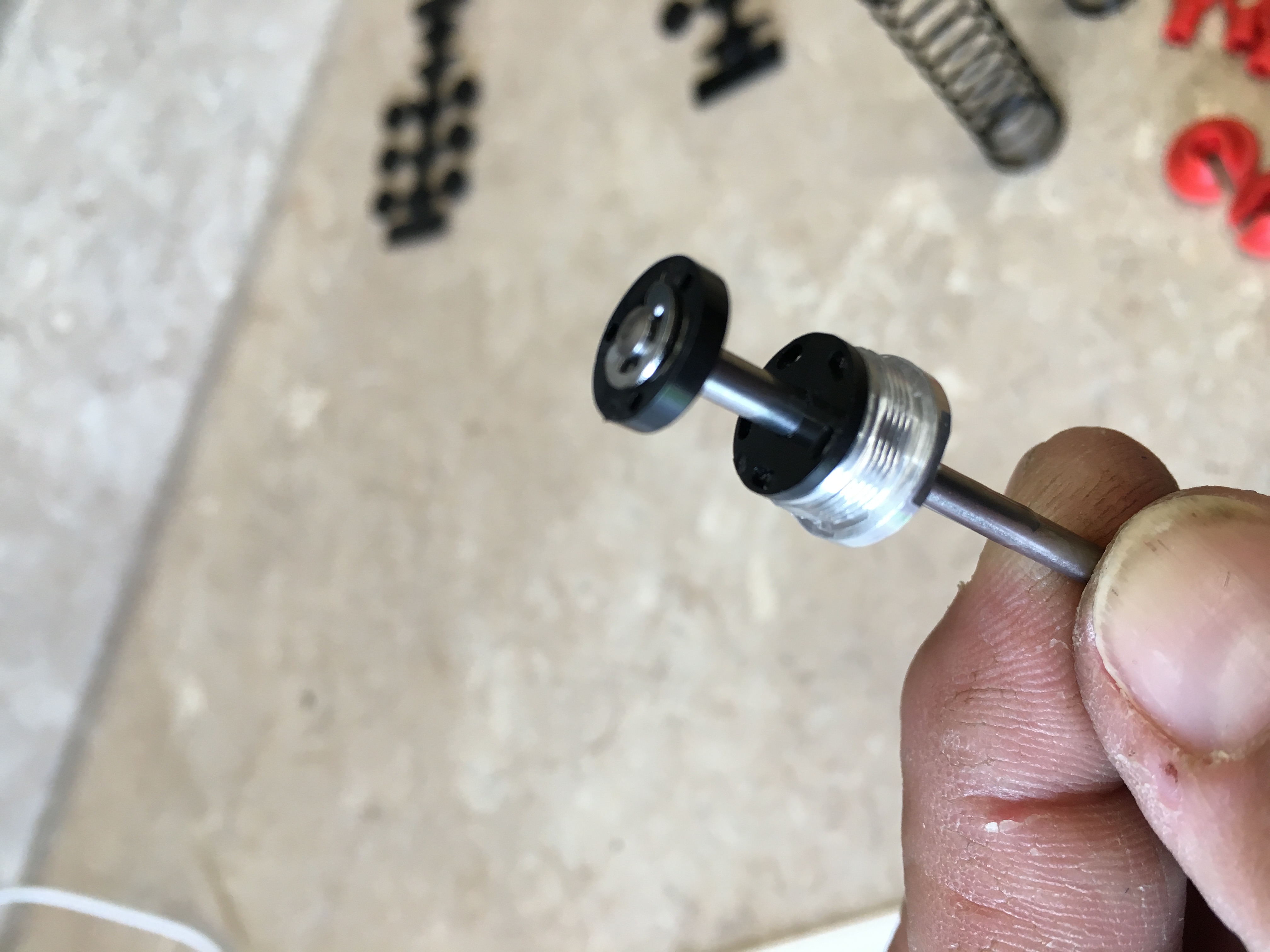

Dennis, the shocks are remarkably smooth! The gaskets are a pita just like the scorpions were. I've never had to build my own shock tools

These larger shocks don't need the bleed holes imo, they are buttery smooth and autobleed pretty well. The scorp shocks were a bugger to get right, these were not!
