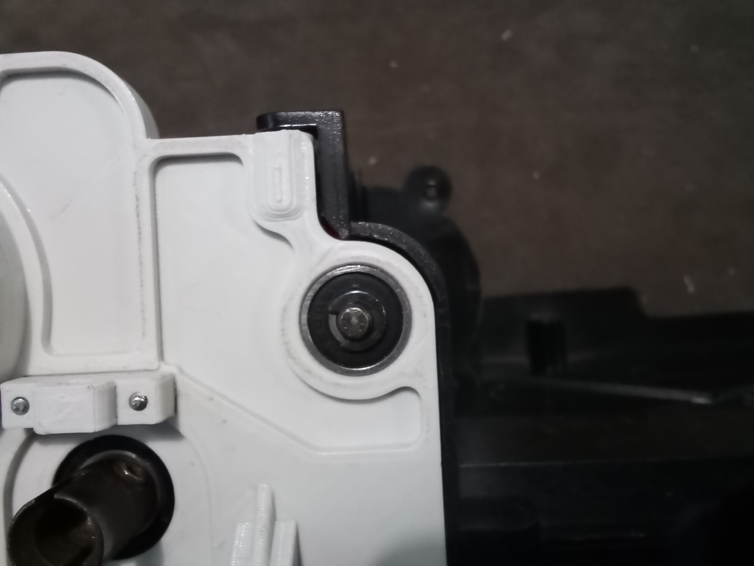

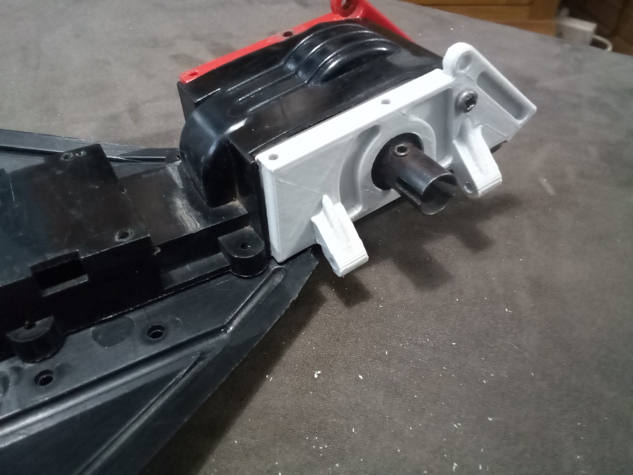

Rear left transmission housing , missed a couple of details that will only take a few minutes to fix but otherwise pretty pleased .

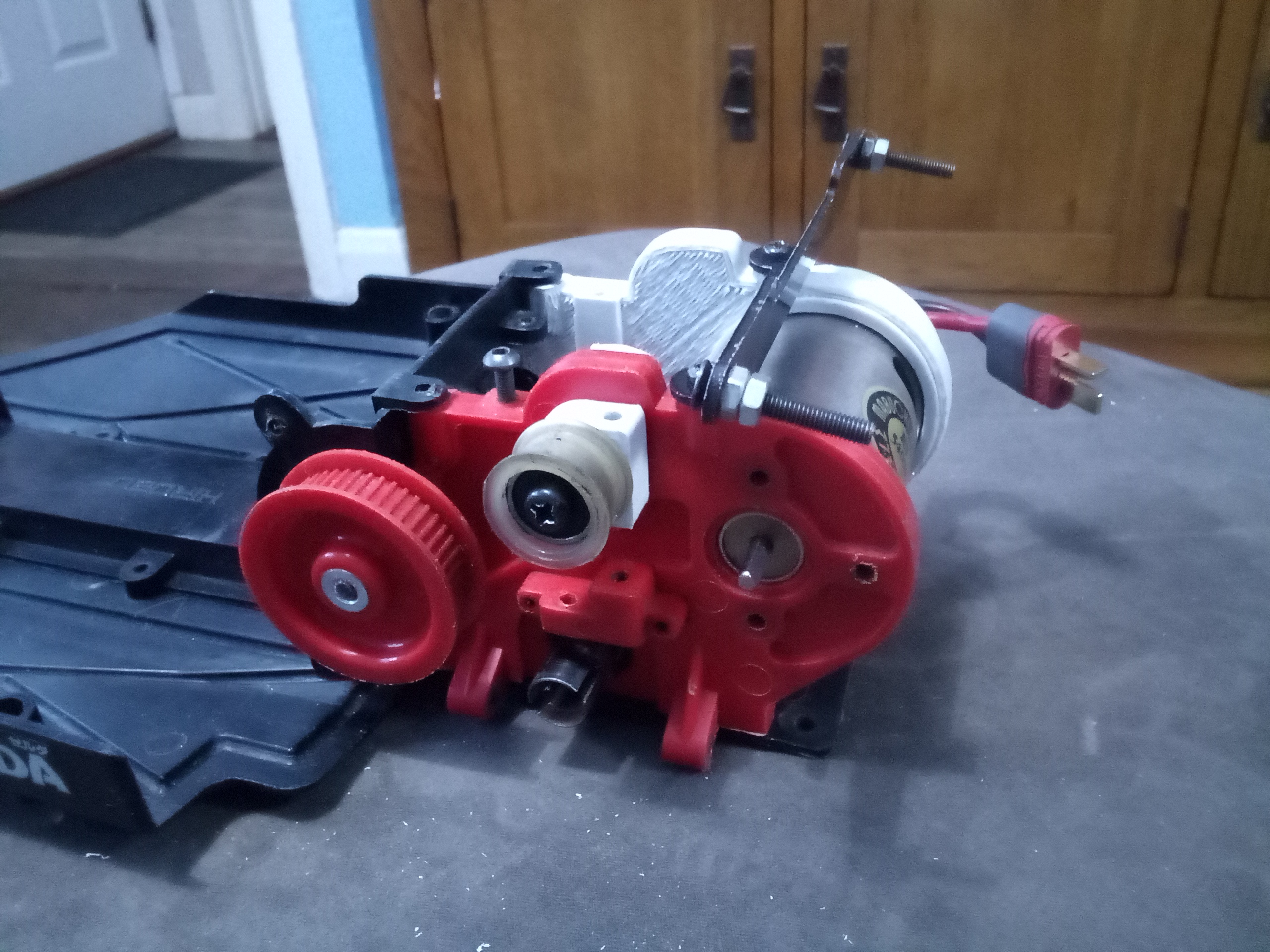

Finished the front and rear transmission housings , a job made more confusing by my warped original chassis , it looks wrong even when it's right
anyway now it's done and I have a chassis model as well I can complete the cage , once off the car and in pieces the cage is like a wet noodle , virtually impossible to measure correctly

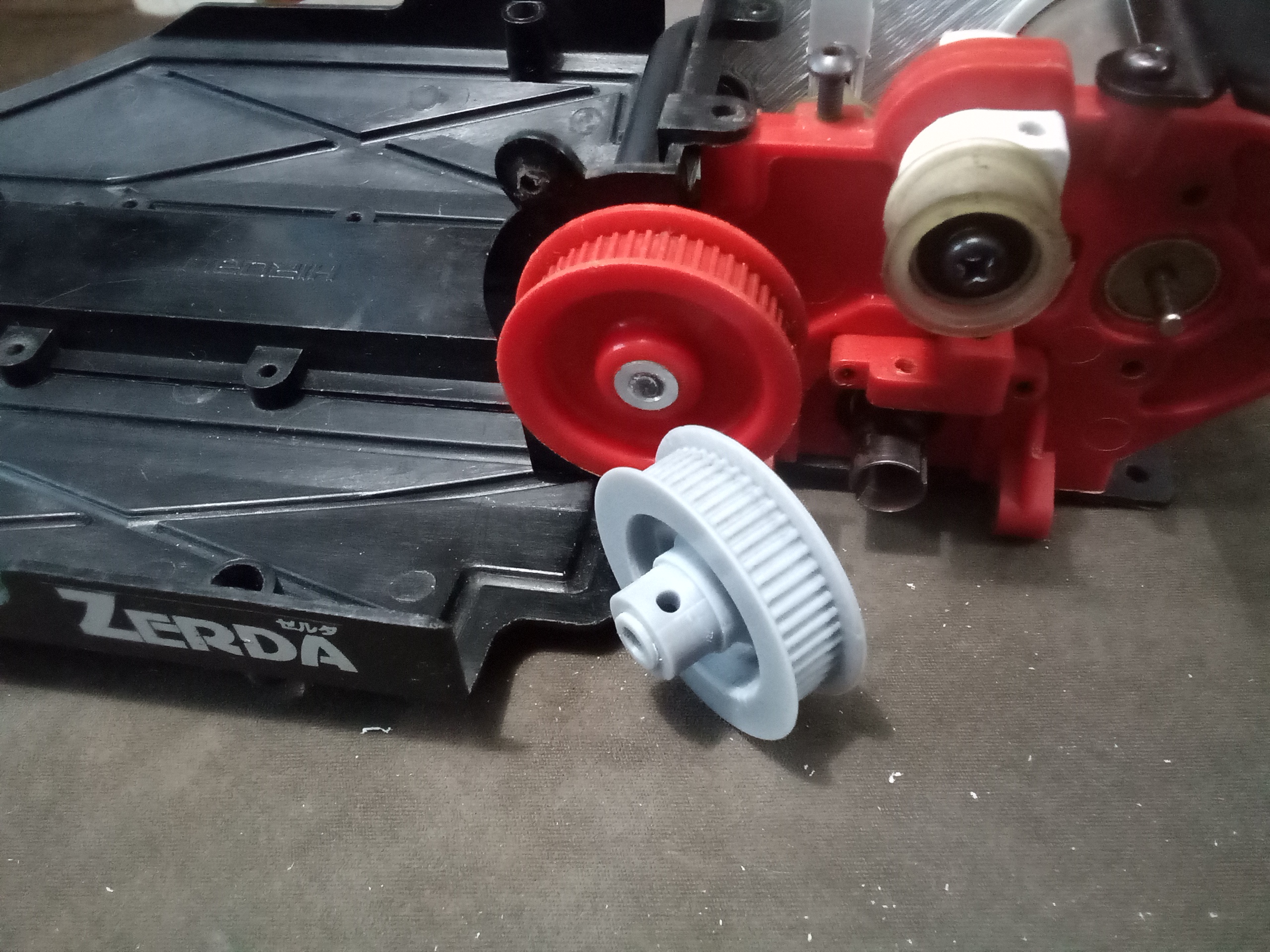

Also modelled this MXL pulley , came out well but it's only resin printer , looks good , engages the belt perfectly but it's not strong enough to use , good proof part and maybe I'll get a tester printed from Shapeways Just dropped most of these parts individually in my Shapeways shop , I'll add parts bundles soon like paired arms and trans casings etc but it all takes time .

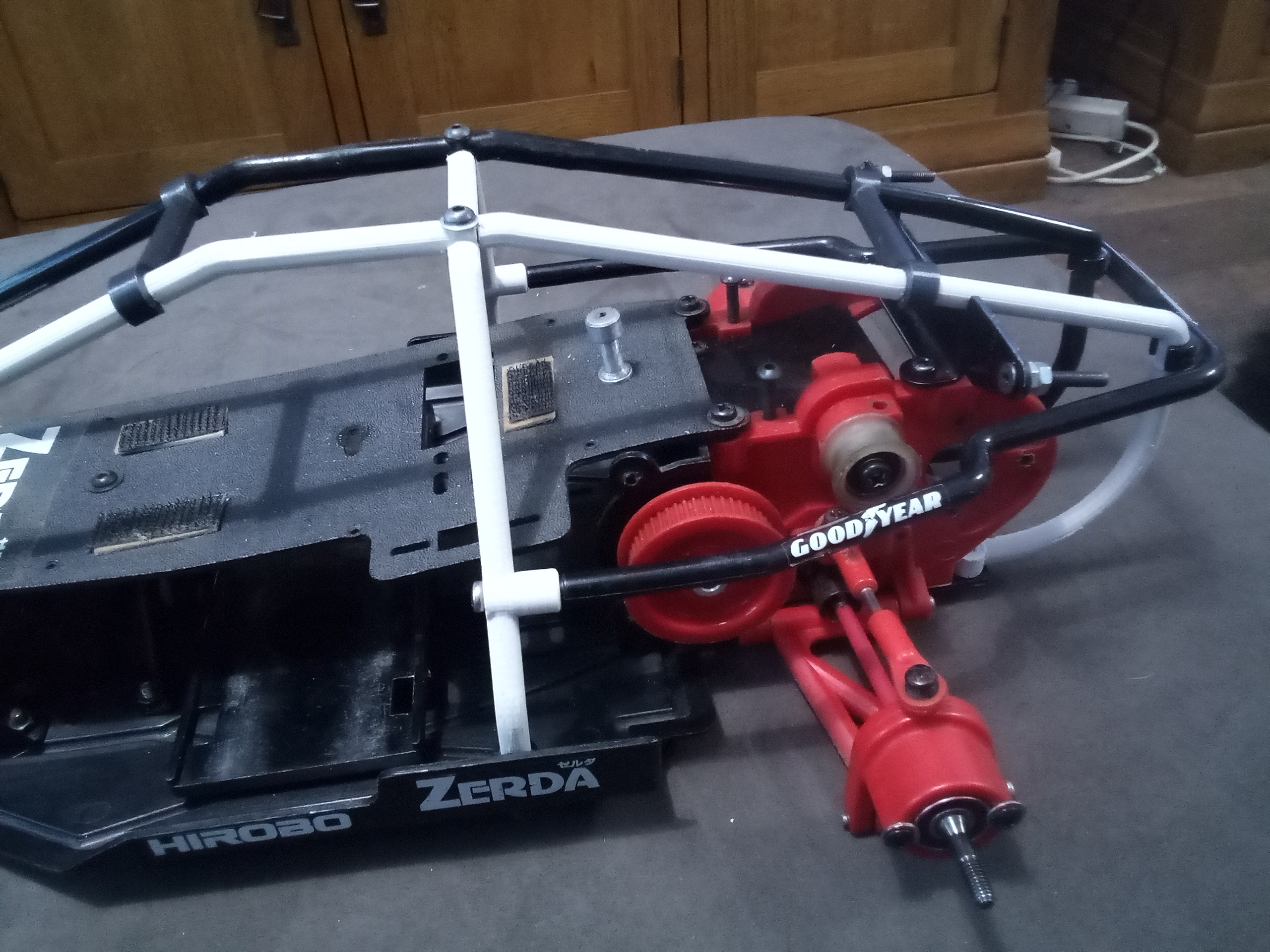

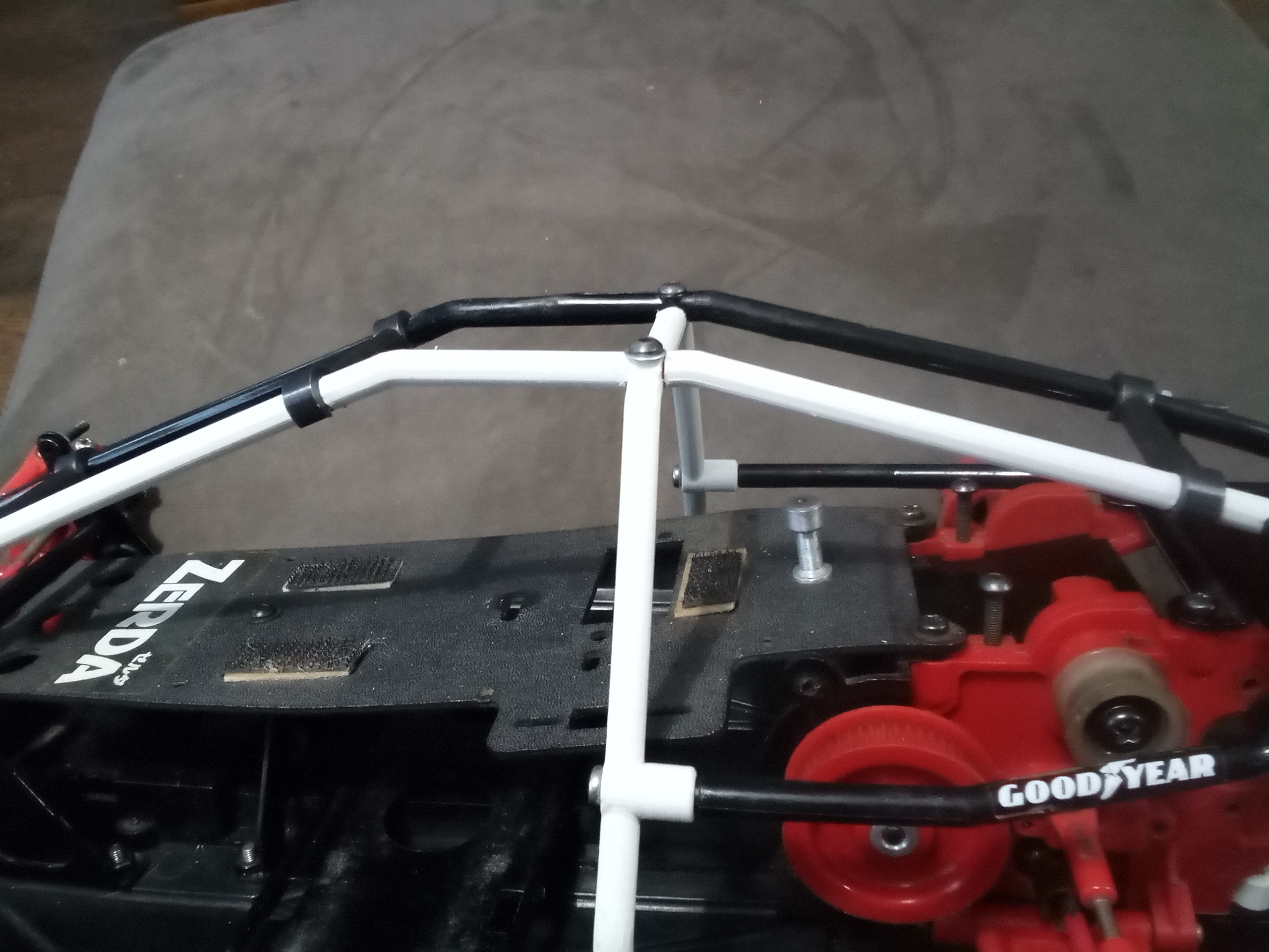

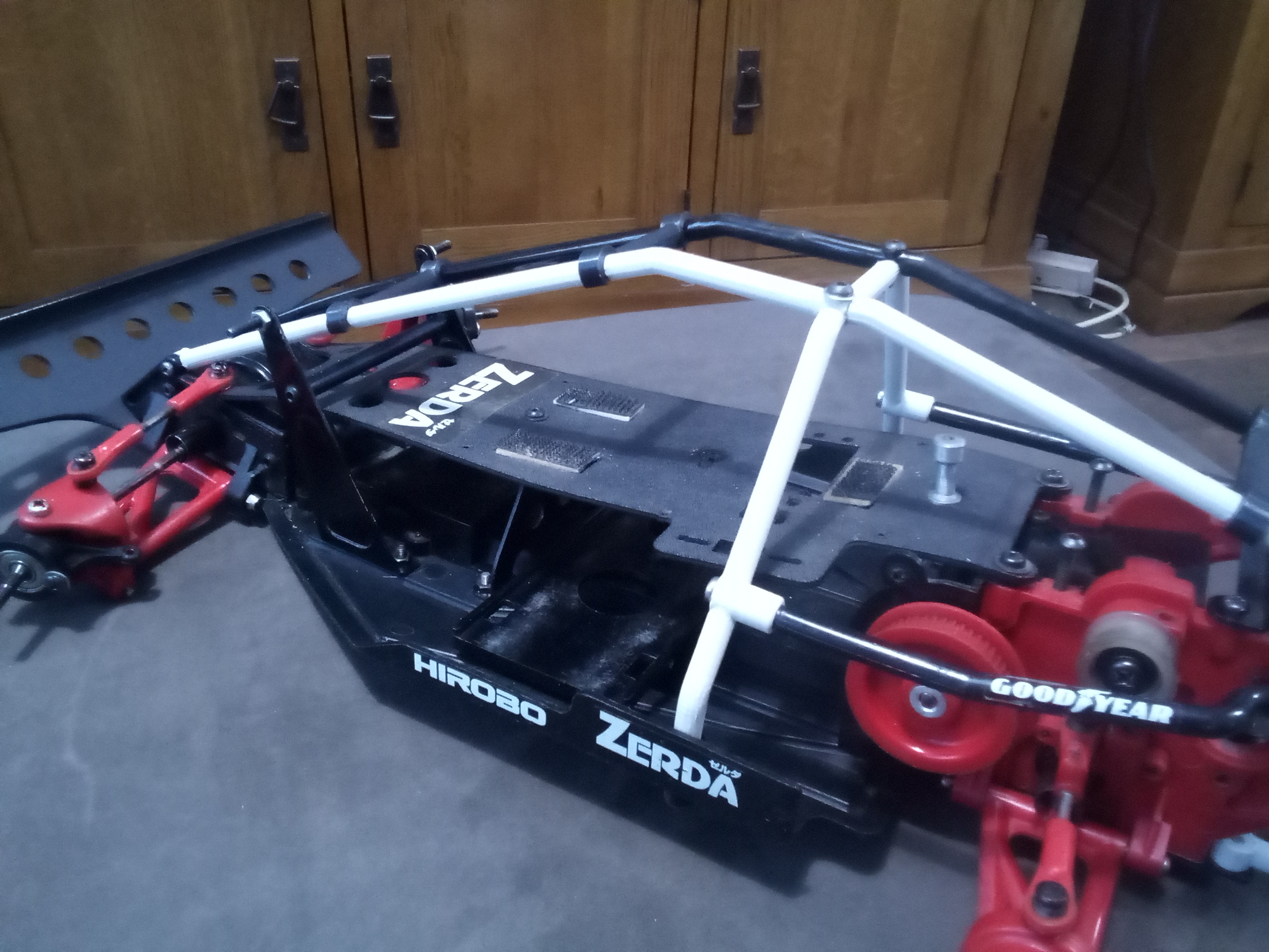

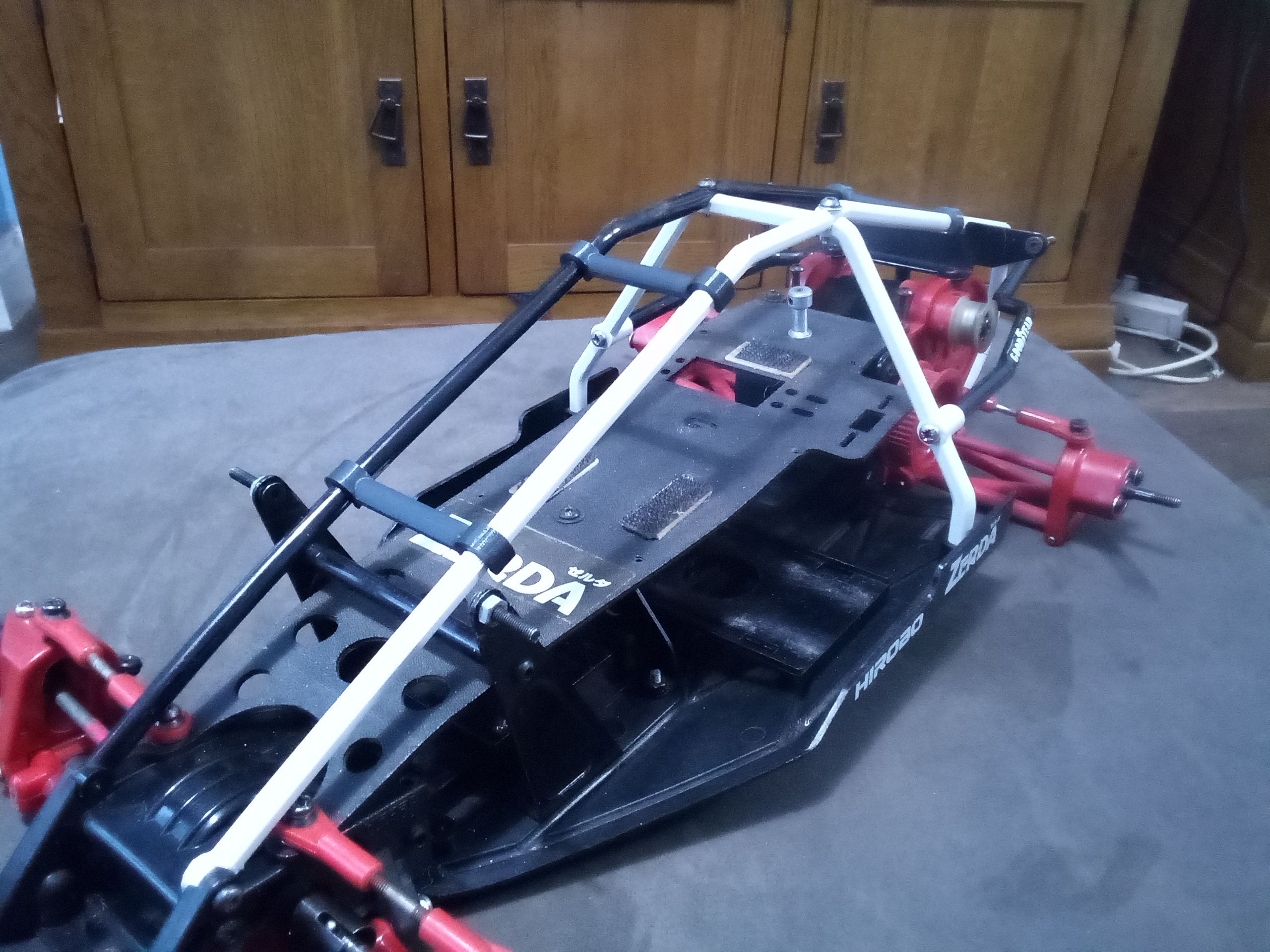

Bit more Zerda , cage sections , took longer than I'd like to admit as the originals are soft as noodles and hard to measure , they fit well now though , the long front to back section is to long to print on my printer so I had to do it in two sections , I modelled the rear section not show hear a while ago and I compared it with these parts in Fusion 360 and they don't fit together but in real life they do because they are so flexible

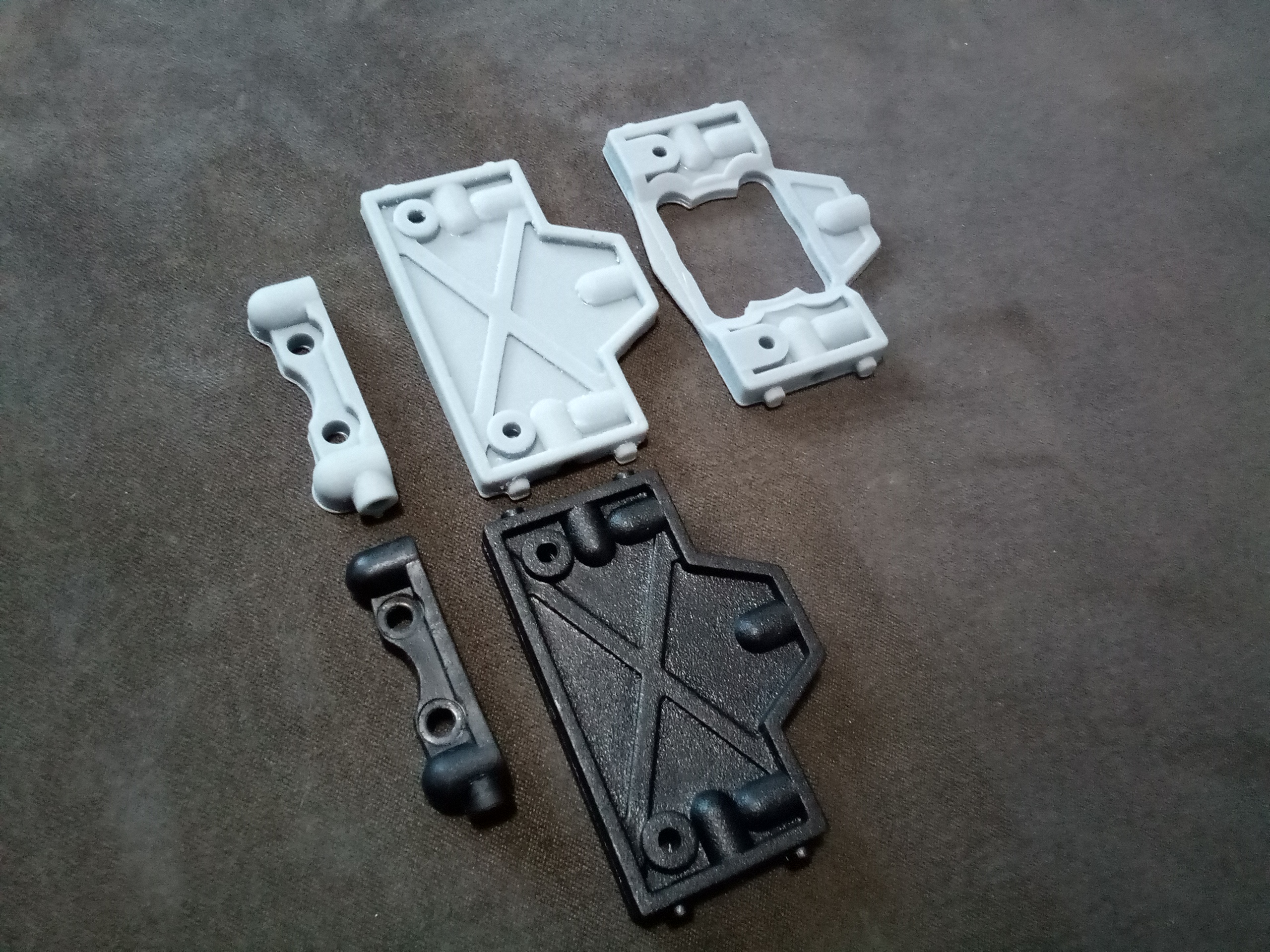

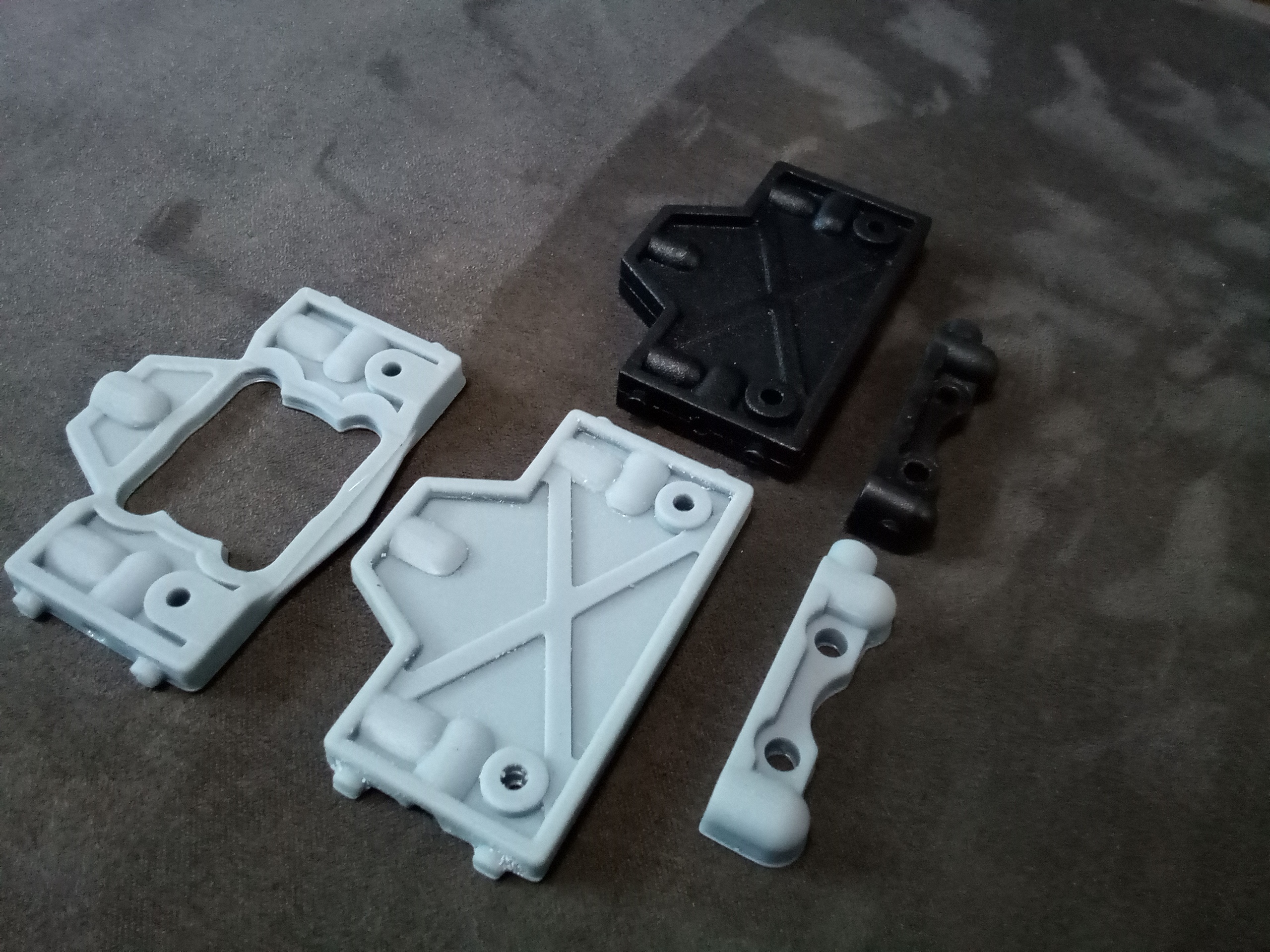

Drew these SG Racing Coyote parts , bulkheads and the top suspension mount , just resin prints as proof parts , will be in my shop soon .
The eagle eyes might spot that the bulkheads are not full thickness , I dropped the prints into the bed to get a flat bottom .If a jobs not worth doing then its certainly not worth doing well.
