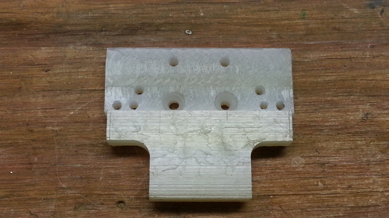

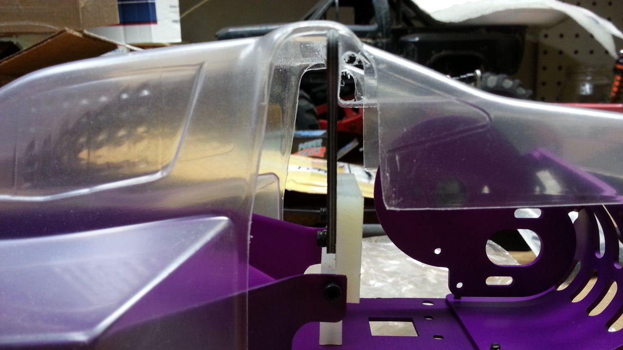

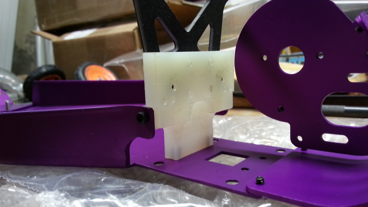

Ok, a little update.
So i pitched an idea and some measurements to Joe (thanks again
) for a new rear bulkhead to alleviate the body/shock tower issue i've had with my previous 2 B1.5 builds. He took it from there and it showed up today. Basically, the top half of the bulkhead needed to be slid back so that a standard buggy shock tower could be appropriately placed on the front side of the bulkhead.
The standard t2 tower is an 1/8" thick, so the top was moved back an 1/8" to attach the trans directly to the bulkhead.
Using the body already trimmed for my #2 build, you can see this new setup puts the tower inside the body where it should be. The other plus is that custom rear towers are no longer needed.

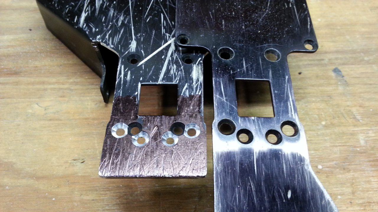

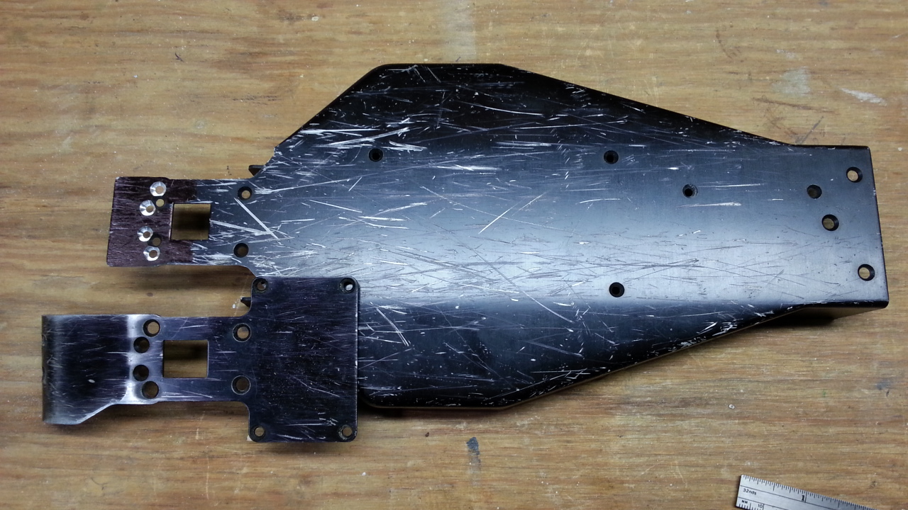

Got a new pack of cutoff wheels and wanted to make sure they cut.
This might work. Might not.....

Re: RC10 B1.5
since i don't have any b2 arms or mounts yet, i'm just kind of winging it. but what i have in my mind should work.
what will happen now...... the bulkhead holes on the tub have become front arm mount holes. i drilled and countersunk new ones for the back. the new trans mounting holes too. i still have to lengthen the square opening for the diff a little bit to the back for the 2.40 trans to drop in.
it may be tough to see in the pics, but the holes are actually spread farther apart than on the b2/b3 plate..... about a 1/16" per side. this was done because of utilizing the front bulkhead mounting holes for the arm mounts. this is going to push the arms out as well obviously, but i'm hoping the use of b3/t3 hub carriers will bring it back in so i don't have any dogbone length issues.
when it comes to the bulkhead, joe is going to make one similar to the one he made for my purple tub, but where it mounts to the chassis will be narrowed and mount between the arm mounts. i also hope to incorporate the b2 trans brace.
if all goes well, i'm going to make a drill template to transfer all of it to a nicer tub.
