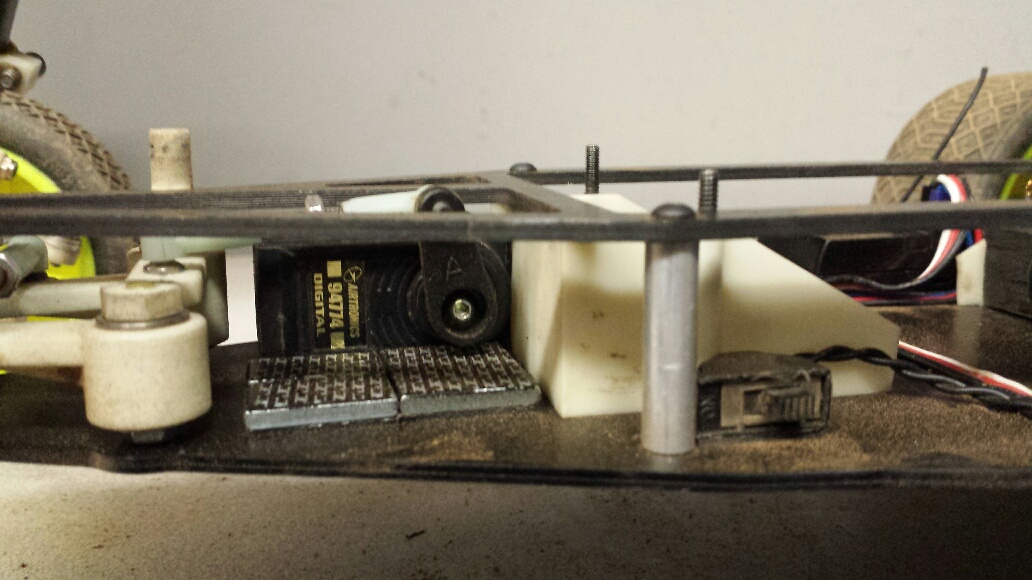

Was able to move the battery cups forward 7mm right up against the steering servo. It helped very much increasing on power steering. I'll post some pics tonight.

Post by Mark Westerfield »
Battery moved forward 7 mm, right up against the servo case.

are you still good with the steering throw ?

Patriiick wrote:are you still good with the steering throw ?
Yes.
When the steering rack is centered, the servo horn and it's turnbuckle should be 90 degrees to each other. So the servo horn will be leaning towards the front of the car when the steering is centered. It works very well with a standard Associated servo horn.

Center turnbuckle between bellcranks has its effect on steering throw. Try it.

I'm thinking he was asking if the servo horn interferes with the battery cup mounted so close to the servo
