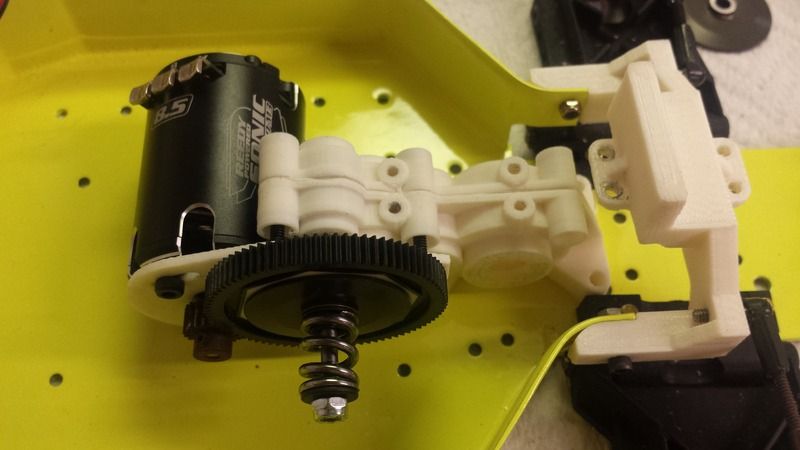

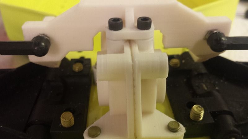

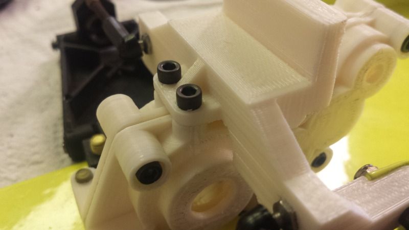

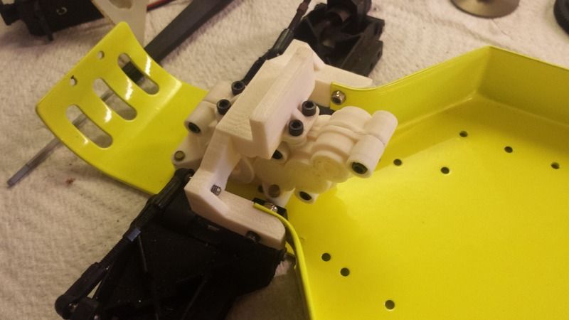

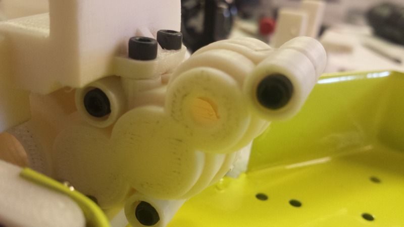

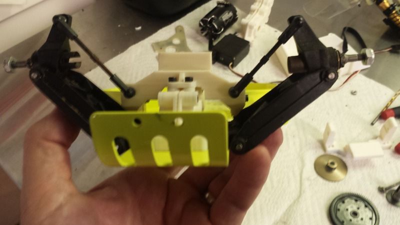

Finally, I had some time to work on this project. Sorry to those of you that have been following it that there hasn't been any headway to report for a while. :oops:
Anyway, I managed to make some more progress on both the bulkhead and the trans case. On the bulkhead, I added mounting to attach it to the top of the trans case. I also added some gussets in areas that seemed they would be a bit weak or flexy. I fixed the rear camber link holes, which I had in the wrong place. They are now in the correct World's car (the OG one, not the rere) location. Last thing was to give the chassis brace arms more clearance, they were hitting the rear arms before full suspension compression on the last version.
On the trans case, only thing I did was added matching mounting bosses on top for bolting the bulkhead and trans case thgether.
I can say this about it: it's very rigid with it all bolted together, at least as rigid as a normal RC10, so I think it's going to work well. Next I'll take it back apart and then reassemble it with the full b4 slipper set up to check for clearance.
Next I've got to design a motor plate and rear "bumper" bracing for the motor guard so it doesn't fold on a hard impact. I already know what I'm going to do for that. I also need to decide if I'm going to make a slipper cover for it, because that will influence the motor plate design. I also need to design a shock tower, then see if I can get Jeff to make me some :wink:
Stay tuned. 8)

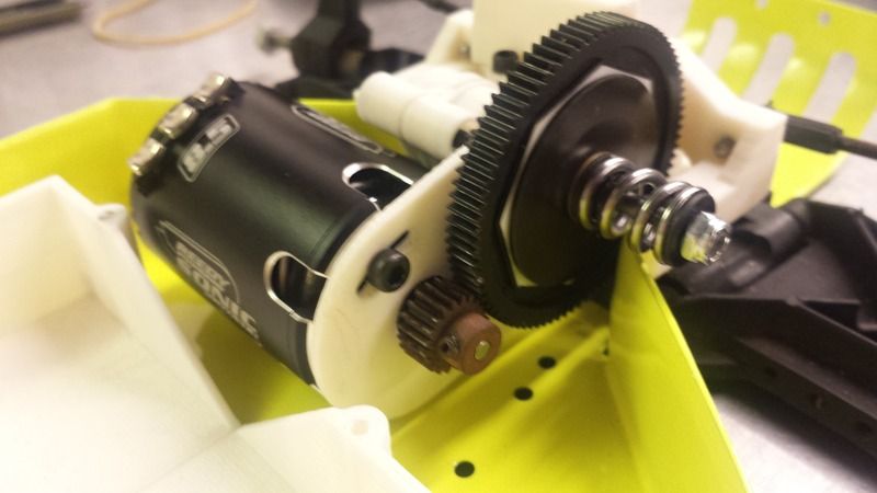

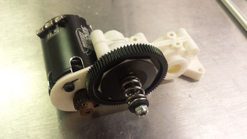

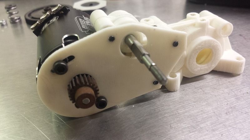

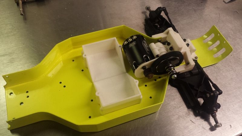

I designed and printed a motor plate today. Pretty simple desing, but seems to be spot on. It's nice to be able to make a quick mockup for test fitting before having a bunch water jetted from aluminum.

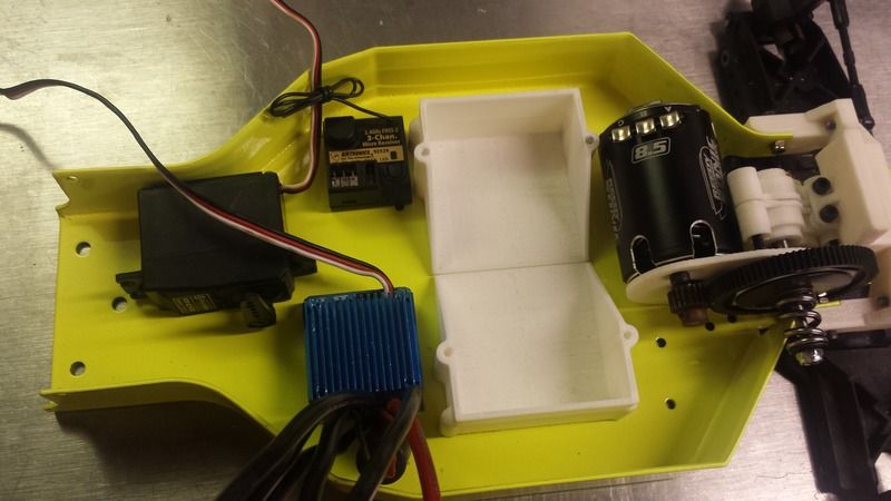

Here's how assembly goes. You bolt the bulkhead to the pan first and tighten it down. Then you slide the transmission, motorplate, and motor (although the motor can be put in later, too) under the bulkhead. You then put in the 4 screws that attach the trans and bulkhead and then the 4 that attach the trans to the pan.
Plenty of space for all the electronics with the transverse shortie pack mounts.
Still left is the shock tower and rear chassis/bumper brace. I am also printing slightly updated versions of the trans case and bulkhead this weekend. I also want to add mounting holes to the trans case for the rear Stealth mounting holes. I realized that later cars don't have the 6 gear transmission holes in the chassis countersunk. Keeping with the no-drill theme, I don't want people to need to countersink their chassis either, so those people can optionally use the rear stealth holes for mounting the trans. The front trans mounts use the bulkhead holes, and needless to say they are countersunk on everything.
