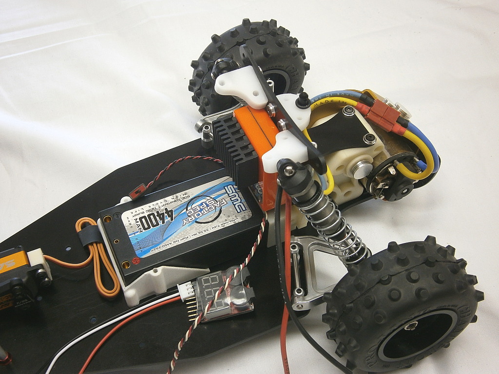

I made a small step with the wiring this morning by doing the connectors to the motor with Deans "Power Plug". I didn't want to shorten the original Novak ESC wires so kept them original length. I matched to speed control yellow and blue wires by installing some Novak "Super Flex" ets.
wire on the AE Off Road Stock motor.

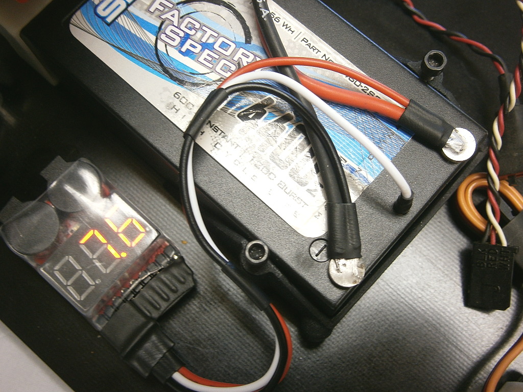

The Lipo alarm works perfectly! I'm going to install it directly to the battery, using the balance plug too. I had to halt the soldering because I don't have any 4mm battery bullets.
I order some at 0548hrs this morning!
After almost a year searching for the JConcepts rear tires I now have a complete front and rear set of rims and tires.
