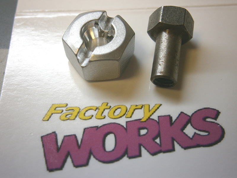

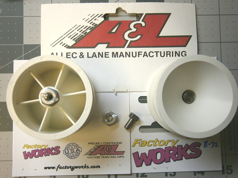

Factory Works (GoMachV/Jeff) has some serious customer support!
I got my conversion rear wheels this morning, they are heavy duty! Hex drive (12mm) with a special steel nut (5/16" drive). The hunt is on for my nut driver, no idea where the old Craftsman set is hiding. To bad MIP doesn't make one. :|

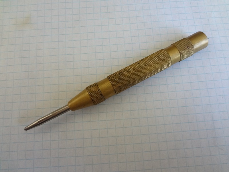

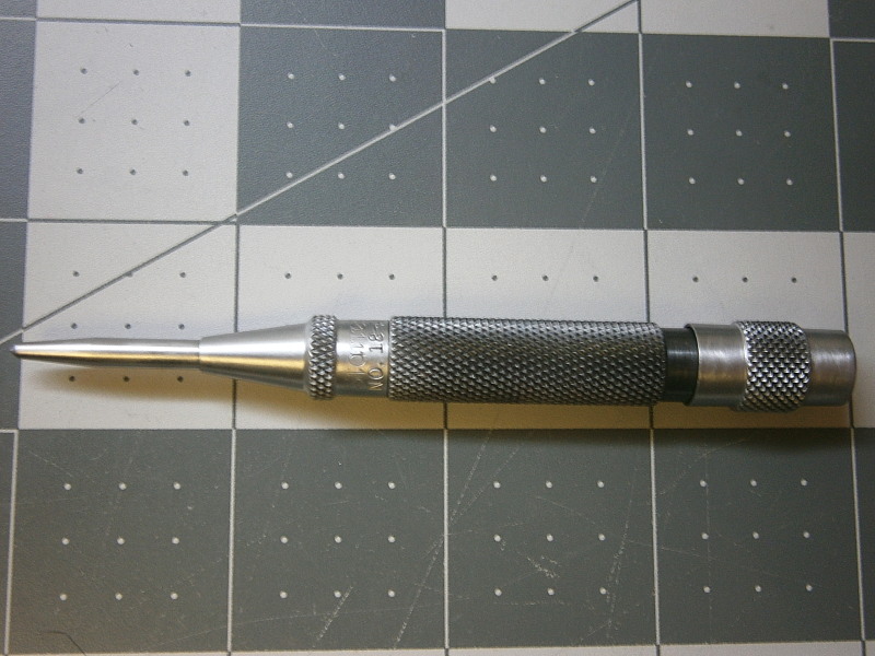

Before drilling any holes, I "punch" the spot with an automatic center punch. It leaves a nice accurate divot to keep the drill bit from walking without deforming the surrounding metal like a standard punch and hammer.
Posts: 12214
Has thanked: 1084 times
Been thanked: 3762 times
Re: NomadRacer's RC10 Trailing Arm Truck
Those are nice. I also use them to drive out shafts that are stuck! They work well!

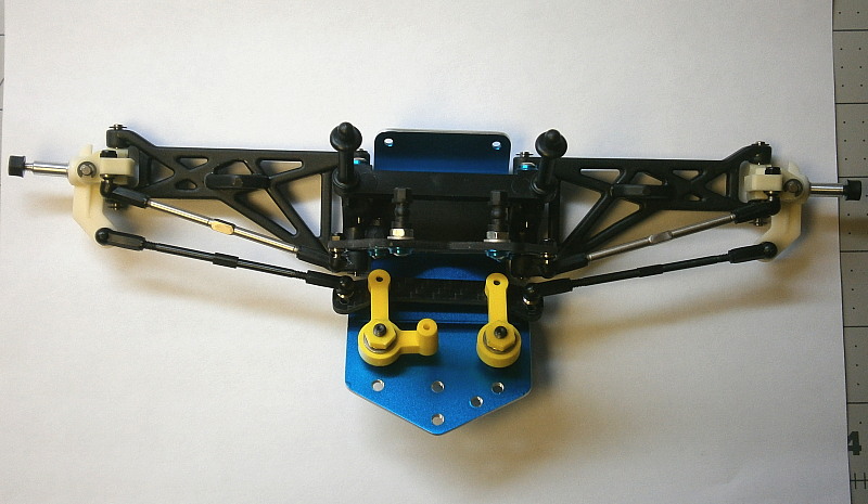

I got a couple more parts for the front end, it's close to being done now. The turnbuckles and rod ends are on there temporarily. I'll be swapping them for Lunsford turnbuckles and RPM rod ends, needed something to be able to get a measurement.

Gotta flip your arms around. :wink:

scr8p wrote: Mon Jan 15, 2018 1:53 pm Gotta flip your arms around. :wink:
