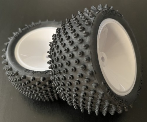

Re: RC4X4's RC10 Resto runner (basement find)
Ooooo! What kind of tires are those?
- juicedcoupe
- Posts: 3535
- Location: Pascagoula, MS
- Has thanked: 268 times
- Been thanked: 2094 times
Precision R/C, Step Studs
Yes you are correct, $15 a pair and $5 for foams

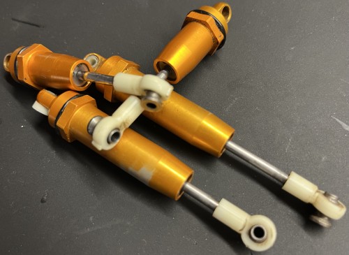

Ok, shifted plans a little, I resourced a B stamp that has stealth trans holes in the chassis. My build will consists of a B stamp chassis, Gt front end, Stealth trans in the back, Jconcepts steering rack, Klein wide suspension arms. Some things will change as I go Im sure but for now Im getting ready for a re-anno.
So a quesiton to the vets, top load or bottom load shocks? Which will I be happier with? I have top load Gt shocks (with plastic caps). I want to use the truck size shocks, but do I hold out for bottom load shocks? Asking because I need all of these parts anodized in one shot, and dont want "regerts". As you can tell this is not a historical museum build, but a user/shelfer.
