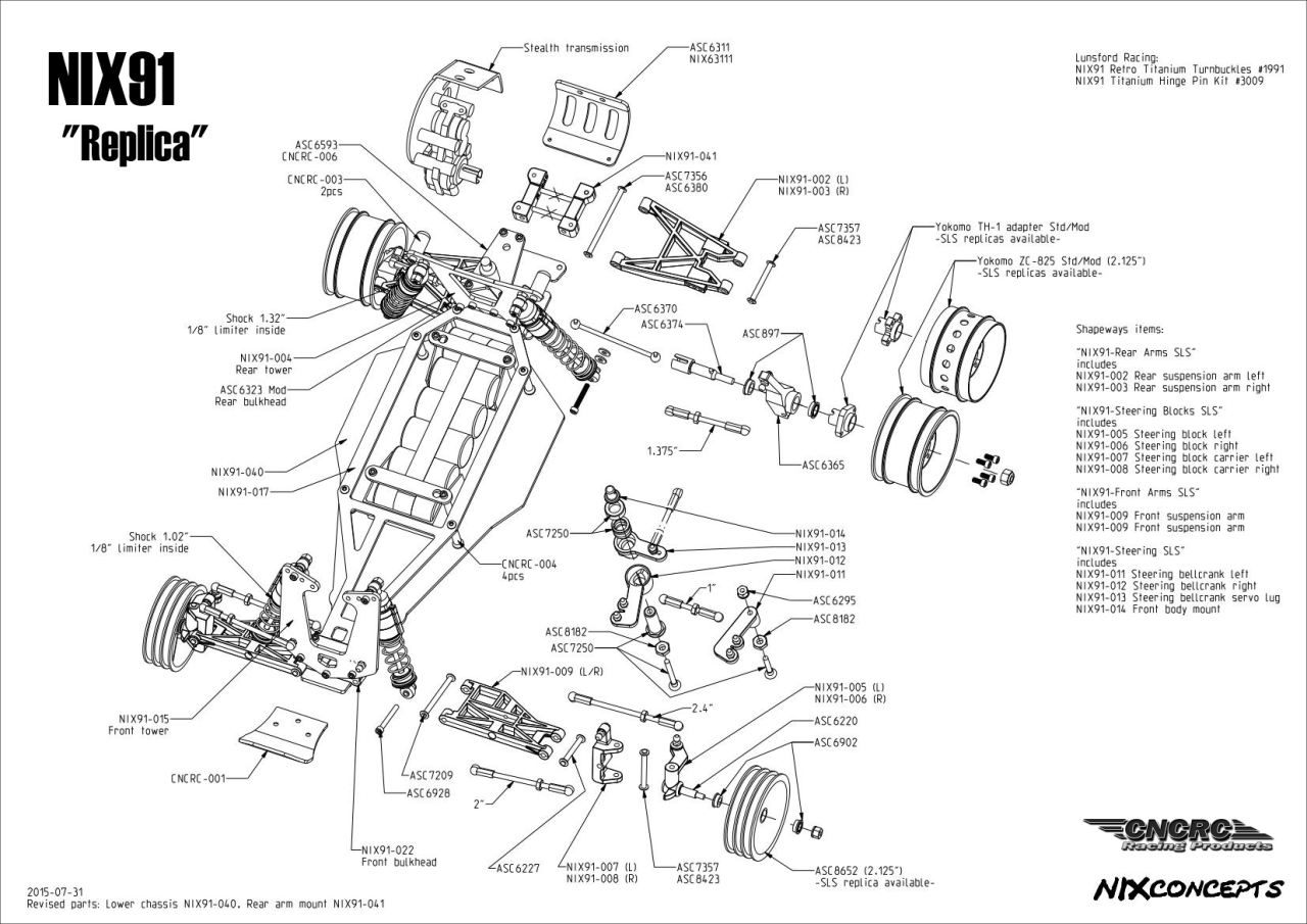

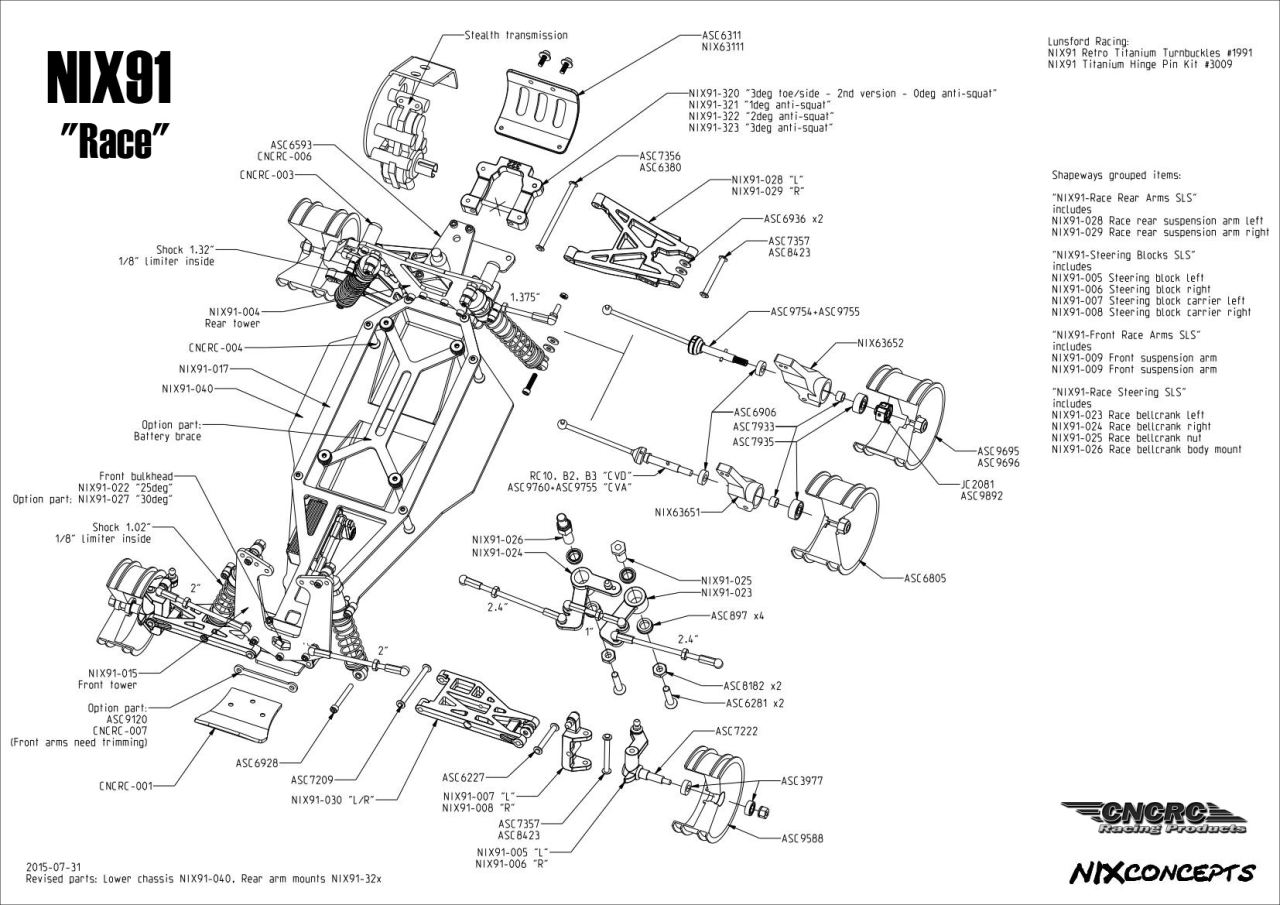

New assembly drawings for "Replica" and "Race" version.

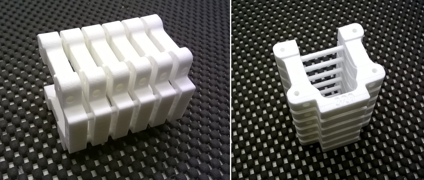

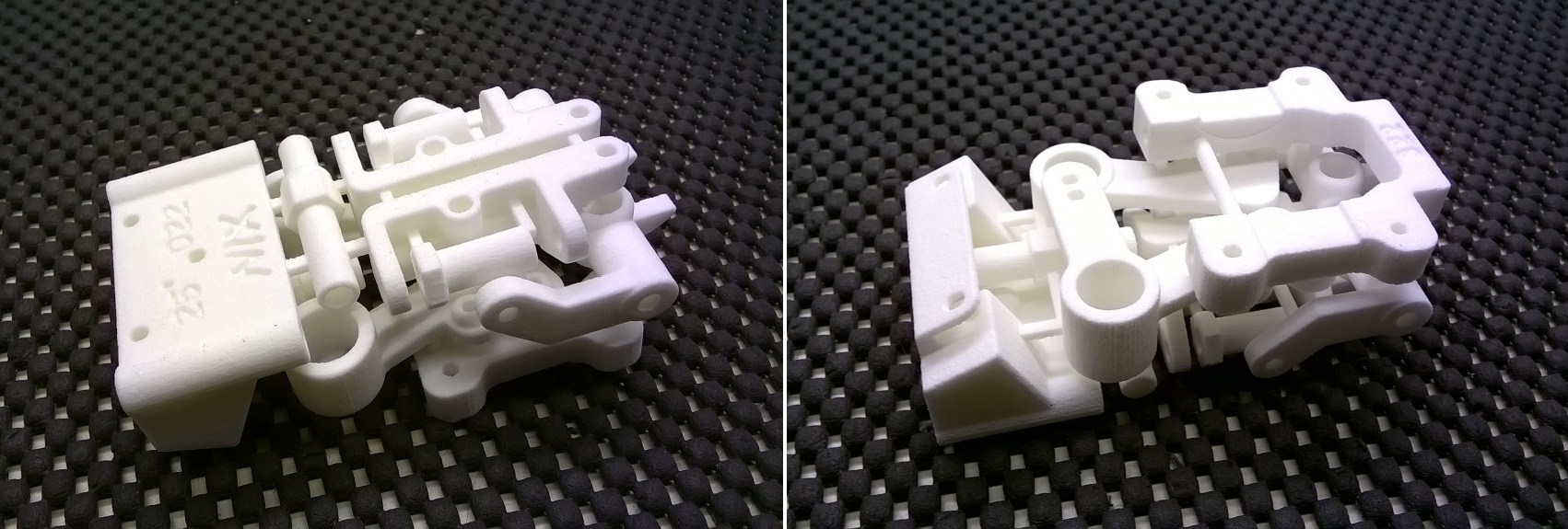

New part sets for NIX91 "Race" available at i.materialise

I love the way you were able to optimize the parts. Is there a program or feature that does that, like on our 2d stuff where we can let it optimize placements?

This was done virtually on screen without any software help. Took a while :)

Wow, quite the puzzle then! Nice work! Does it help the pricing dramatically? What about the other places, do they care if its nested or is it charged differently? Im wondering if we need to use iMaterialize for our Ten4 parts....not sure about shapeways USA anymore

All print services seems to have their own pricing system. Only way to find out is to try. I think you will get a good price from imaterialise if you pack Ten4 parts in a tight sprue.
