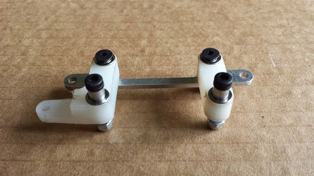

I have this alloy steering assembly here that I think might have been around when Phil was racing that Procat. I think it's Wasp or MMS but I can't honestly remember. It came from a Procat.
Image#
The posts are definitely longer than the standard Procat, and they're ballraced, although oddly the pivots are not. Hopefully it will give you some idea of what to look out for.

Mmm interesting! They do look a lot like the factory items at first glance (especially being black) & I assumed that the pivots on the car in the mag article were standard also, so was somewhat dissapointed when they didn't give adequate clearance for the roll bar :(
...However, I've got some ideas though on how I can increase the spacing on these pivots a little.

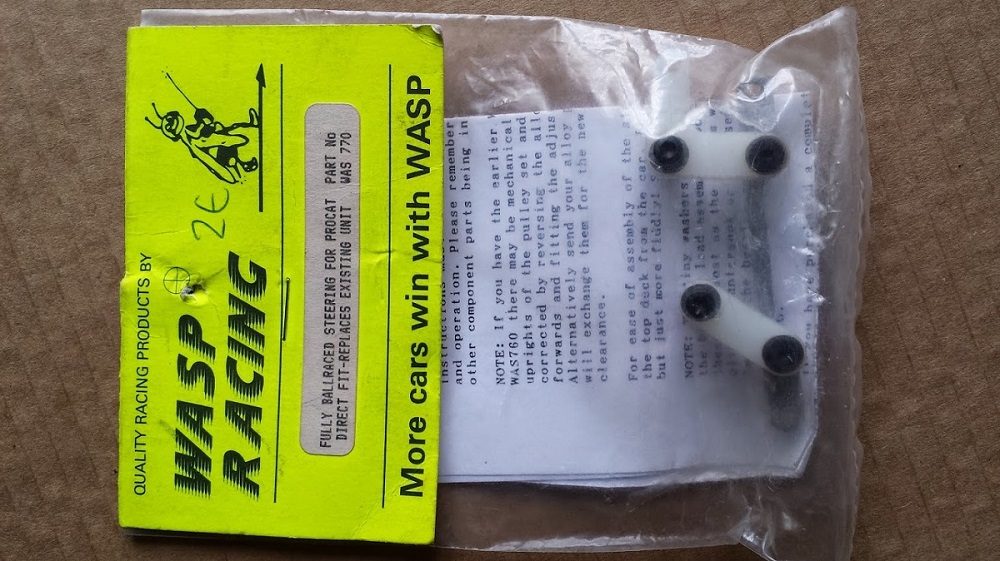

Here are two pictures of the wasp fully ballraced steering for reference:

Ooooh - I'd love to find a set of those steering bell cranks! 8)

LurkingCAT wrote:Developing into a very desirable car this one!
That would fit nicely to my Procat :wink: let me know when it comes up for sale

I spent some time & £ getting these...
Totally up to my taste as well using fiberglass on this build. Gives that special Schumacher engineering feel from back then - priceless!
If you can't get any good bell cranks, what about going Luke inspired in fiberglass? Fiberlite did his design in carbon, so either same design or design your own and get them done in thick fiberglass? At least that is what I'm up to when I'm going a similar route with a XLS later on.
