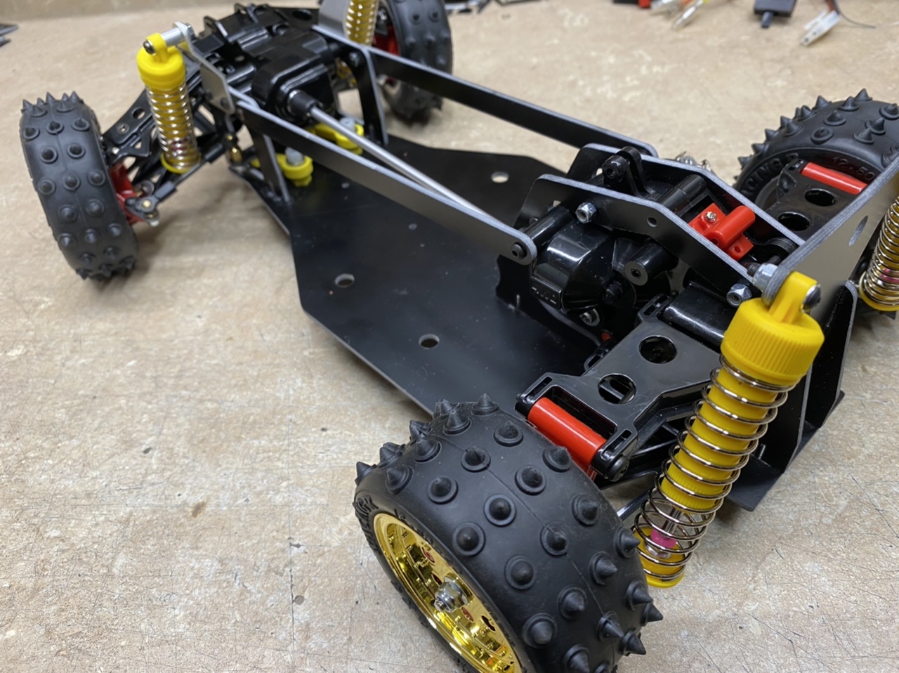

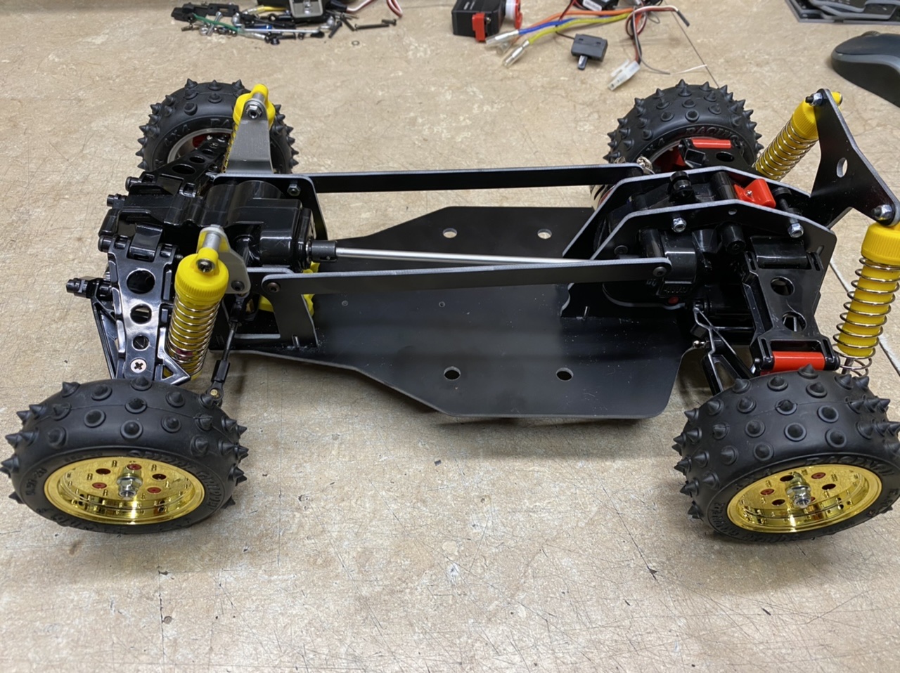

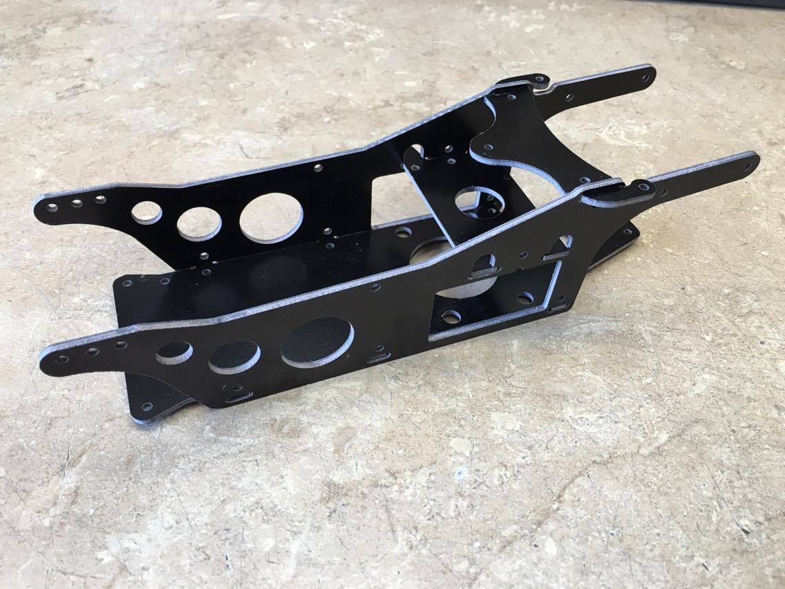

Just putting the final touches on the Boomerang chassis set. It is a LOT more work than the Hotshot was- all to fit the silly little drivers head and reuse stock body mount locations. Oh well, if it were easy, everyone would do it LOL!

What are you doing for steering. The gear and rack of the original were horrible.
Posts: 12336
Been thanked: 3919 times
Re: Hotting up a Hotshot
Associated bellcrank- just the one centered and bump steer is almost completely gone

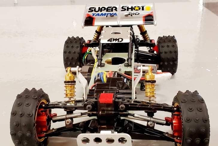

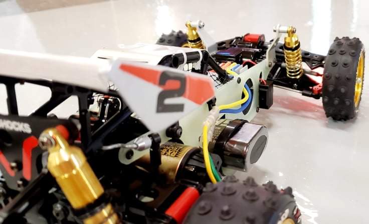

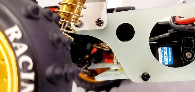

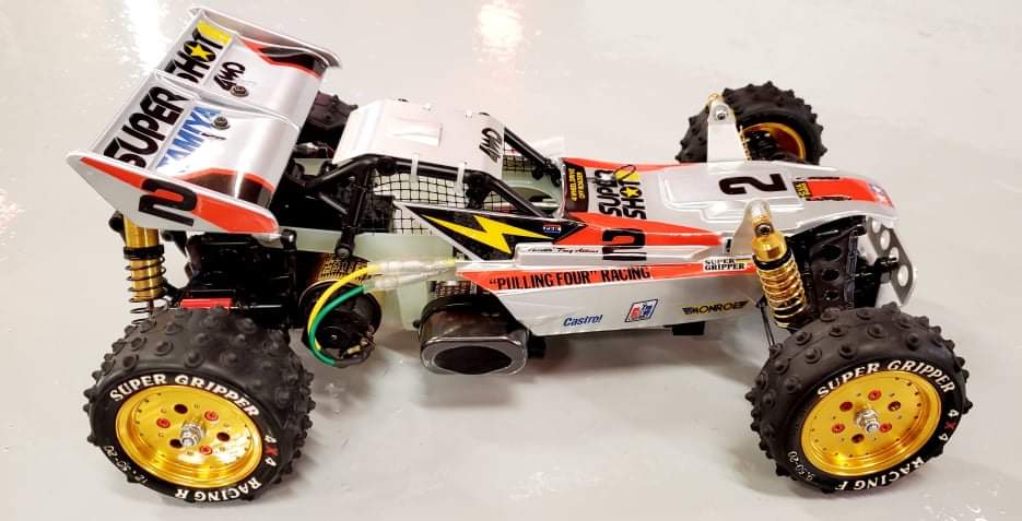

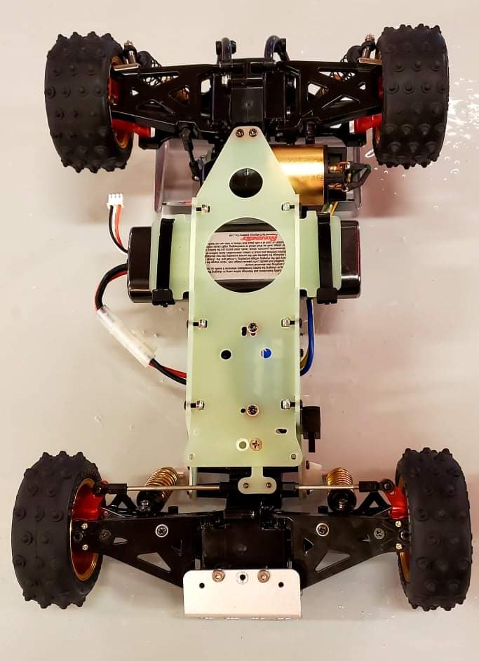

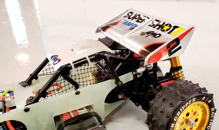

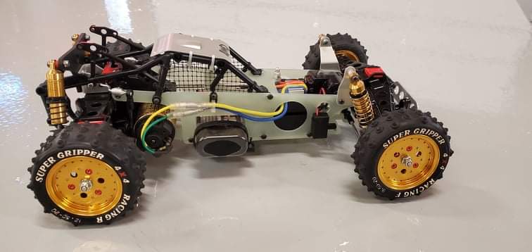

I have a new chassis design, this time on a Super Hotshot/Supershot. More of a Hot Trick theme this time, but not quite done yet. I want to be able to retain the iconic roll bar and I’ll add battery straps instead of the zip tie holes. Also need to tie the stock bumper into the chassis. Anyway, here are some sneak peeks.
This will not replace the regular Hotshot chassis, it will just be another version.
chevron

Factory Works latest Hotshot chassis
