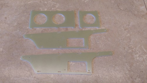

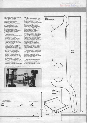

Started in on the hotshot. Not sure I'm good with the magazine version but I wanted to try it first
This is just the mock up so far

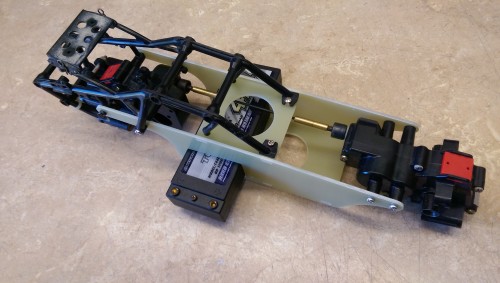

Enough of that....now its my turn ....
Lipo friendly and interlocking top and bottom chassis, front of cage bolts down and so far....everything lines up perfectly

supershot has some funky brackets that slide onto the arms and some bent metal towers. I found a manual and looked up the pieces, they dont look very tough. I have the CRP mono shock mounts and the CRP rear dual shock mounts that come off the roll cage that I have duplicated and will be using them. I plan to mod the front for duals also at some point

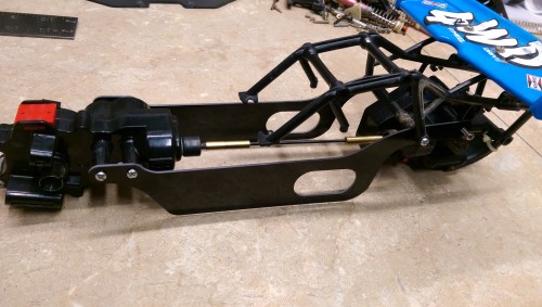

Re: Hotting up a Hotshot
Had to add a little more rigidity. Not shown, but the newest drawing adds small wings to the lower so you can strap the battery in. I have an associated bellcrank in it, and minimal bumpsteer (without shimming it yet)
