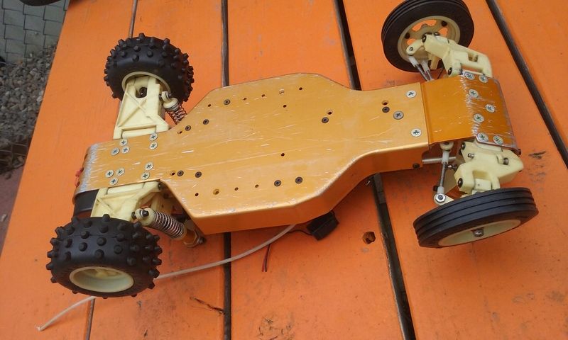

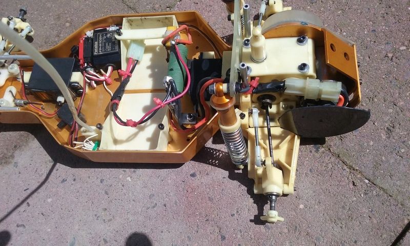

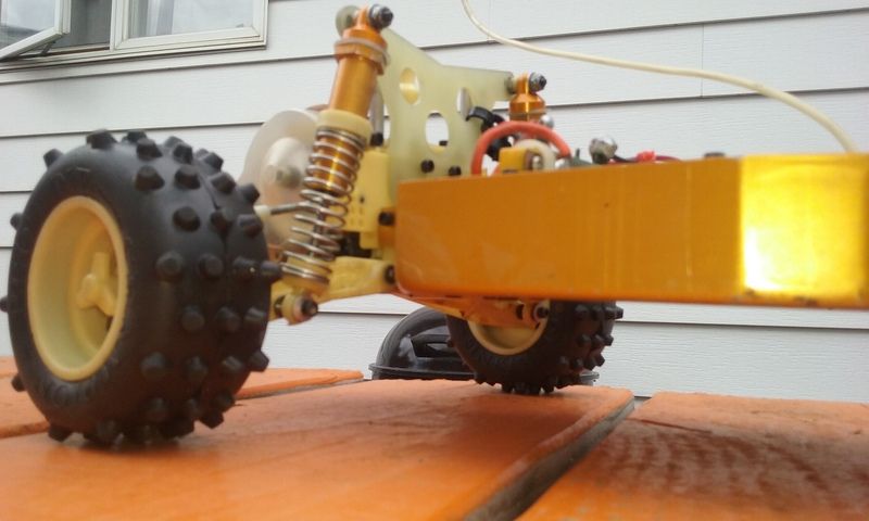

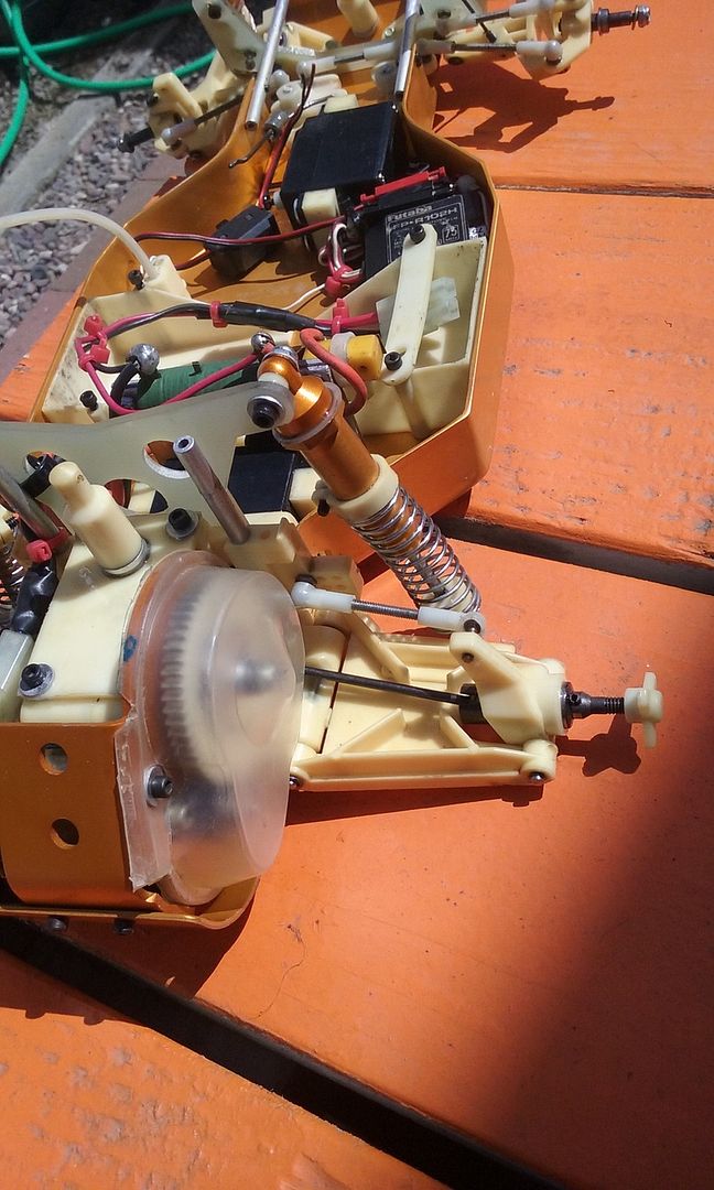

I was referring to the rear arm mounts. Pages 27 and 28:
https://www.teamassociated.com/pdf/cars ... manual.pdf
Looking from the sides, the rear arms should be pitched up facing the front. Having them on the wrong sides removes the anti-squat and will give it 0 degrees of toe-in (which you can see in your first pics). Basically it'll have little rear traction when accelerating, it'll probably be squirrelly in the straights and not corner that well.
I went through pages 27 and 28 and I guess I am missing something, as I can't tell what is incorrect.
This is how it is currently set up.
- Bottom Feeder
- Posts: 325
- Joined: Wed Nov 06, 2013 11:30 am
- Location: Virginia
- Has thanked: 13 times
- Been thanked: 25 times
Re: Getting an old abused car running again.
The rear arm mounts. The Classic manual malkes it a little clearer, page 10:
https://www.teamassociated.com/pdf/cars_and_trucks/RC10_Classic/RC10_Classic_Kit/manual_RC10Classic_2013.pdf
Part # 6360. They have left and right sides and you have them on the wrong sides. They seem identical with a quick look, but they are different and the rear end geometry is way off when installed incorrectly.

Ah, thank you. I'll swap them out.
