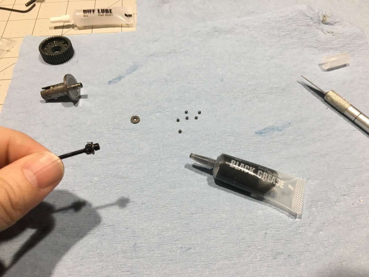

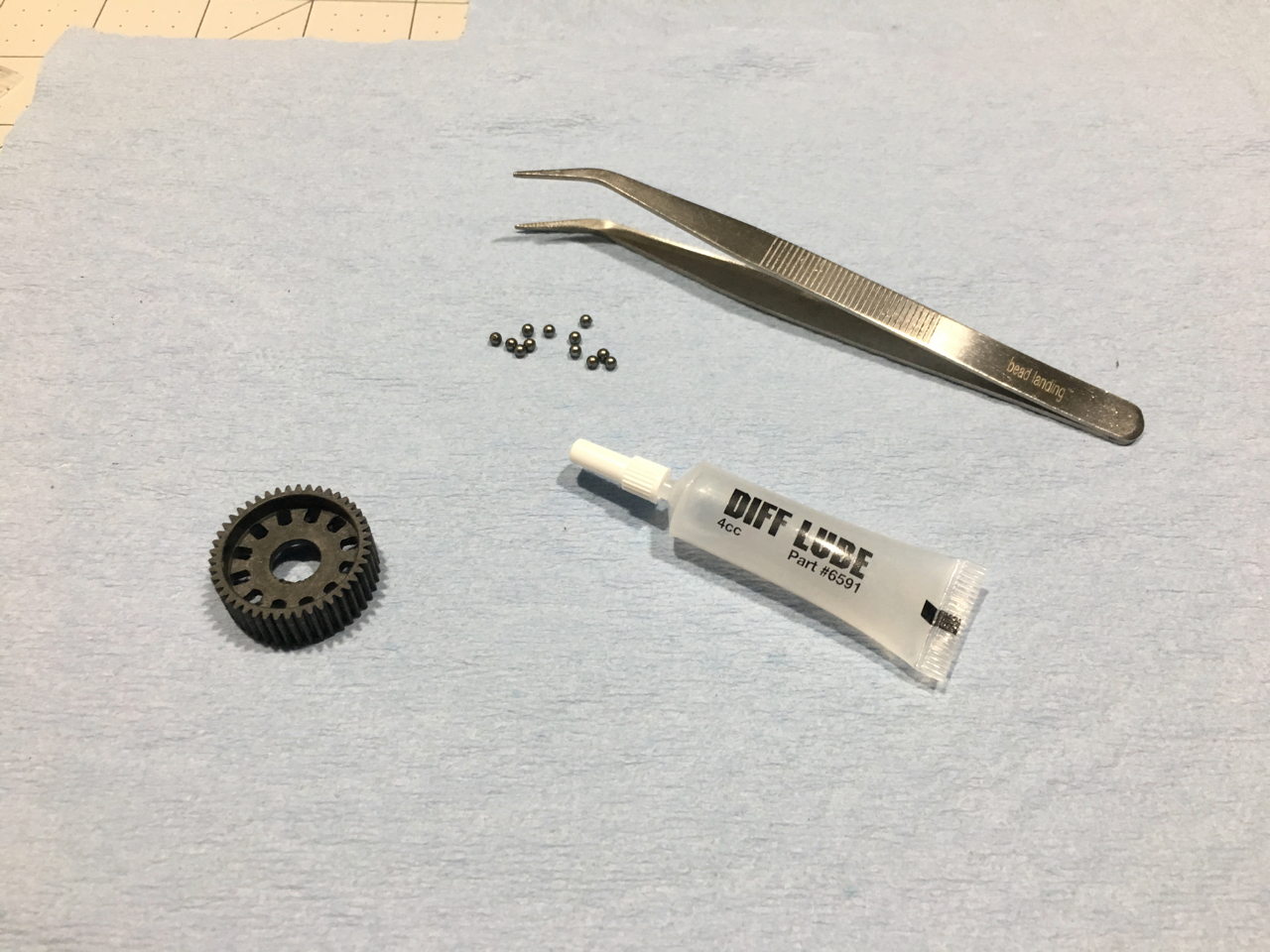

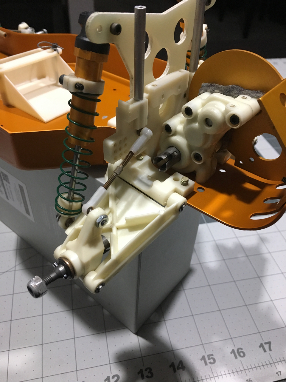

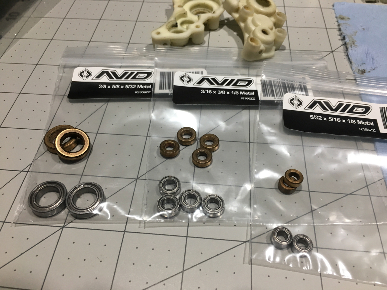

I got the bearings in and rebuilt the transmission.
That first picture just shows the original bushings and appropriately sized bearings if anyone needs the info.
I meant to take more pictures but would have needed a third hand. :-)
Everything is super smooth now.
I was able to reuse the felt gasket- it was intact in the area that it's protecting and should work for this time. I'll probably need a new one on the next rebuild or will just go without.

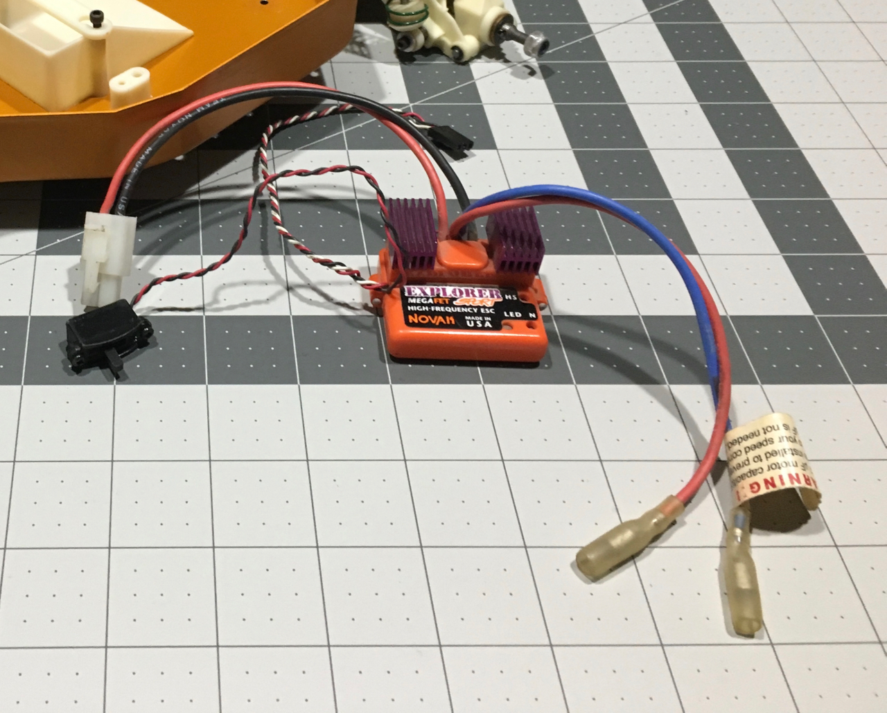

I also grabbed an older Novak Explorer Sport off eBay. I think it's from 1995 so it's roughly the right era for a mid CE.

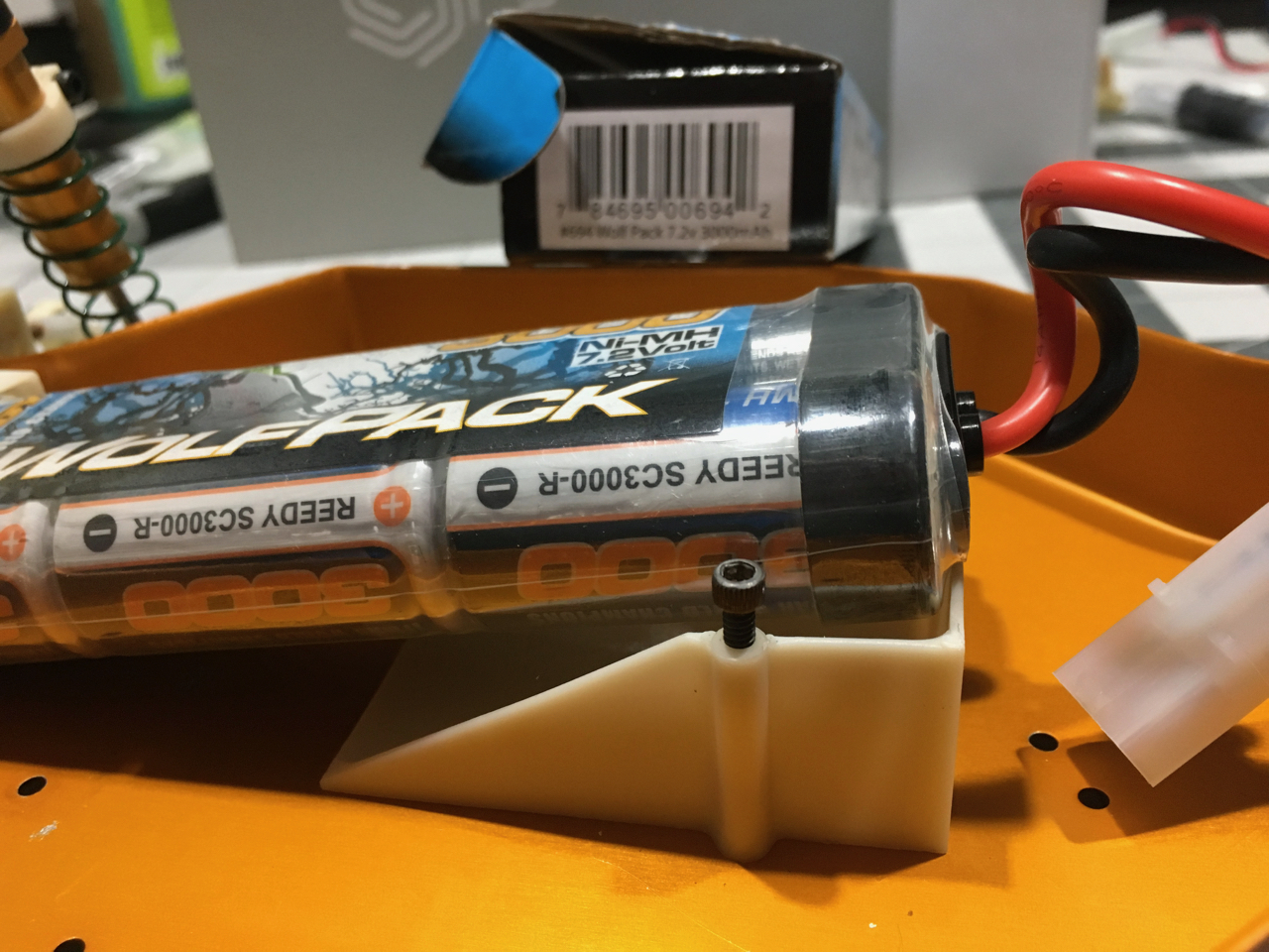

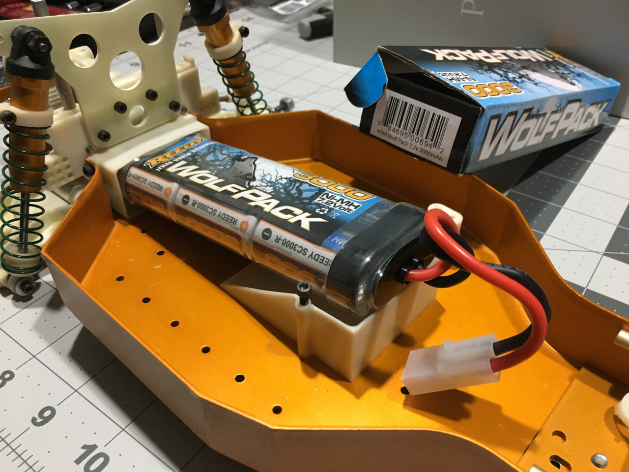

One other thing is that I also got a new Reedy Wolfpack NiMH battery (#694). It does not seem to fit in the battery tray properly.
It's slightly longer and I would have to really force it in there which would deform the front tray. The positive and negative leads come right out of that same end which makes it even worse. It's all the way up against the rear bulkhead in these pictures.
It looks like I could modify one of the battery trays to make it fit properly but I wouldn't have thought that was necessary. The original batteries would have been NiCad and I'm curious if the NiMH packs are just slightly larger?
bluewormx
Posts: 343
Joined: Wed Jun 08, 2016 4:56 am
Location: Spain
Has thanked: 41 times
Been thanked: 90 times
Re: RC10 CE Restoration
Post by bluewormx »
Great looking build.
As far as the battery pack goes an option is to remove the end caps. Then it will fit no problem, but then you have to be carefull not to short the battery out.
jeepnut24
Posts: 75
Joined: Sun Jul 01, 2018 7:02 pm
Location: Colorado
Has thanked: 7 times
Post by jeepnut24 »
I just got a new nimh pack and it was too long too. Not that long however. I was going to get another battery bracket and cut it to fit.
ChisaiKuso
Posts: 526
Location: United States
Has thanked: 5 times
Been thanked: 27 times
Post by ChisaiKuso »
emmARRpee wrote: Tue Jul 24, 2018 9:59 pm One other thing is that I also got a new Reedy Wolfpack NiMH battery (#694). It does not seem to fit in the battery tray properly.
Back in the day almost everyone hacked up the battery cups for this very reason. Unfortunately this means that nice, original battery cups have become rather difficult to find. The vintage collector in me will therefore plead this of you: "Please do not destroy your original battery cups."
Buy some rerelease battery cups to modify instead. Keep the originals in case you ever desire to restore your RC10 back to original form. The world will be a better place with one less destroyed vintage battery cup in it. :wink:
Another option would be to find something like an old school Pure-Tech battery strap.

radioactivity
Posts: 854
Location: Dripping Springs Tx
Has thanked: 383 times
Been thanked: 608 times
Post by radioactivity »
I have always used a high quality servo tape on my battery cups.
Clean both surfaces very well and use a full coverage on the tape. 3m VHB is supposed to be the best.
Others may not trust it but I do. No holes and no modifications.
Chuck
jwscab
Posts: 6571
Location: Chalfont, PA
Been thanked: 498 times
Post by jwscab »
I would say to also use the VHB tape and move the battery cup forward.
Yes, the NiMh are generally longer. Even then, the 6 cell NiCd would sometimes be tough to fit.
emmARRpee
Posts: 27
Joined: Thu Jul 12, 2018 1:56 pm
Location: Milwaukee, WI, USA
Post by emmARRpee »
Thanks for all the info.
I am going to keep the battery cups original and will use one of the methods described.

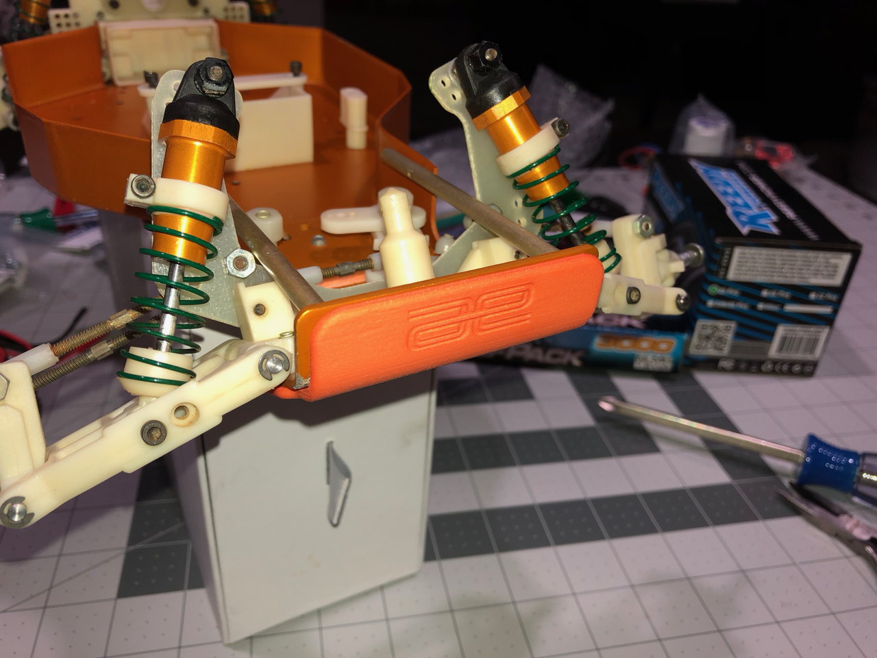

My bumper arrived from shapeways:
NomadRacer
Posts: 1467
Has thanked: 81 times
Been thanked: 79 times
Post by NomadRacer »
Nice! I have a couple of those in black.

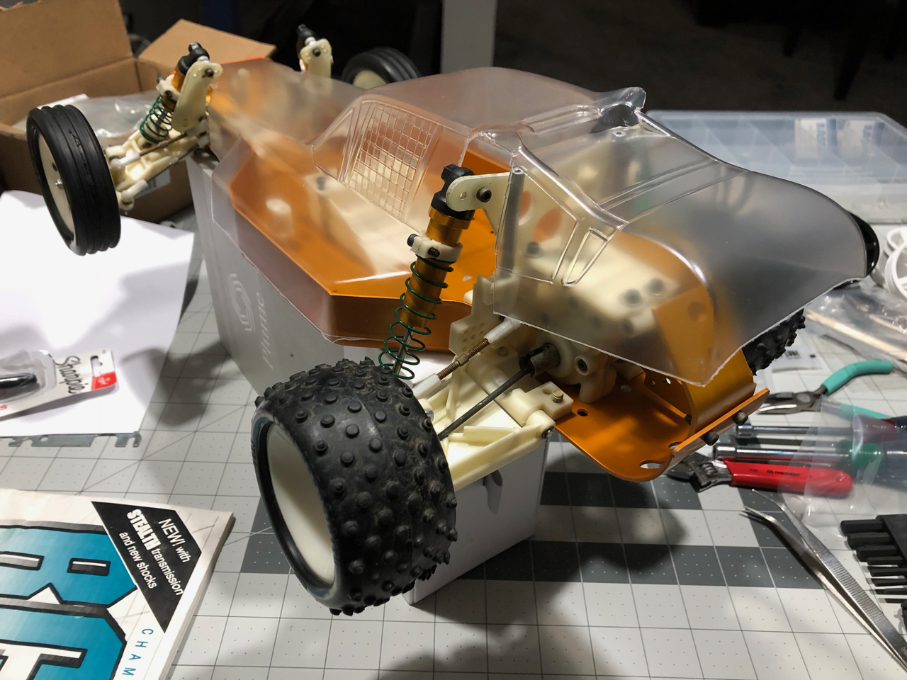

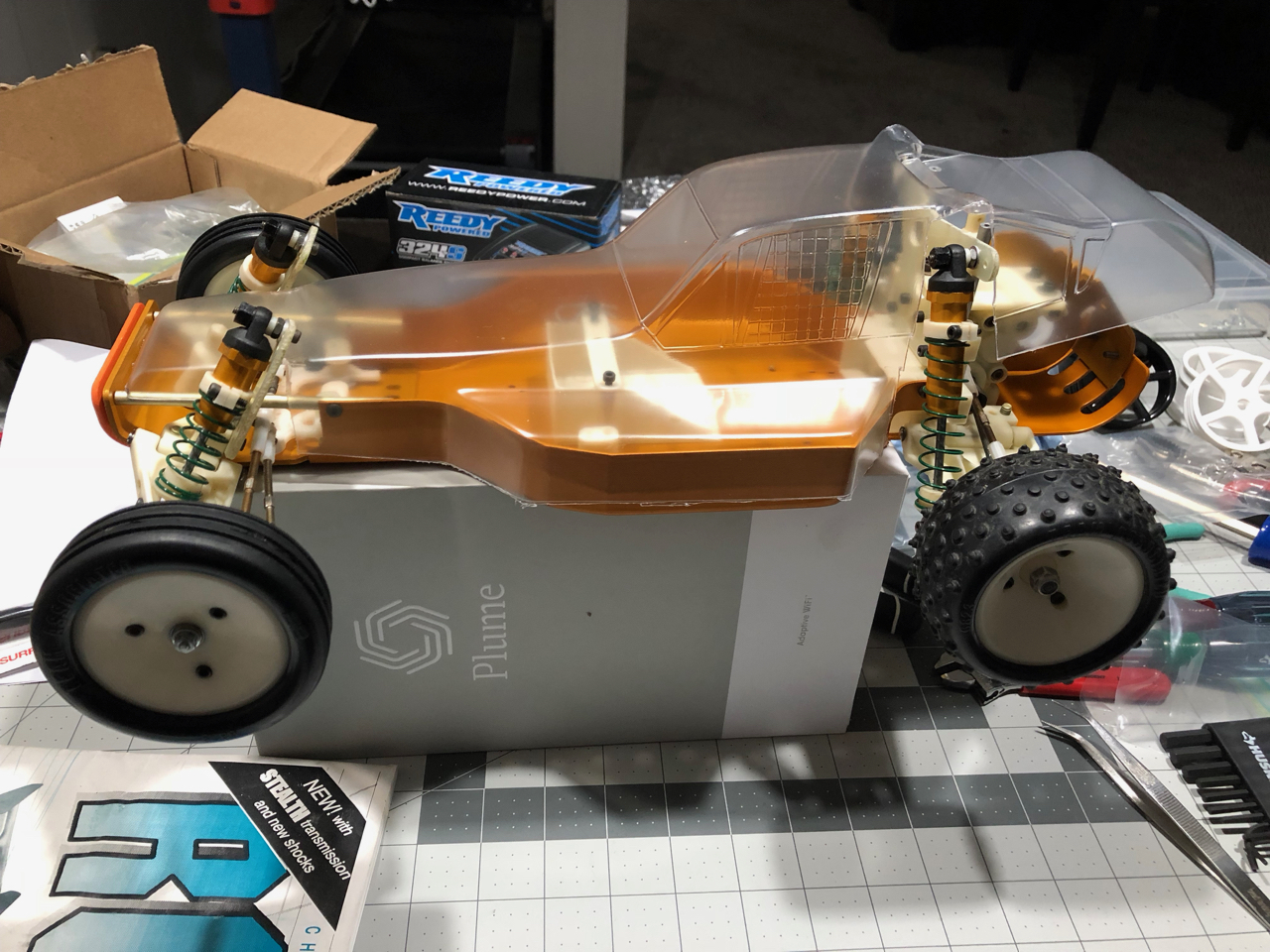

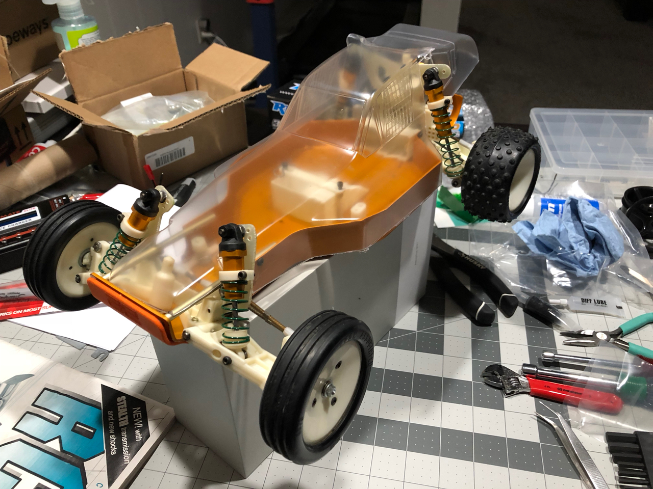

Made some more progress- this is my first time trimming a body and I used a hobby knife and limited patience. :-)
I am going to grab a Dremel and clean it up more before painting.
XLR8
Posts: 3307
Has thanked: 1659 times
Been thanked: 1170 times
Post by XLR8 »
Looking good. Best advice I can give you is to clean up the edges, paint it, apply decals and it will look great. I've always obsessed far too much over an imperfect trim only to find that I really didn't notice the imperfections after the body was finished.
I'm probably confused (again) but I thought you were going with a Viper body.
