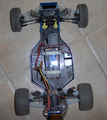

I received my LiPo battery tonight. Venom 7.4 40c 2S 5000 mAh
Most Rc-10s I see with LiPos use a battery brace length wise. Would you guys recommend this? I
was looking at adapting a RC-10B4 battery brace.

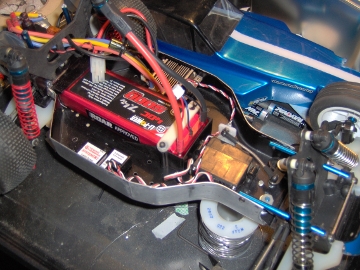

So now to my actual question, will the A&L Chassis stiffener work with the factory battery cups? I have a shorty LiPo and need to run 2 battery cups. See above picture.
I will be buying the A&L aluminium wing mounts, so I figured if the stiffeners would work, I might get those at the same time.

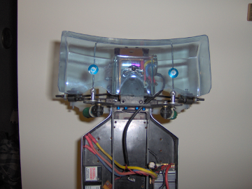

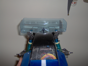

The B4 wing mounts destroyed my shock tower, so I came up with a new way to mount the wing using A&L wing mounts and a SC10 body mount.
I hope this is my last wing mount method.

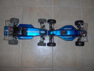

Comparison between B4 and RC-10 width.
Please note the below picture was taken before installing bigjeepzz rear arms.
