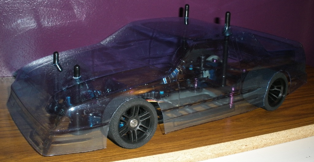

I decided to go with this body, downforce won't be as good as the usual pan cars you see, but still should be pretty good...and once I've painted it up like a Buick Grand National, it'll probably be the most bad-ass-looking car on the track. :twisted:

It is indeed. :) So, thank you too! :) It'll take some work to make it *not* look like a 'Carlo, but I have some plans up my sleeve. 8) Oh and by the way, the body fits this RC12L3 chassis & wheels almost perfectly! Tires nice and almost flush with the wheel-wells.
