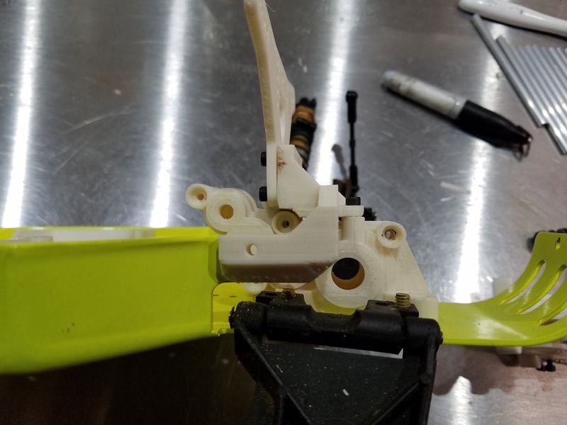

I managed to get the bulkhead and trans case models modified back to where they were and print and test fit them. I also made a slight change to the shock tower to improve how it fits. There's one or two minor changes I want to make to the trans case, and I need to redesign the motor plate because it's one of the files that got lost, then I think I'm ready to have Shapeways make the trans case and bulkhead and Jeff and durb69 make the real tower and motor plate... I could be driving this thing in 2-3 weeks if all goes well!

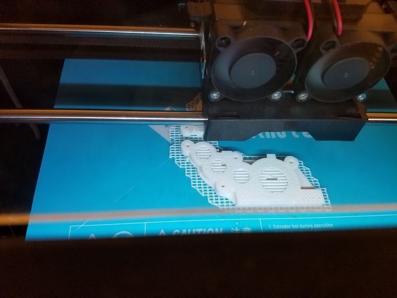

Printing the trans case
Test fitting the trans case, bulkhead, and shock tower

I'm using a FlashForge Creator Pro, 0.2mm layers in ABS.

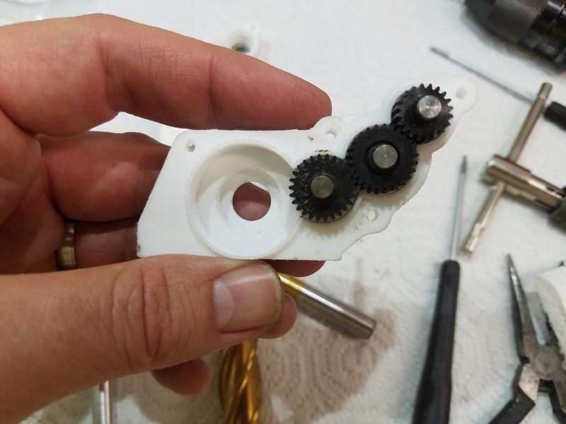

I got the trans case and bulkhead from Shapeways and started assembling the trans case. I carefully reamed and tapped all the holes, reamed the bearing bores, and started putting in gears, from the input shaft working toward the diff. Went to pit the diff in and saw this:
Uhhh, Oops! Somehow the idler nearest the diff ended up too close to the diff! You can see in the pic how far it's sticking into the recess for the diff gear. I thought I had the CAD model set up so that couldn't happen... guess not!!!
So some relatively minor tweaking of the trans case model and I should be back on track.
