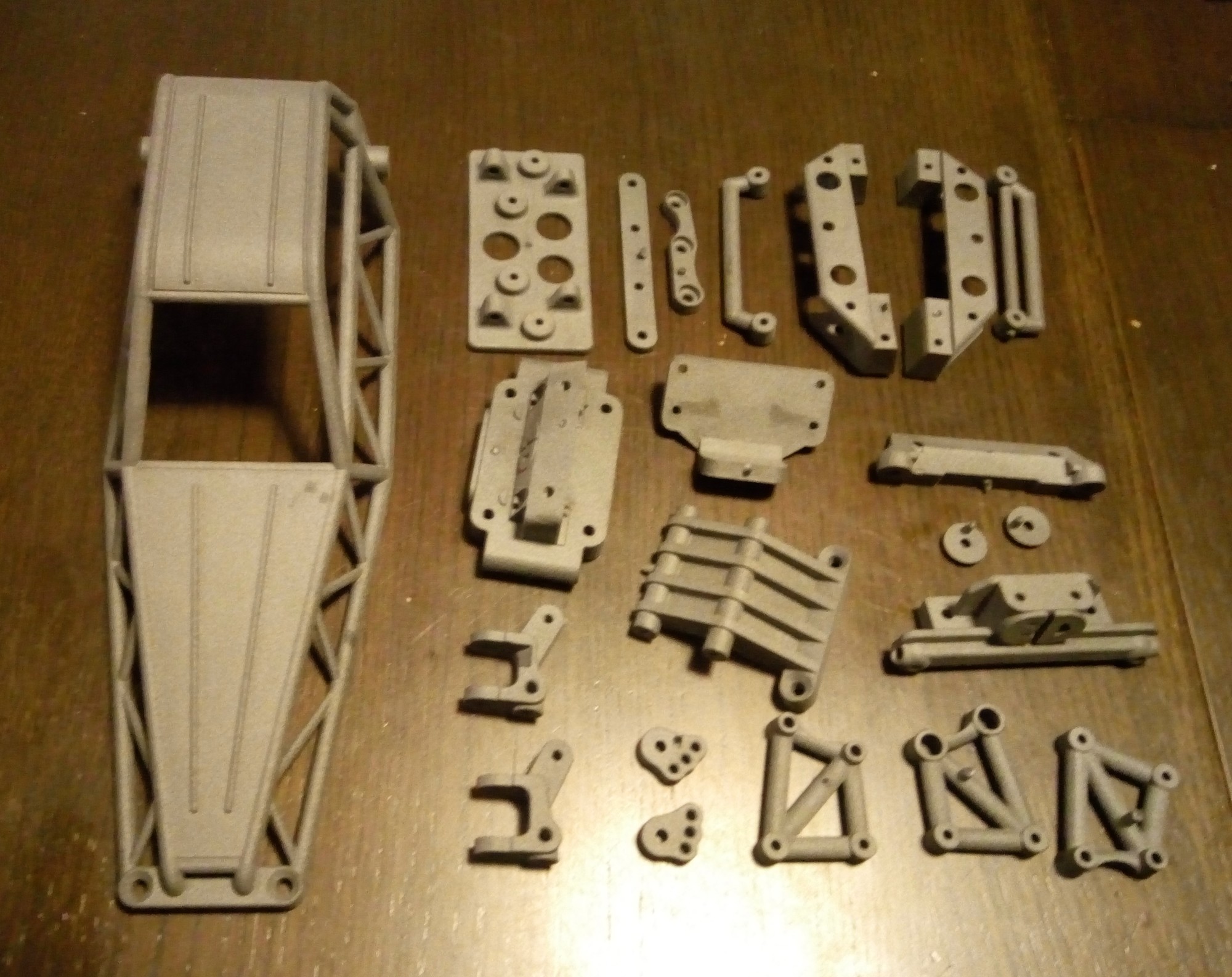

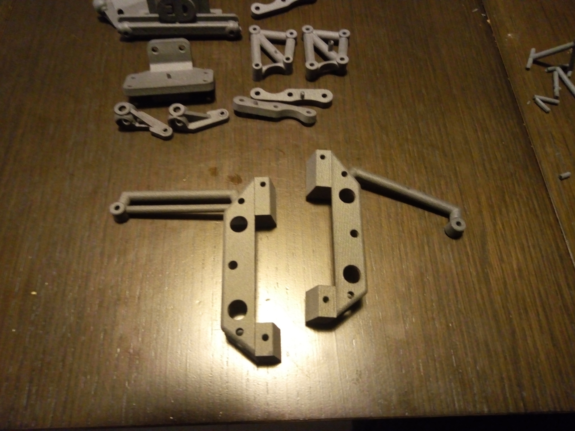

Re: Ultima 2019
The first prototype print of the shorty holders came in yesterday.
I didn't have time to mount it yet, but you get the idea.
Top of pic is the frontside of the car. The hinge and retainer bolts go in from the bottom. That way you can unlock the retainer without that bolt falling out. Plus, it keeps the top nice and clean of bolt heads. And this is the full kit:

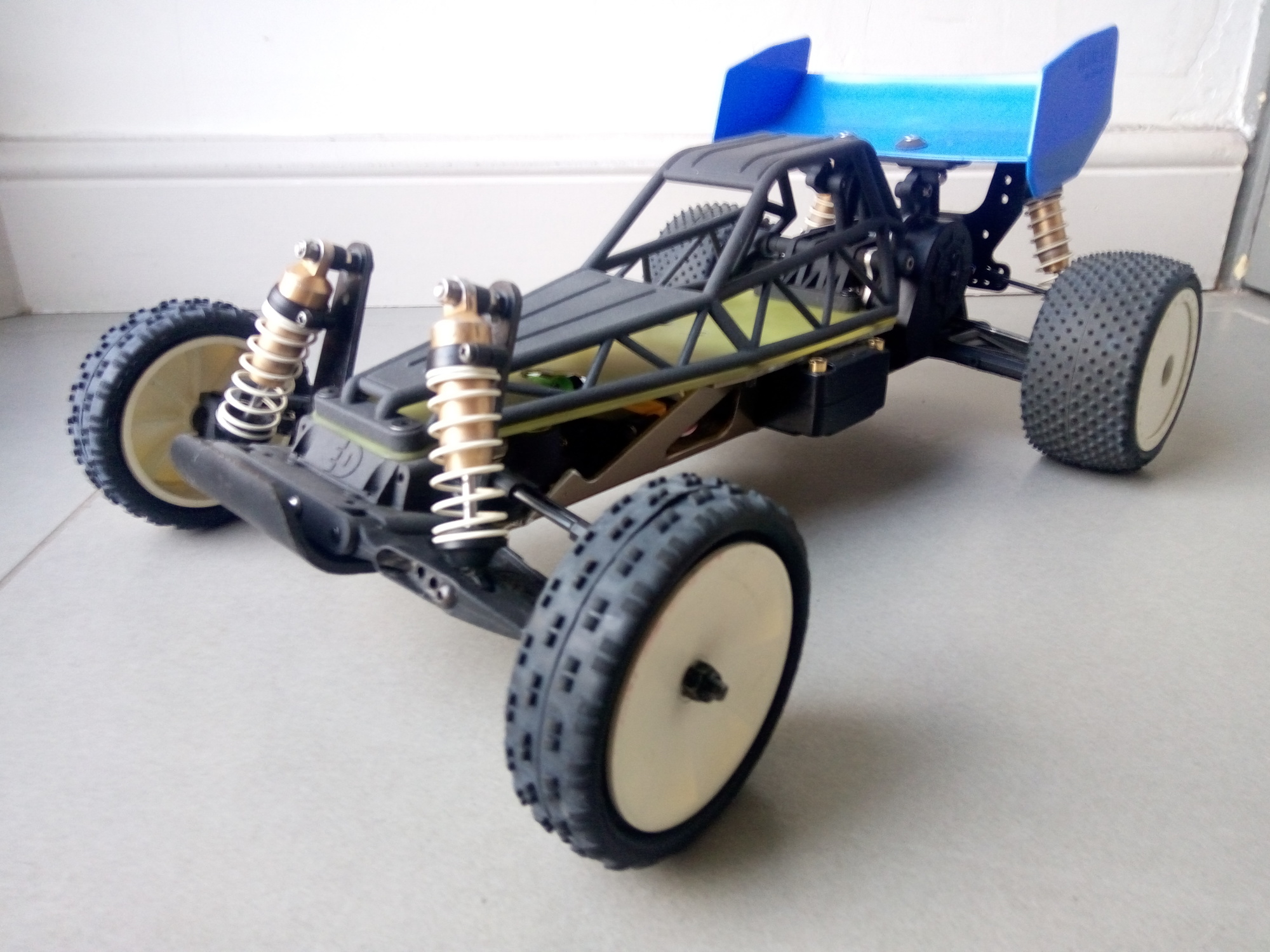

Re: Ultima 2019
Here it is as I ran it at the vintage euro masters this weekend:
and here it is on the turbo ultima chassis with the printed cage body, but before the batteryholders arrived:
