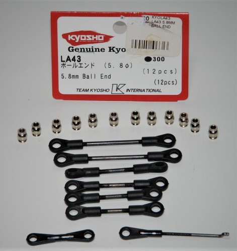

At any rate, new tie rod ends. Ordered a week ago
And I had some stainless 5.8mm rod end balls so they will be used.

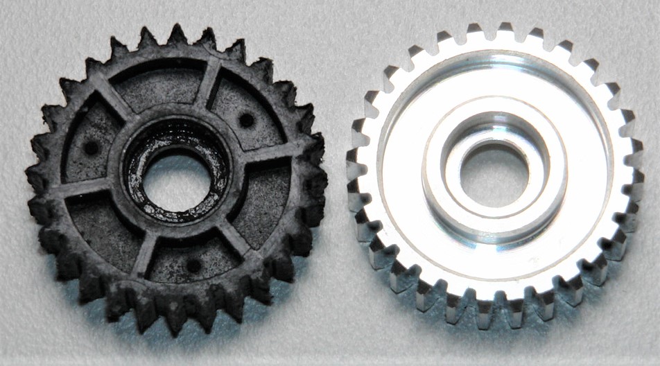

Put together the front diff with new gears. The gear set was actually cheap, so why not replace.
Cleaned and lubed the bearings first.
Then shimmed the side gears till there was little play with the pinions. Next adjusted the end play of the side gears to a minimum .
Then spun the heck out of one of the side gears with a Dremel while holding the other side gear in place. Reversed the process for the other side.
That seated the diff gears pretty good and almost made the action smooth. Cleaned , re-greased, re-oiled, installed the belt and screwed it together.

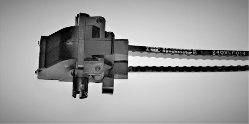

A small victory but one thing that always bothered me was a car running around sounding like a bucket of loose bolts.
The belt appears to be in fairly good shape and from what I understand is the better of the 2 belts that were available.

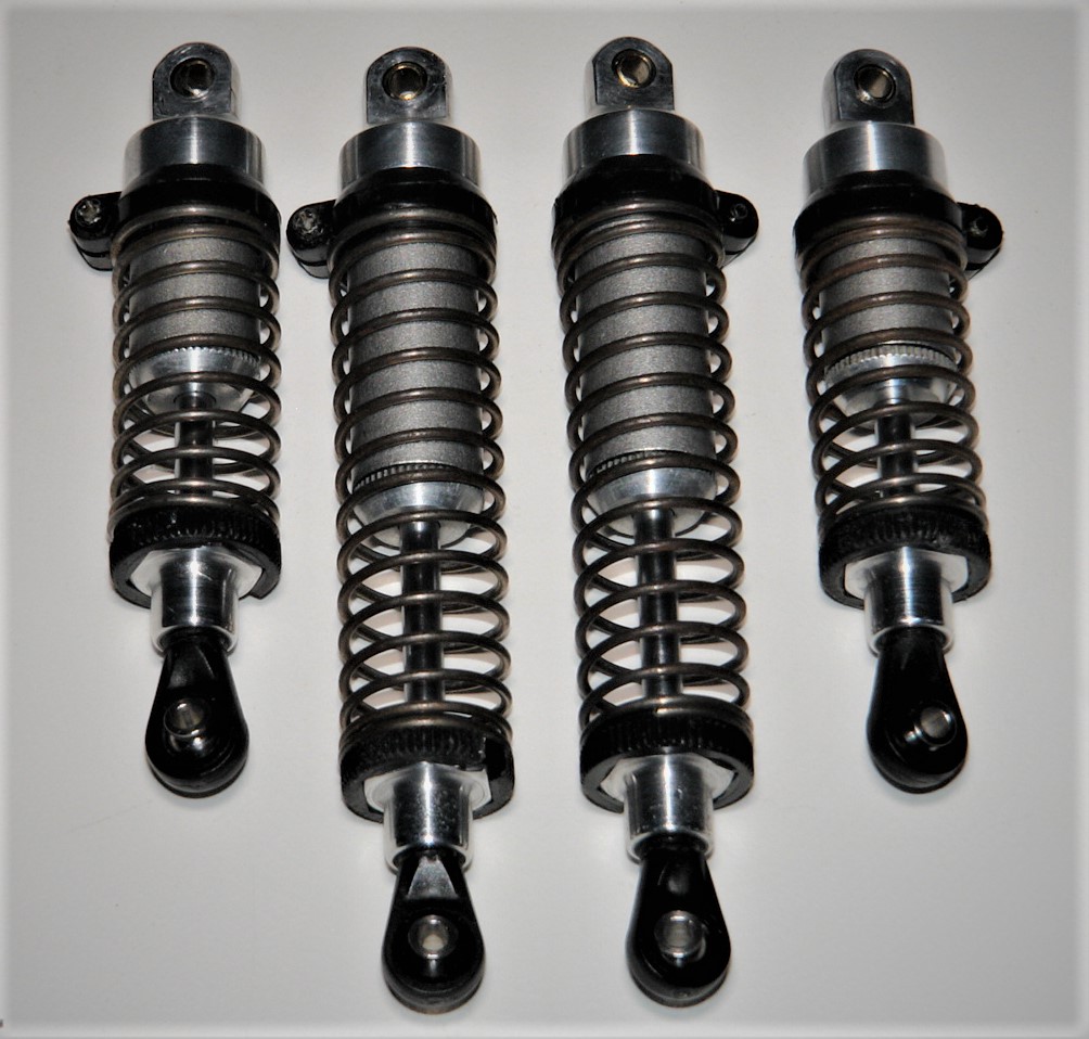

Made a set of lower shock mounts that worked much better than the first attempt.
Haven't filled them with oil yet because one rear has a bad bladder. But they are very smooth.
Will they leak, I dunno.
Do they look good, I think not to bad considering the shape I got them in.
Curious about which springs they are. Wire diameter is about 1.17mm or 0.046". Look like maybe black mediums but could be a crusty silver.

Shocks look great Chuck. Those are best shocks ever made period. I know u disagree but its a fact. Hopefully the tiny orings on the inner shaft aren't hardened. If they are, they might leak out the bottom adjustment piece. Optima mids are really impressive cars. Will handle with anything ever built, even today's cars. Glad u expanded your excellent work abilities beyond just rc10s (so boring). U do the finest restorations. Please go box art with this, i am begging you! I am so jealous as a turbo mid se resto was next on our list before these damn heath issues shut down me and dereks extra spending. We even had the body and decals. Do u wish u raced one back in the day?
