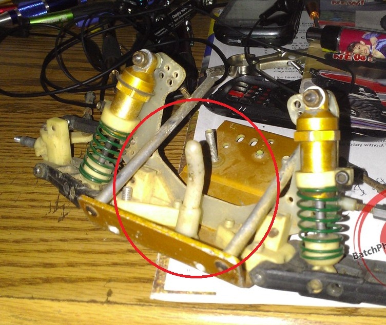

FYI. I voted for the 6 gear, but can I also vote for you to re-use the front body mount..?
Re: Finally... Dave145's Gold Pan Runner Build
I meant to ask about that. Where did it come from? Is that some RC10T mount or some custom made piece? I've never seen one before.

I'm going to have to defer to a couple other folks on this here board that will have all they can do not to chime in with answers on this...Dave145 wrote:I meant to ask about that. Where did it come from? Is that some RC10T mount or some custom made piece? I've never seen one before.
Yeah I'll see if I can straighten it out for reuse on my runner.
It's a pan car mount.
For the wheels you can also go for CRP axles instead of the bearing adapters.
http://www.ebay.com/sch/i.html?_nkw=rc10+tamiya+axles&_sacat=2562&_odkw=rc10&_ipg=200&_sop=10&_osacat=2562&_trkparms=65%253A10%257C66%253A2%257C39%253A1&LH_PrefLoc=2
To be clear the PN 1552 is what you'll need for the wheels you have. The 1557 may cause handling problems and you've got enough of those already.

those stub axles look like they might actually fit so I'll look into getting a pair of them. Anybody have any thoughts on the B2 steering parts being used on my goldpan? I like the idea of the servo saver with my *ahem* driving style...
B2 steering...you don't necessarily have to mod it for the bearing.
http://www.rc10talk.com/viewtopic.php?f=38&t=8782
Another cheap option are the Traxxas bellcranks.
http://www.rc10talk.com/viewtopic.php?f=35&t=14211&hilit=junkyard+dog&start=15
