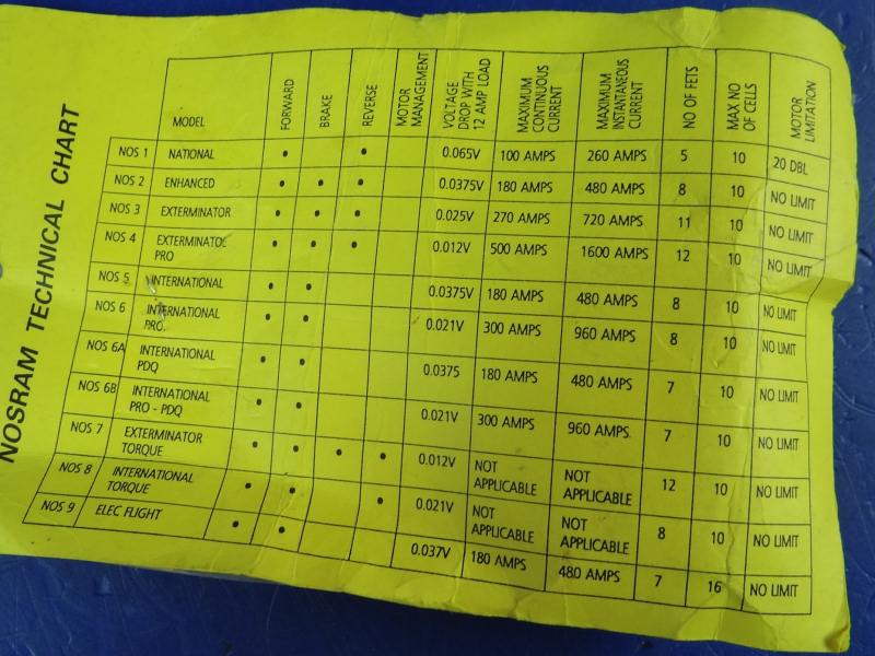

to be honest, i don't really know what it is. guess we'll find out in a few days.

Re: Rory Cull Rc10 Replica / '91 Euros
It's a 5v DPDT relay. Fairly common in UK ESCs from the 70s right through to the 90s as it's a simple and cheap way of switching into reverse instead of having 4 sets of FETs that are used today.gomachv wrote:Is that a wot relay? If so....that's fairly unique!
Some very early ESCs, such as the Demon 2 Turbo from 1979, used a relay to switch at full throttle, mainly because it used a single transistor for speed control and the relay had a lower resistance than the transistor. This only lasted until they started using multiple transistors and eventually FETs meaning they now had a lower resistance than a relay.
so, this is most likely a reverse esc then? i was kinda worried about that when i first saw it, but din't want to miss it either. it's not like there's tons of info out there about old nosram stuff to refer to.
looks like a few of their esc's were reverse going by the back of the package.
I just figured it was a high speed relay cause why would scr8p have a reversing speed control
I guess now we know

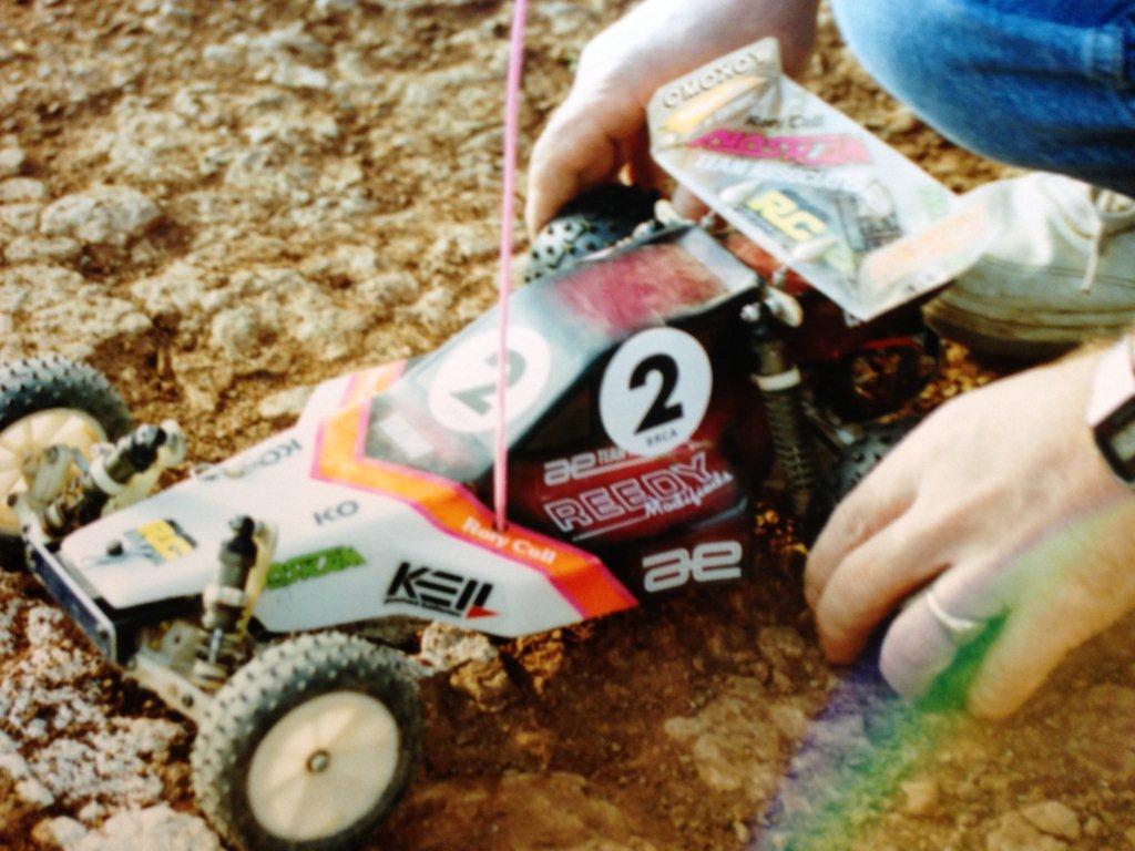

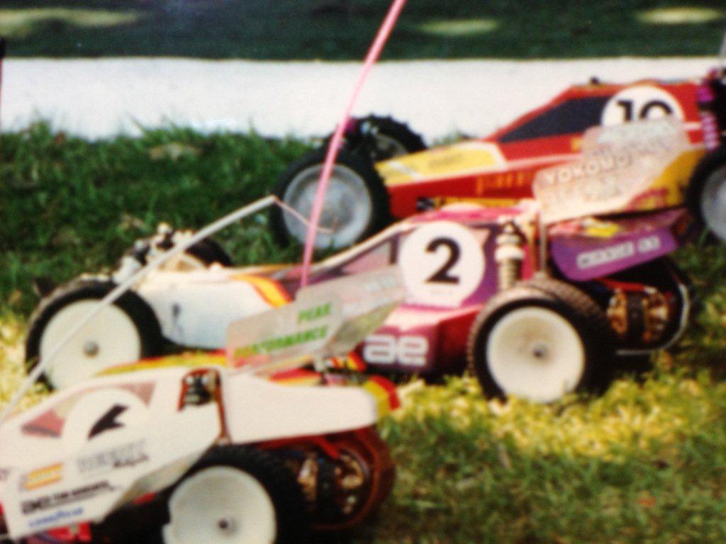

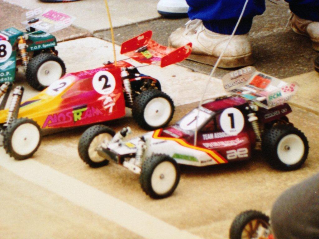

Hi Jason,
I have attached a number of pictures of Rory's RC10 frm the 1991/92 season with the shell you are hoping to recreate.
I hope they help,
Luke
I hope they help,
Luke
The bottom picture is;
10, Rory Cull
2, Steenari
7, Jamie Booth
1, Steve West
8, Phil Davies
9, ?
4 is a Furutani shell but don't think he was at the meeting. This is a heat from the 1992 EFRA British GP at Southport.
10, Rory Cull
2, Steenari
7, Jamie Booth
1, Steve West
8, Phil Davies
9, ?

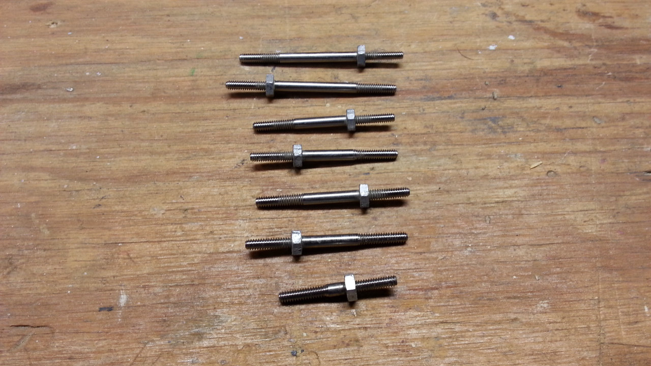

no big update (go figure
), but i got a set of rcps turnbuckles for this from mike. gotta give them a little cleaning up, but i'll get to them sooner than later. these were really the only thing keeping the car from being a roller. well, more than a roller actually. i should have everything to finish the car except the correct receiver, a body, and misc. stickers.

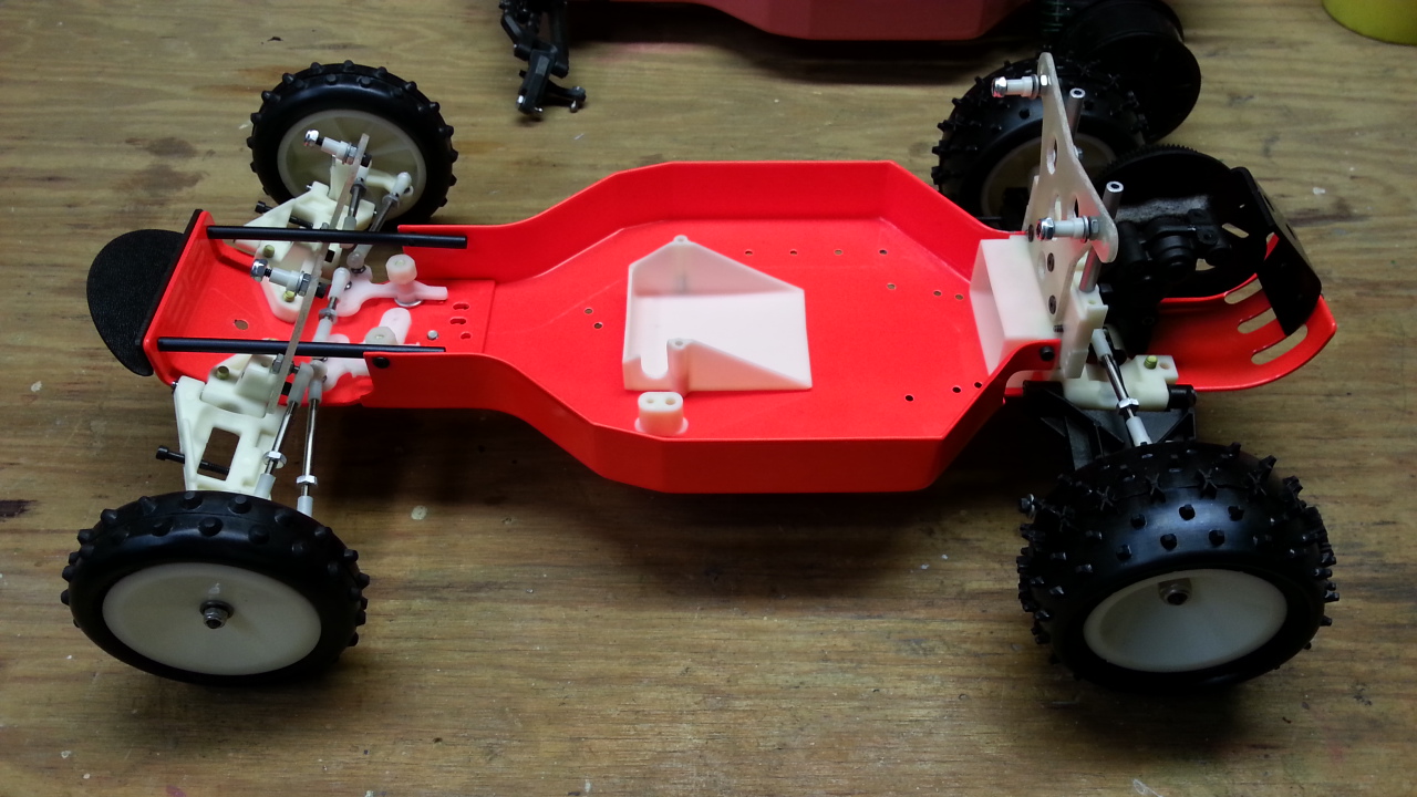

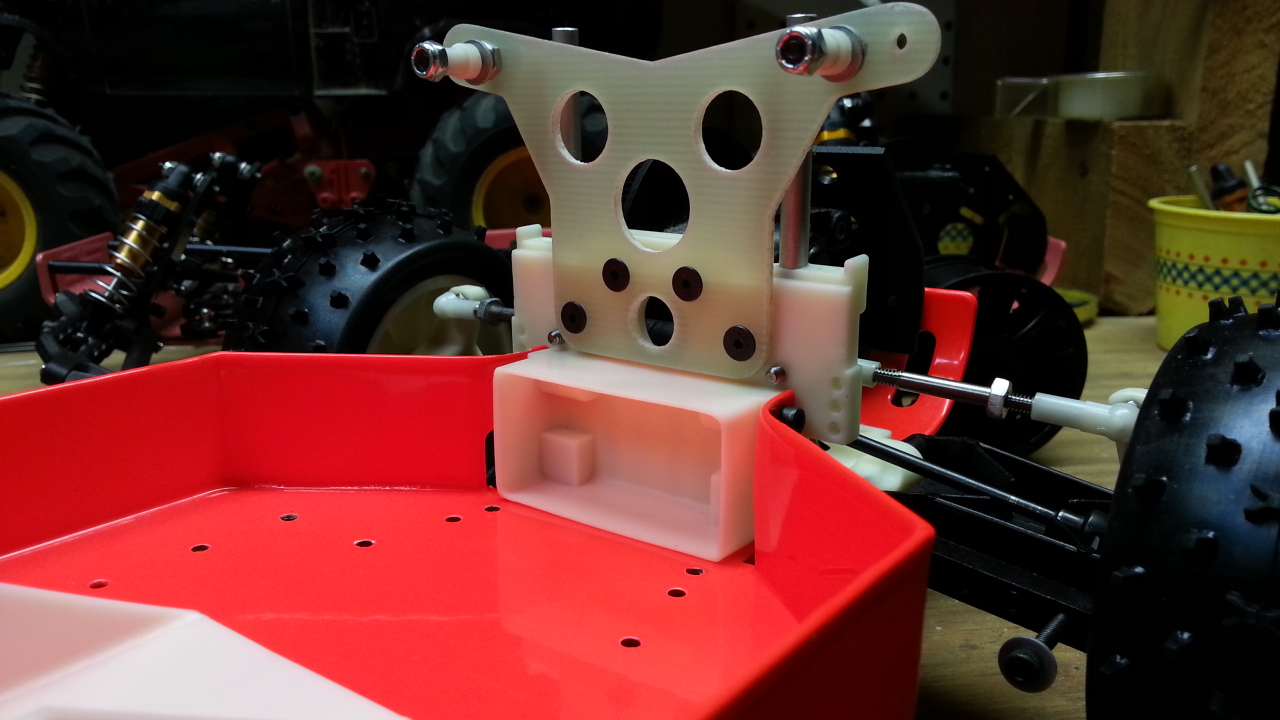

Messed around with this here and there over the last few days. Nothing major. Assembled and installed the tie rods and steering bellcrank. I can't find any evidence that rory used anything but the stock setup from the pics I have seen of his other cars. So I figured I should just use it in this car as well. I modified the battery box like ones on his other cars, and installed the jg a-main bumper, too.
I also pulled the rear bulkhead back out the tub to slim the sides down. I took it down to worlds width. I didnt want to go too far and regret it if better pics show up somewhere down the road. I know I'm close, I may just have to remove that last row of holes. I also countersunk the mounting holes on the tower in preparation for the esc.
I still have to rebuild the shocks. I keep forgetting to pick up some rebuild kits. Also unsure about a trans brace, whether it should be carbon or nylon. I guess I could get the esc rewired and get the electronics installed too. Still have to come up with a receiver, but I have everything else. Oh, and make a battery hold down. Not sure if its carbon or fiberglass though....
