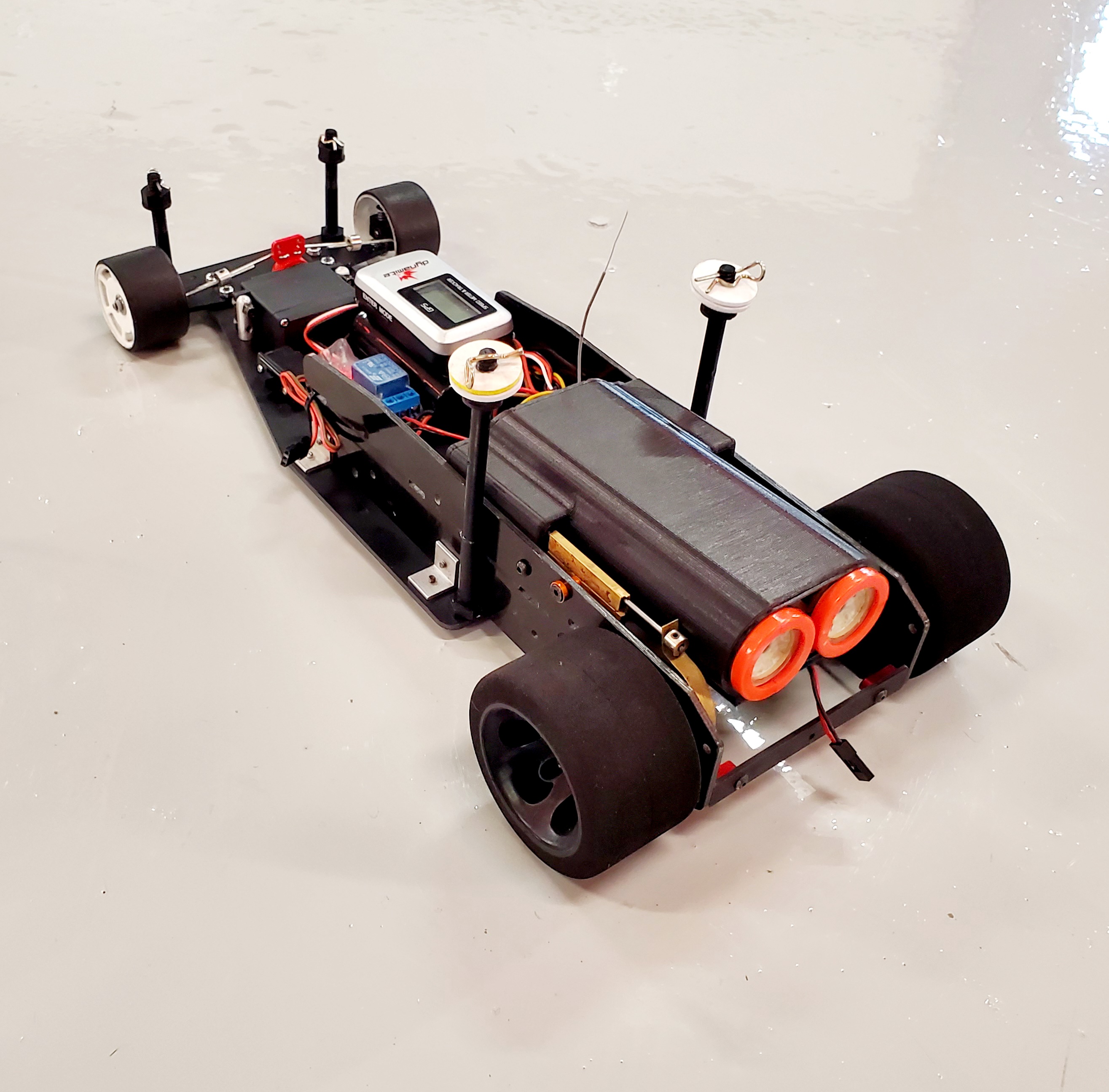

Got the dual engine mount back in with dual "E" engines in it...7.5lbs of thrust each....2.5 sec burn....hoping for 100mph with these...two more "F" engines ordered for next week....hoping for 130mph from those....also put different front wheels on that shouldn't blow out....weighs 2.4lbs like this with body

coxbros1 wrote: Fri Apr 28, 2023 5:09 pm Got the dual engine mount back in with dual "E" engines in it...7.5lbs of thrust each....2.5 sec burn....hoping for 100mph with these...two more "F" engines ordered for next week....hoping for 130mph from those....also put different front wheels on that shouldn't blow out....weighs 2.4lbs like this with body
A thought occurred to me. for the Dual setup you might want to do an over under setup instead of side by side that way if the timing is off it won't steer the car to the side.

Best I can tell the timing of the engined is spot on...plus the consistency of Estes products!..made two runs...both ran exactly 72 mph...we will know for sure tho in the morning...also, I plan on putting the single mount on top of the duals..getting a much more streamline body.....going to go 3 engines eventually...130mph in 2.4 seconds....want to be the fastest in the world 🌎 at 132ft...even tho they wont let me compete with it

Had an igniter come apart....unless this old school train shop sells engine igniters, done till next week😔

Got some rockets from Hobby Lobby. Tested it twice. Video on rc10talk fb group. Thumbs will get it on here later. It crashed bad. Dual engines doesnt want to go strait at all so far. Dereks repairing it now. Will test again in morning.
